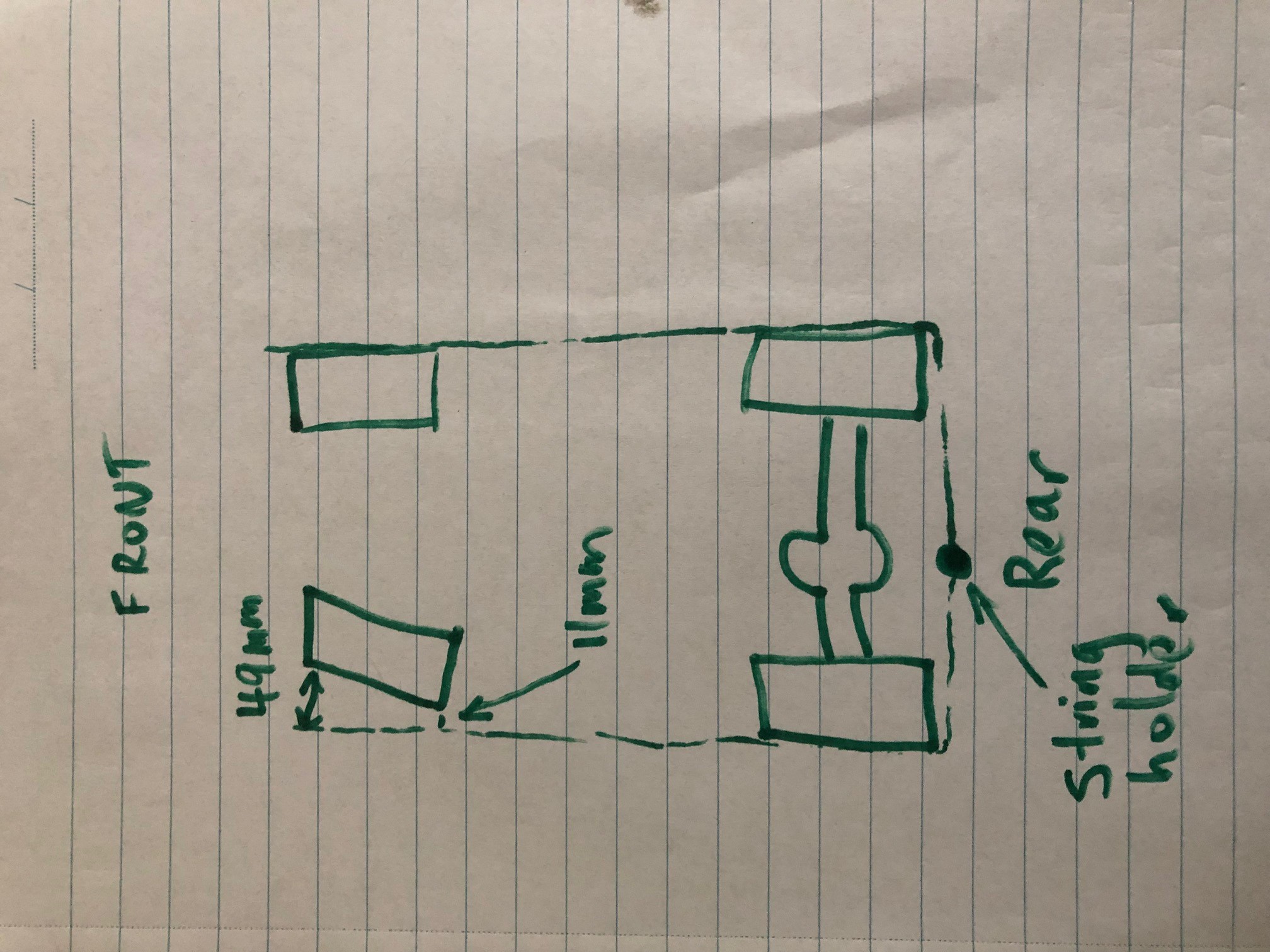

To get a feel for it, I put the front of the car up on stands. I took a string line and ran two strings, one down each side of the car. The strings were placed about midway up the rear wheels, and parallel to the rear tyres (just touching the tyre at the front and rear of the rear wheel). Started out with the pitman arm at 90 degrees (made a cardboard template to check pitman to connecting rod angle). The measurements looked way wrong. Potential there that Dad has installed the pitman arm off a few splines, and not so easy given that the new disk brake front may have different track to the banjo read.
Turned the wheels slightly, and got the result below:
- toe-in.jpg (547.79 KiB) Viewed 5455 times
Drivers front wheel dead ahead and aligned pretty close to rear wheel track. Passengers front wheel turned heavily to the left. Track appears to be skewed slightly to drivers side.

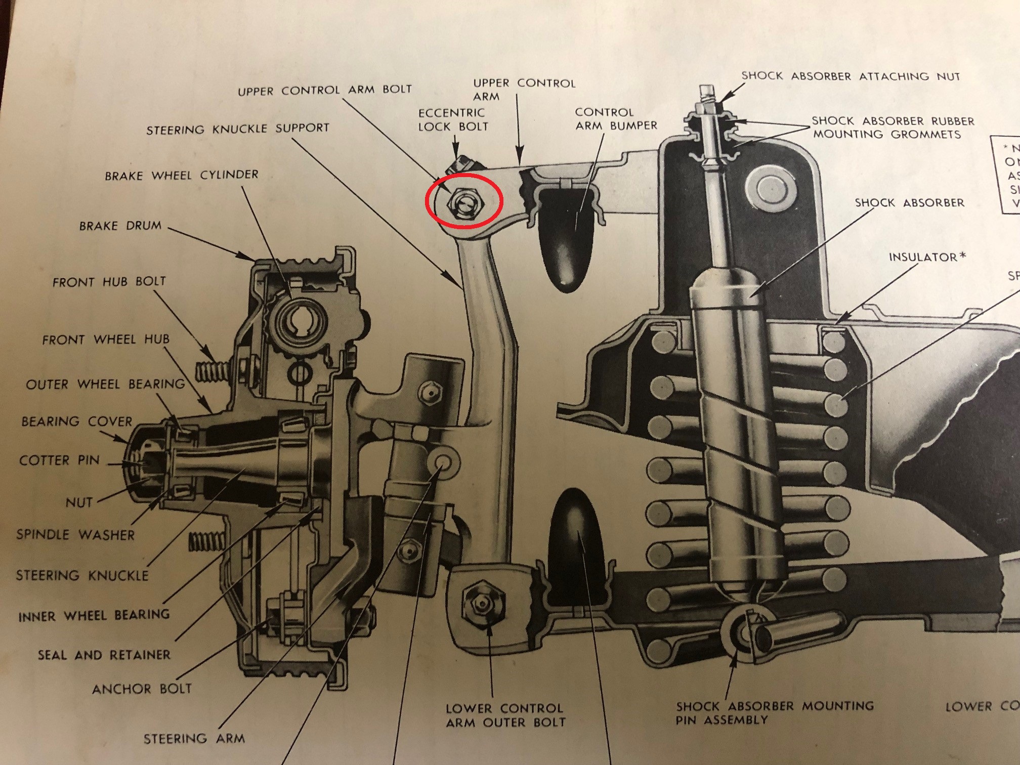

Your LH upper outer pivot bolt is in backwards. The grease nipple is supposed to be at the rear.
(I haven't read any further in the thread, but reversing the upper outer pivot bolts my be a start.)
There was such a thing as an HD-king-pin-only upper outer pivot bolt. It will probably take someone like Dr Terry to explain why there's a sui generis HD upper outer pivot bolt and what the differences are, but I'm guessing it'll be to do with wheels fouling at full lock.
Re: Harv's meth monster project
Posted: Sat Feb 12, 2022 4:19 pm
Interesting. The EK Workshop Manual has a warning:
Caution: The upper control arm outer bolt must be screwed in from the rear, otherwise the head of the bolt will foul wheel balance weights when steering is on full lock.
That's pretty much what is happening here.
Tomorrow: turn around the upper outer bolts, see how it goes. Remembered too that my pitman arm puller is out on loan... must chase that one now that things are getting more serious in the steering department.
Thanks gentlemen.

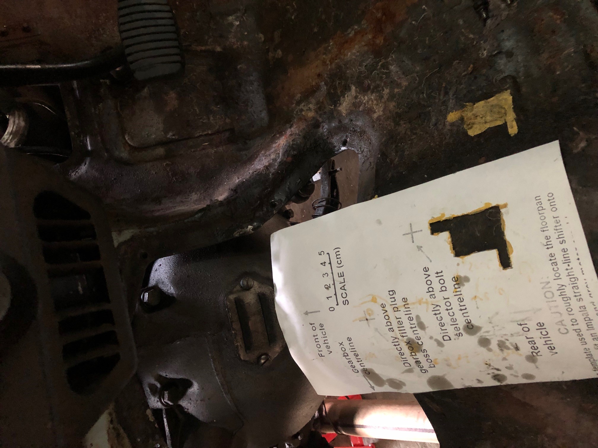

Got the gearshift linkages removed, front carpet and underlay out. No rust under the carpet, but half of Crowdy Head beach sand still in the carpet.
Printed out the template for the Impala shifter install from the Crashbox Guide. Marked the floorpan with yellow paint marker for the slot I need to cut.

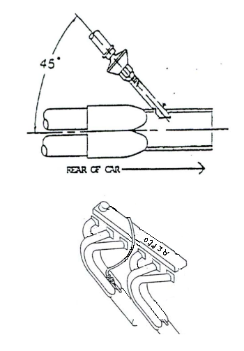

Thinking through the practicalities of running the Repco head on a drag strip, and got to thinking about the sideplate breather. Some tracks get very fussy about the need for a catch-can, and may not be very enthusiastic about the use of the walking stick (I have to run a Coke bottle on the Grace's radiator overflow line at Eastern Creek).
I've seen some photos of Repco-headed race vehicles where the normal GMH rocker cover breather is used, and a catch-can is fitted to the side plate in lieu of the walking stick. This would stop any oil getting on the track, but doesn't do much for crankcase ventilation - with no walking stick to venturi out the fumes, it would tend to be fumey. Not the end of the world, but not too elegant either.
Got me to thinking about crankcase extractors. These are used on some race vehicles to draw a vacuum on the crankcase. They work exactly the same way as the walking stick does, but instead of using air flowing under the car to draw the venturi, they use exhaust gas. There are a number of companies that make weld-in kits (like Moroso). The setup would be similar to the image below:
- Exhaust ejector.png (75.5 KiB) Viewed 5327 times
Air is sucked in through the standard rocker cover breather, and out through the sideplate. A length of pipe takes the fumes down to the headers, where the extractor fitting is welded in. Any oil droplets go into the hot exhaust, and get burnt before exiting the rear of the car.
Anyone have experience of using exhaust extractors like this?

Hey Harv,
I run mine straight to a catch can. Not ideal but keeps it safe and the tech inspectors happy.
Peter Grant has his plumbed into his exhaust.
Happy to flick you some pics or Peters details (if you don’t already have them)
