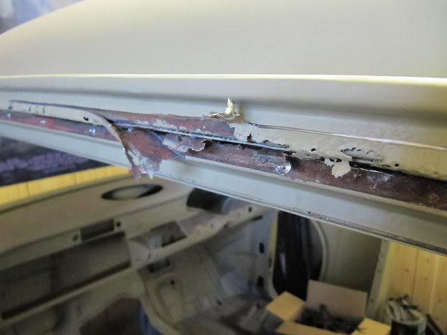

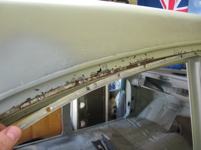

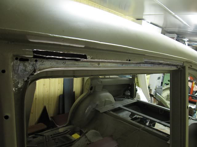

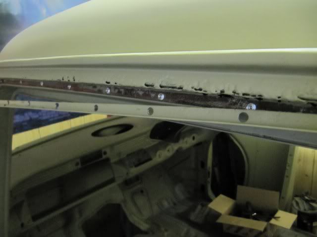

First I carefully drilled out the sport welds for the channel piece or whatever you want to call it as we wanted to re-use this section.
Then attacked all the rusty bits
to get it all nice n clean

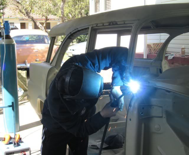

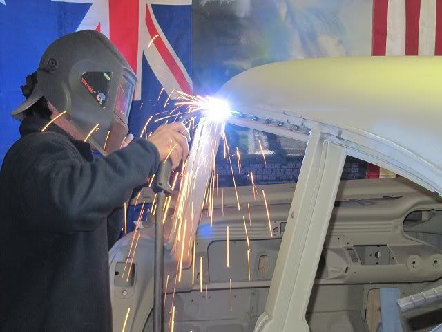

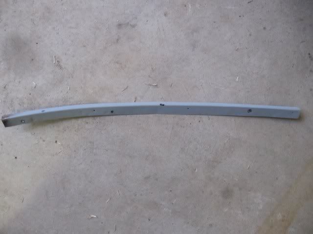

Luis then welded in a donor section that I got from Greg (EK283). More grinding I guess... :evil:

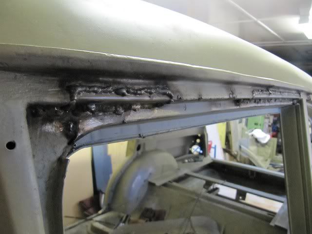

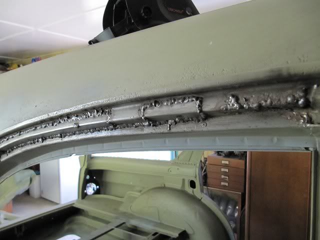

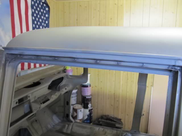

Channel piece or whatever you want to call it is spotted back in...
Good as new :D

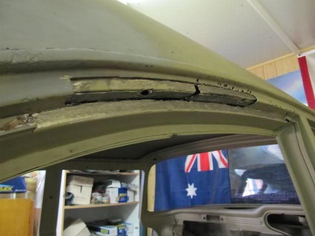

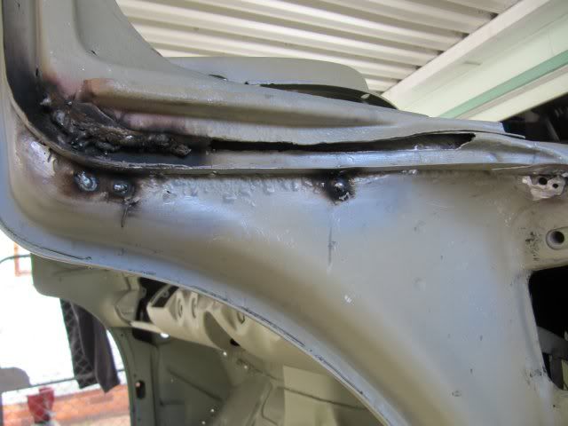

then over to the other side...are we having fun yet? :roll: :lol:
same old drill
donor section - thanks Greg!

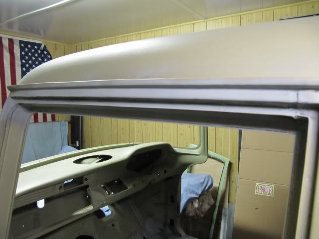

where's the grinder? - I need it over here...
done

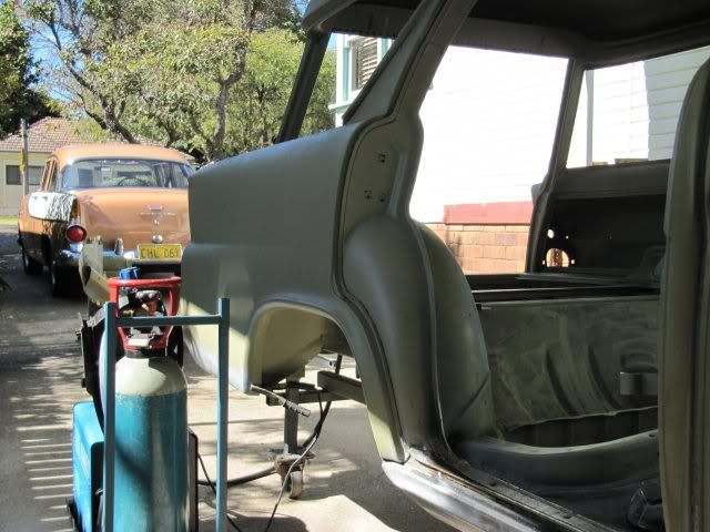

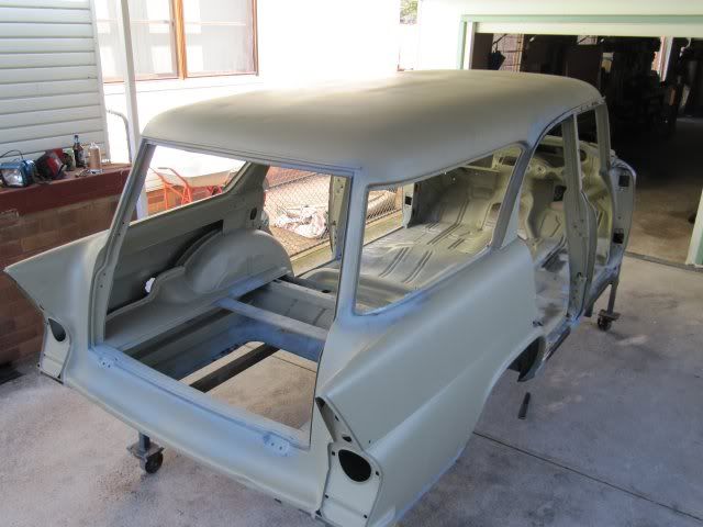

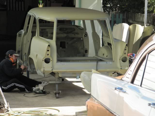

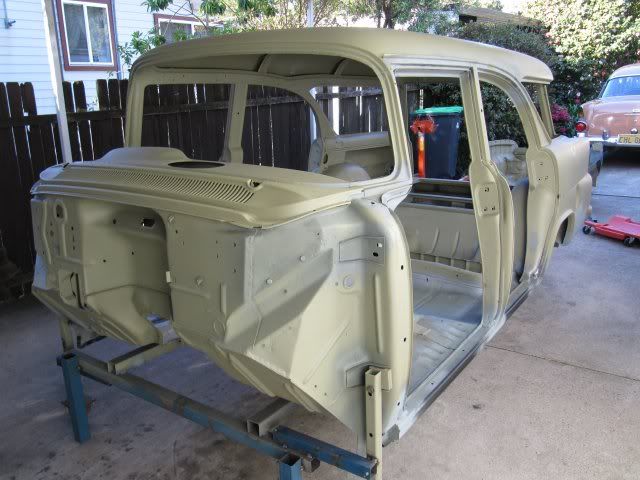

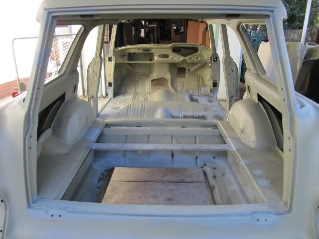

then first weekend of September Old Timer was rolled out for a final look over and fix up of any bits we missed and to check for pin holes...
...after 2 years and 9 months...:shock: the rust repairs are finished!!! what an unbelievable feeling!
without this bloke none of it would've happened - thanks Luis- you're da man!!! 8) 8) 8)
long live the longroofs!
wooohoooo!!!! :D :D :D 8) 8) 8)
