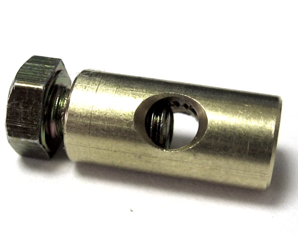

Errol62 wrote: Thu Apr 11, 2024 6:10 pm I use a similar setup on a smaller scale for choke on SU carbs. The clamped cable and an over sized bolt head effectively sandwiches the lever, preventing the body from escaping.
Ahhh... thankyou. Now I can picture it. Something like this:
cable stopper.jpg (4.62 KiB) Viewed 2205 times
That might work, if the arm is wide enough to take the cable stopper body. I could replace the bolt with a fancy ARP one for neatness. I will do some tinkering on this one.

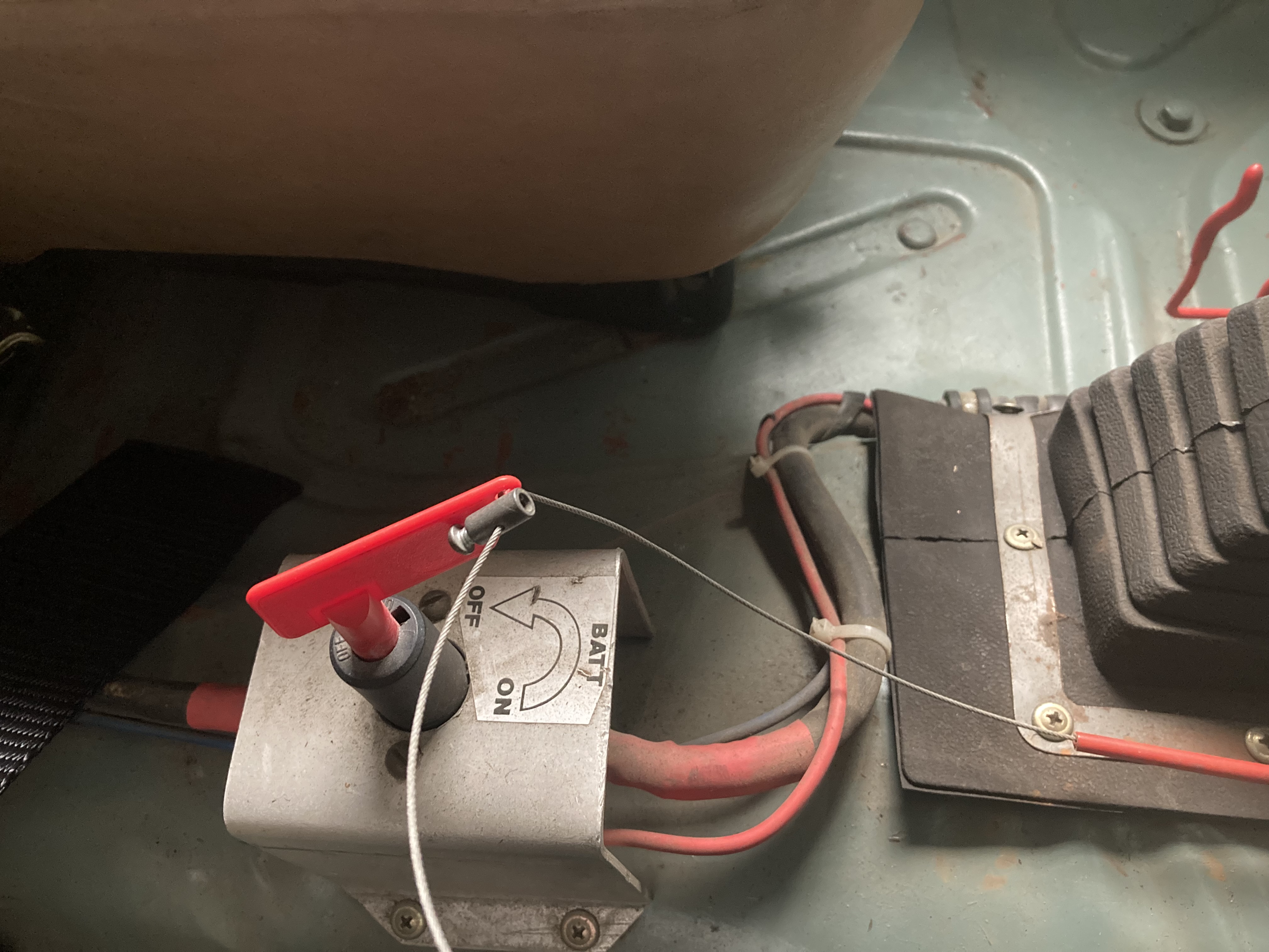

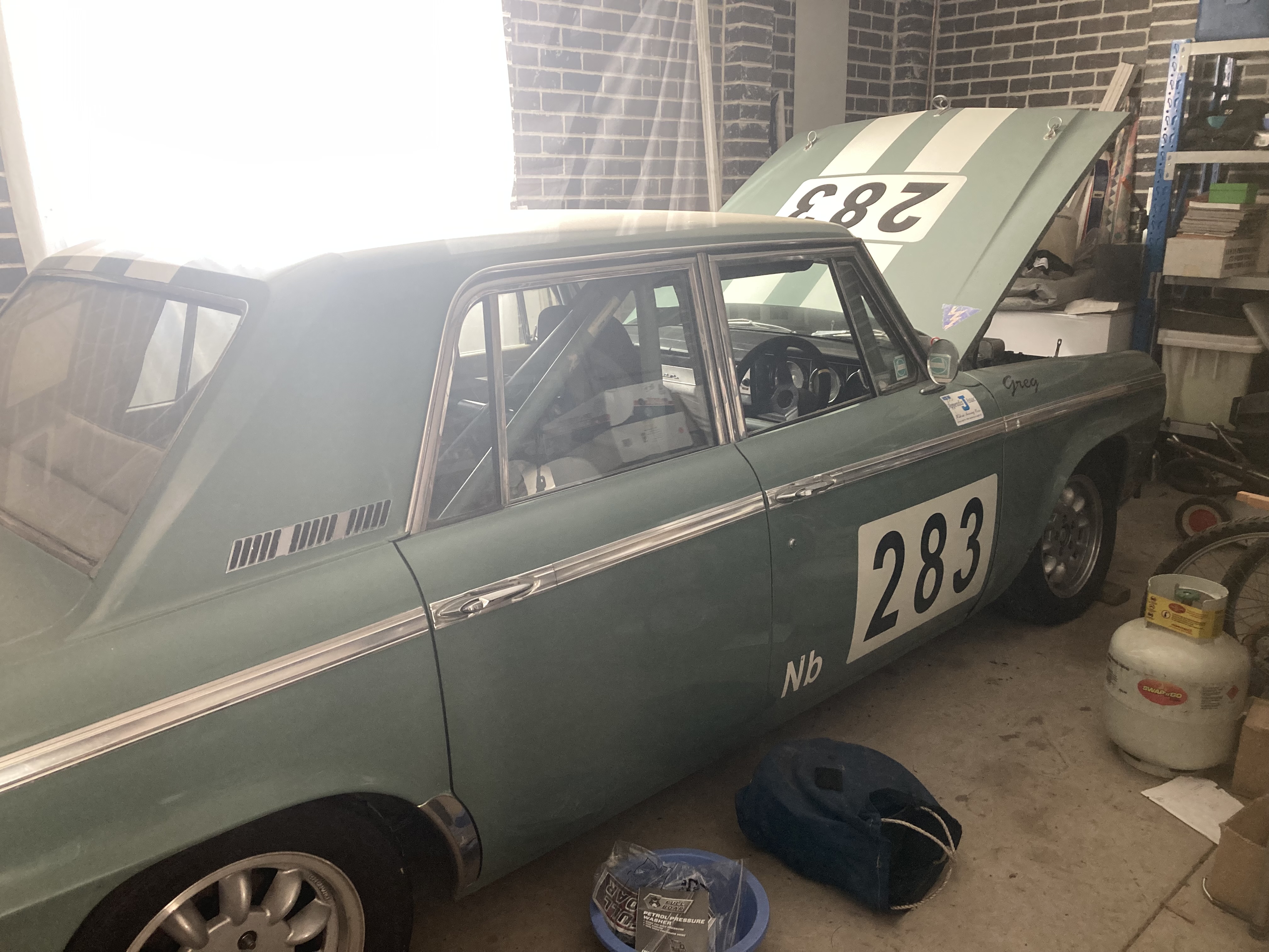

by EK283
Not sure if this helps Harv,
My race car (lately garage art ) has a pull cable to the ouside of the vehicle to stop the ignition by officials and is mandated by cams.
It is the smplest way i could find to do it and it works ok. See photos.
It does however need to be reset manually.

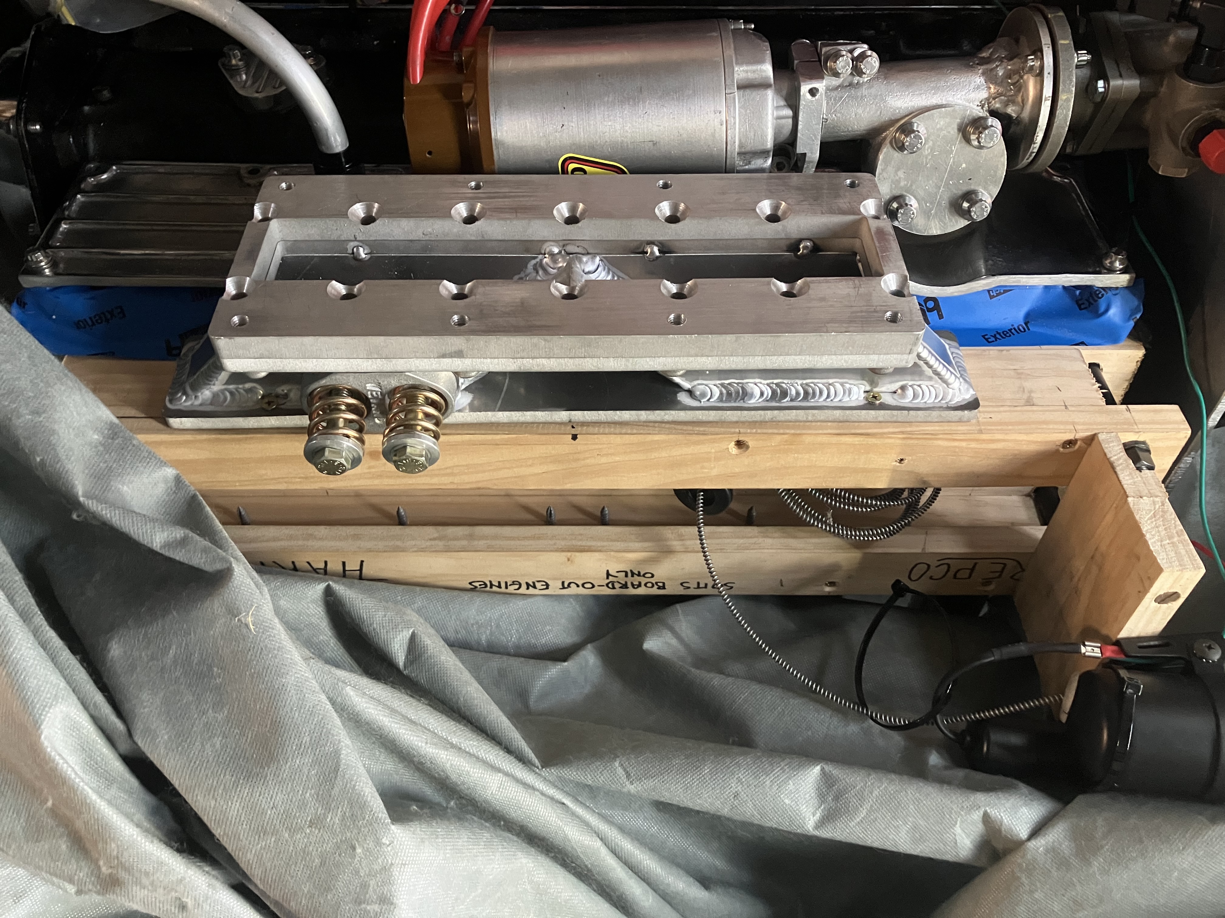

Cylinder head-to-Norman and Norman supercharger to McGee injector manifolds arrived today, with thanks and respect to Mallaby Sheetmetal and Bain Racing. Need to remember how to use my BMC Mini pixie-fingers. Teaser photos below:
Suddenly the real estate on the (normally) boring side of a grey motor got scarce.
Onwards and upwards.
