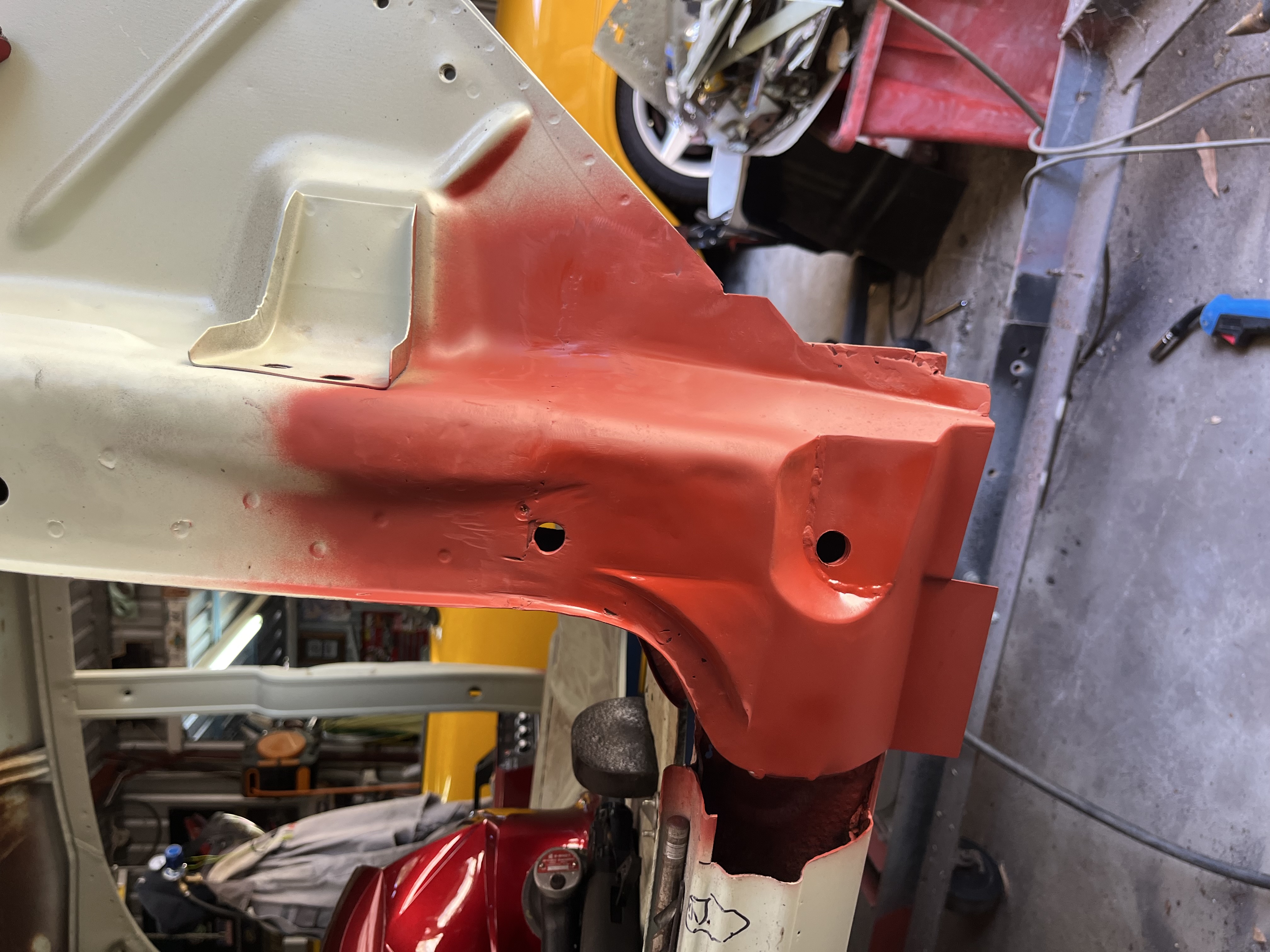

Posted: Sun Jan 14, 2024 2:48 pm
by FireKraka
Driver side A pillar finished, have to trim a couple of places but basically sound
Re: Neil's FB Station Wagon
Posted: Sun Jan 14, 2024 11:22 pm
Beautiful
Posted: Sun Jan 14, 2024 11:41 pm
Gotta admire your tenacity mate :thumbsup: :thumbsup:

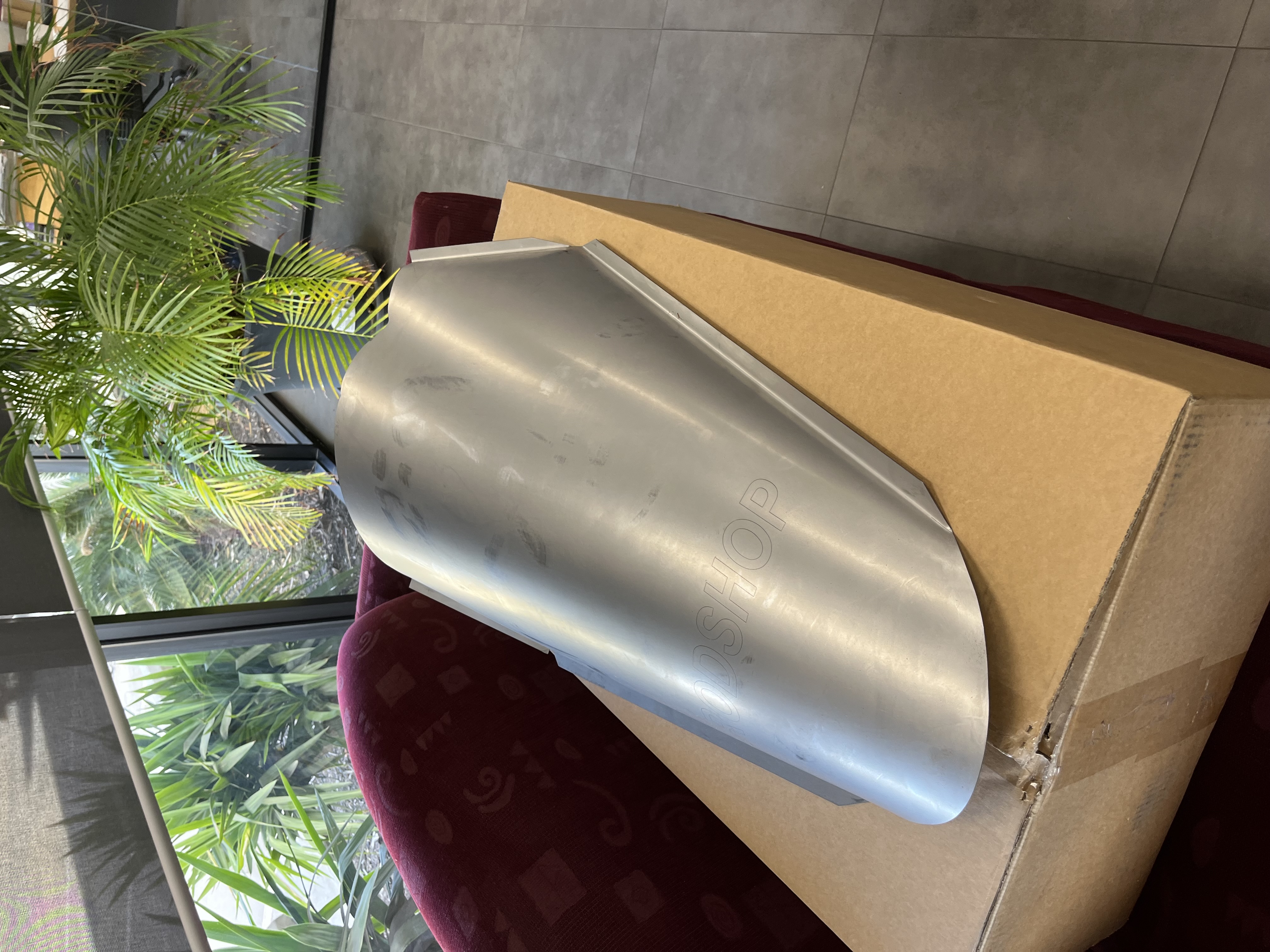

Posted: Thu Jan 18, 2024 2:46 pm
by FireKraka
New floor hump just arrived, see how we go this weekend

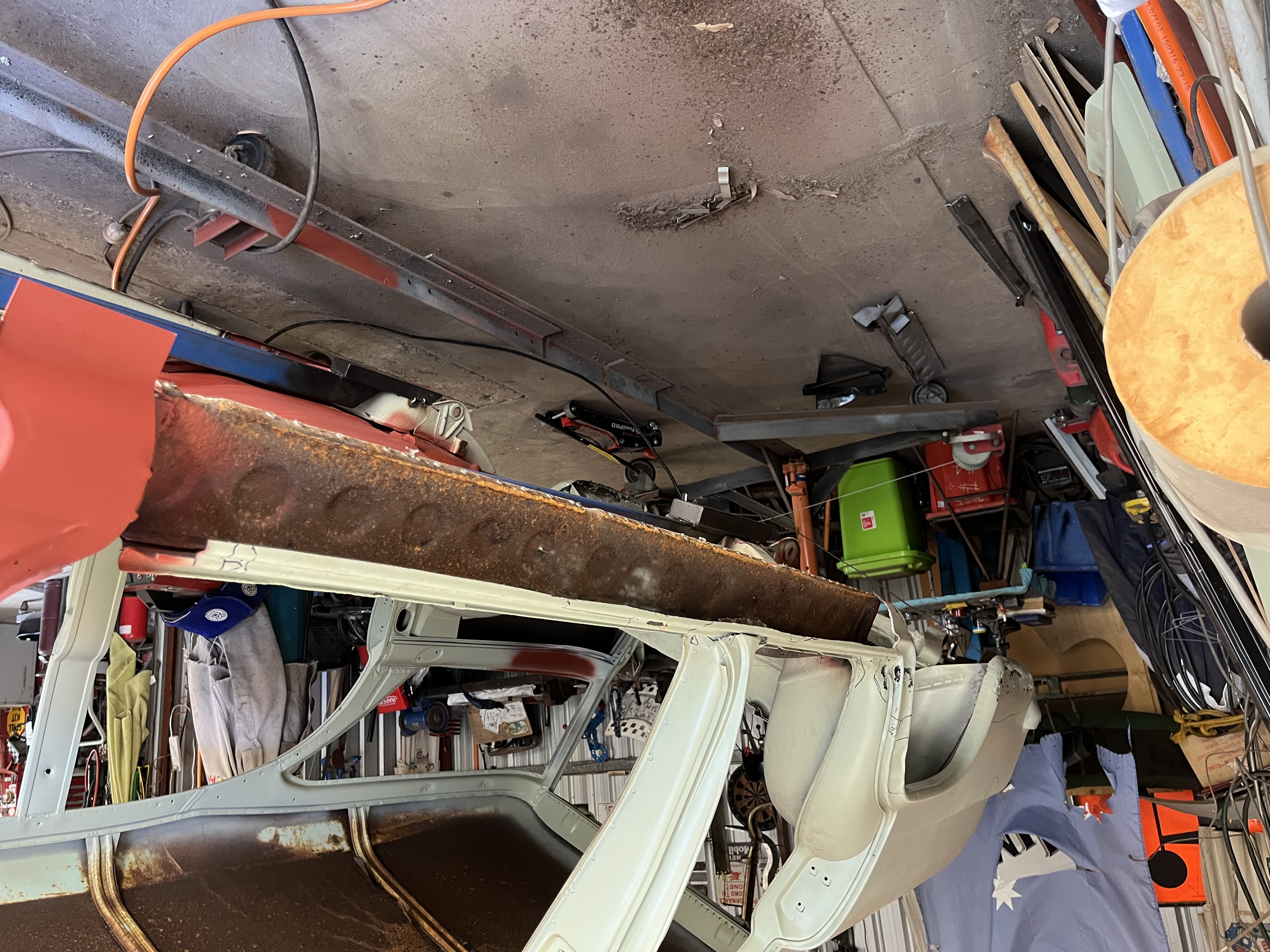

Posted: Sat Jan 20, 2024 10:56 pm
by FireKraka
Does anybody dislike spot welds as much as I do :lol: :lol: unfortunately I think I still have lots more to deal with.
Removed the driver side outer sill just as bad as the passenger side but at least the inner is intact.
Posted: Sat Jan 20, 2024 11:33 pm
Not bad. Yeah fuching bastards. Not as bad if you are sacrificing one of the panels. I cut and twist off the sacrificial panel, then grind the remaining weld.
Posted: Sun Jan 21, 2024 6:53 am
by funkyscooter
I have a spot weld drill that I only use if I am re using the panel underneath. It's useless, even when new it requires so much force. If it's the panel underneath that I am replacing I will just drill the weld out. Thinking of getting an air hammer and spot weld chisel when I do the sill on mine - anyone used one of these successfully?
Posted: Sun Jan 21, 2024 7:25 am
by Brett027
Scott, I have used an air chisel with a flat blade extensively in my builds to seperate spotwelded panels. Very fast and pain free. One panel/side is sacrificial though unless you drill the spotwelds first and then it is pretty tidy splitting the two panels. Cheap Ryobi job from bunnings.
I use a German brand spot weld drill that is relatively easy (picture in Wilma build from memory). Cuts through tendons too.
Posted: Sun Jan 21, 2024 7:49 am
by funkyscooter
Think my dill bit is a sutton - came in a two pack, so that pretty much sums up their faith in it.
Thanks Brett for your thoughts, going to invest in an air hammer me thinks.
