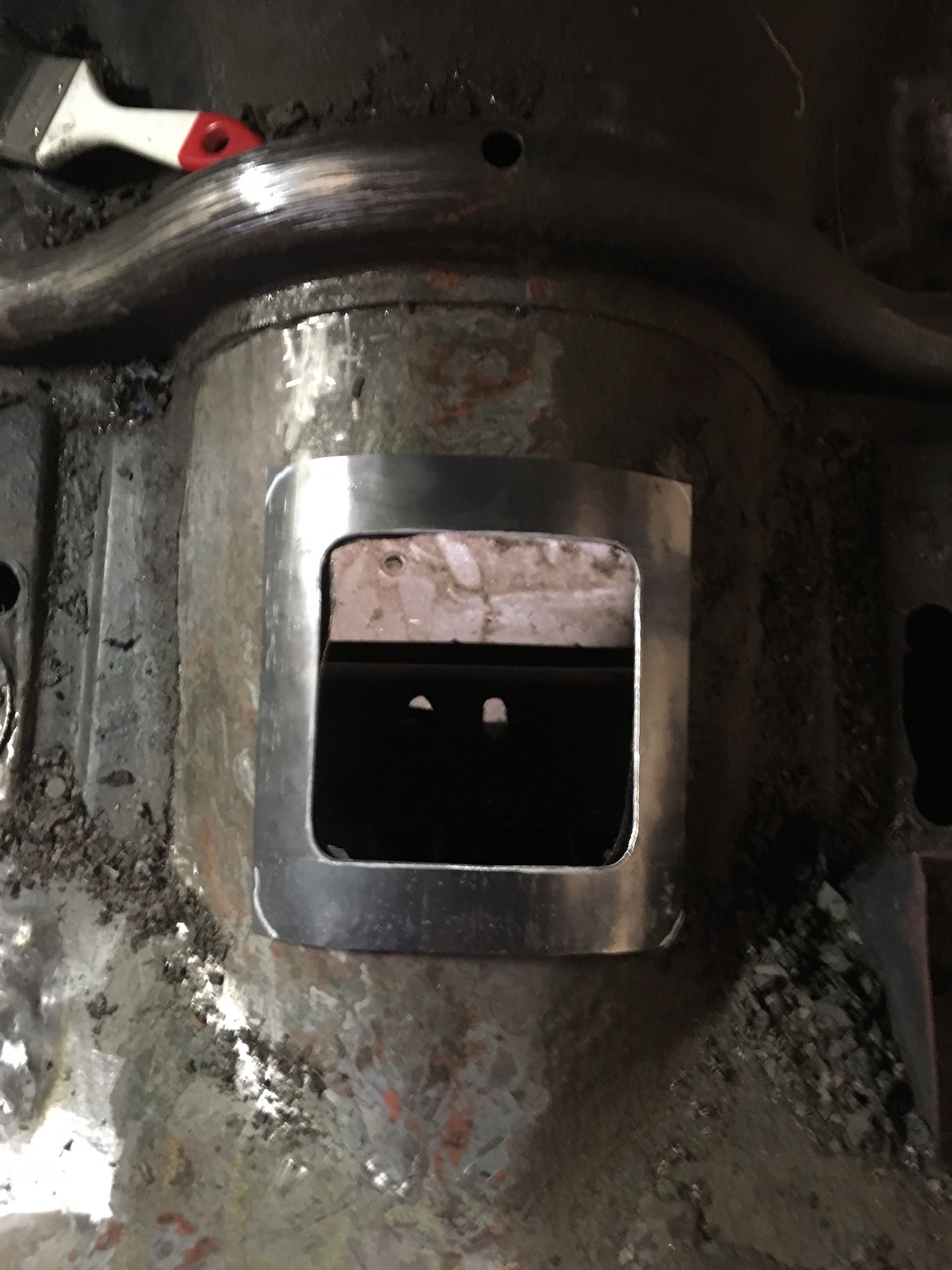

So been chipping away so though I'd do a little update.
Decided to do a bit of a clean up on the transmission tunnel. So got some sheet metal from Bunnings and started laying into it with a rubber mallet on my forming bag . Hard work. really appreaciate the cold rolled 0.8mm sheet that I used on the A-pillar. Several checks and then cut out the centre and this is the result. Was pretty happy till I got the gear lever out for a test fit. My cut out is too big, The holes that the boot is meant to mount trough are clearly visable. Also came to the realisation that the fit of the boot is going to have to be done with the gearbox in so threw the metal in the corner and left this for now.

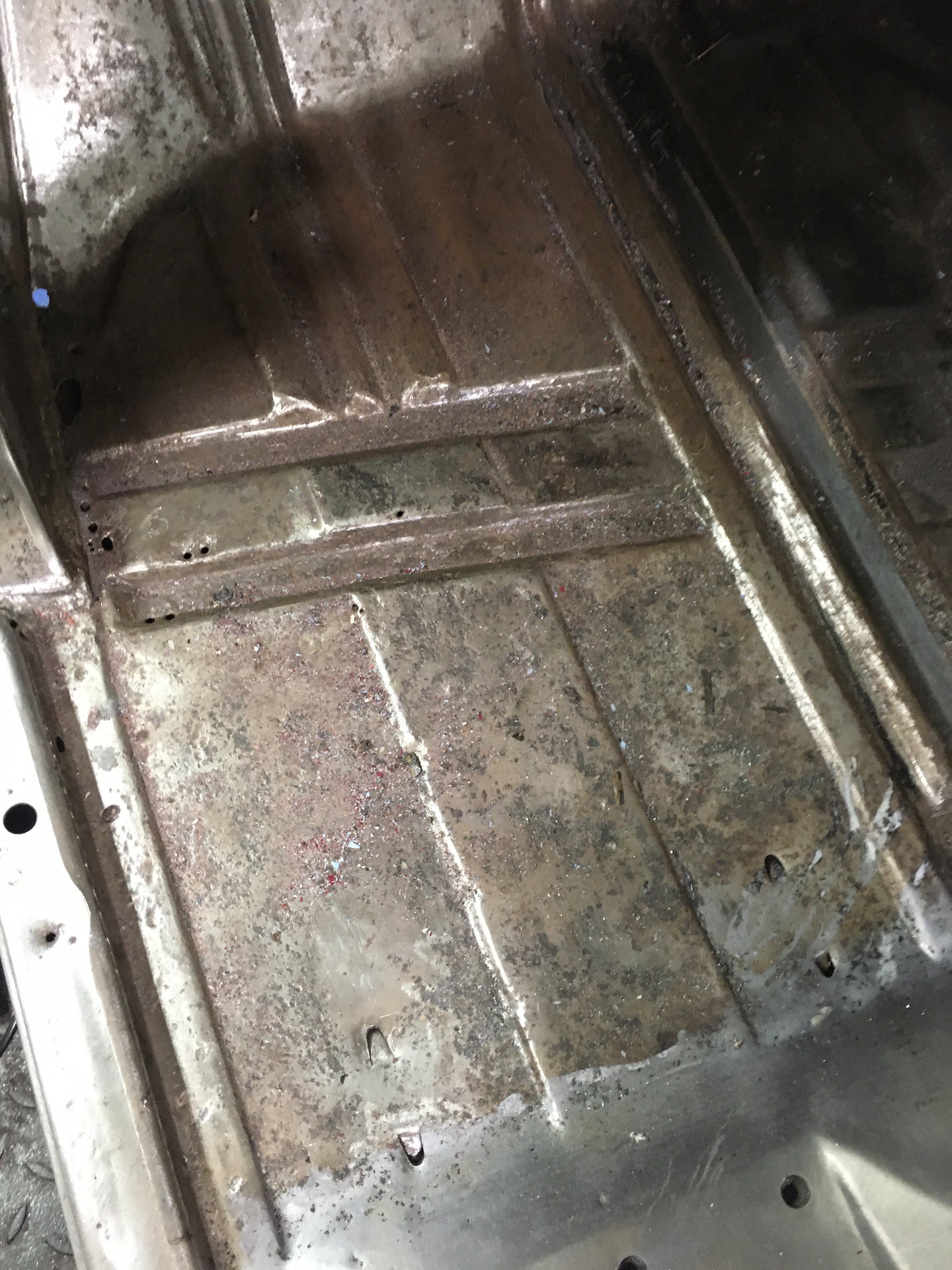

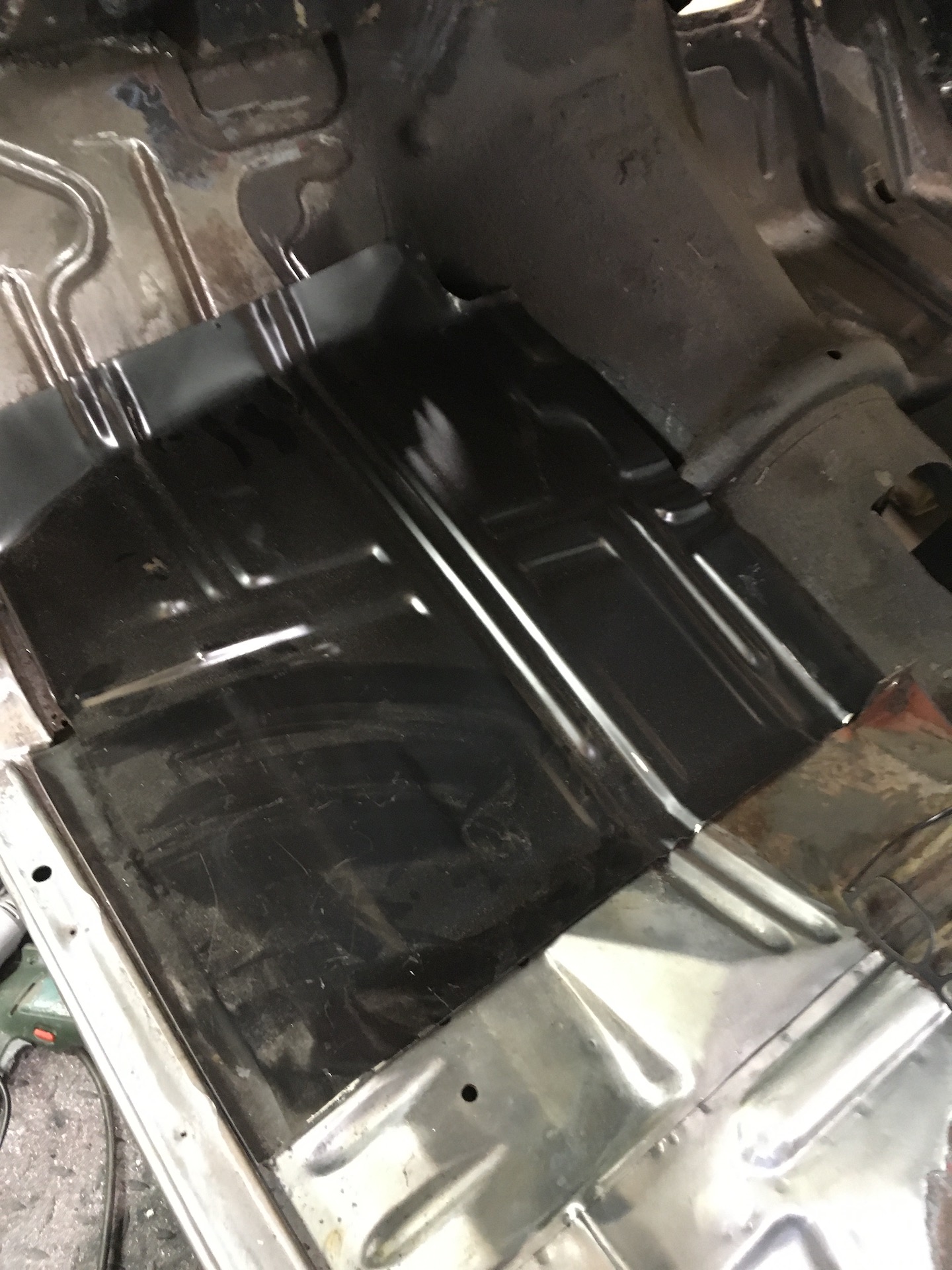

So Next. Passenger floor.
Doesn't look too bad in the pictures and toyed with welding up the holes. But already had the floor. So marked on the worst bits of the floor and started cutting and drilling out spot welds. Not rust! This car has spent some time on dirt roads. In all my time with the car (24 years) it has never touched dirt like this. Really hard to work out how it got in here.
Quick powerfile just to make sure its not rust. Unfortunately joy was short lived. Cross member that attaches to inner sill is full of the both dirt and my old friend rust. Scientific analysis shows that this car may have spent some time on or near a cattle farm.

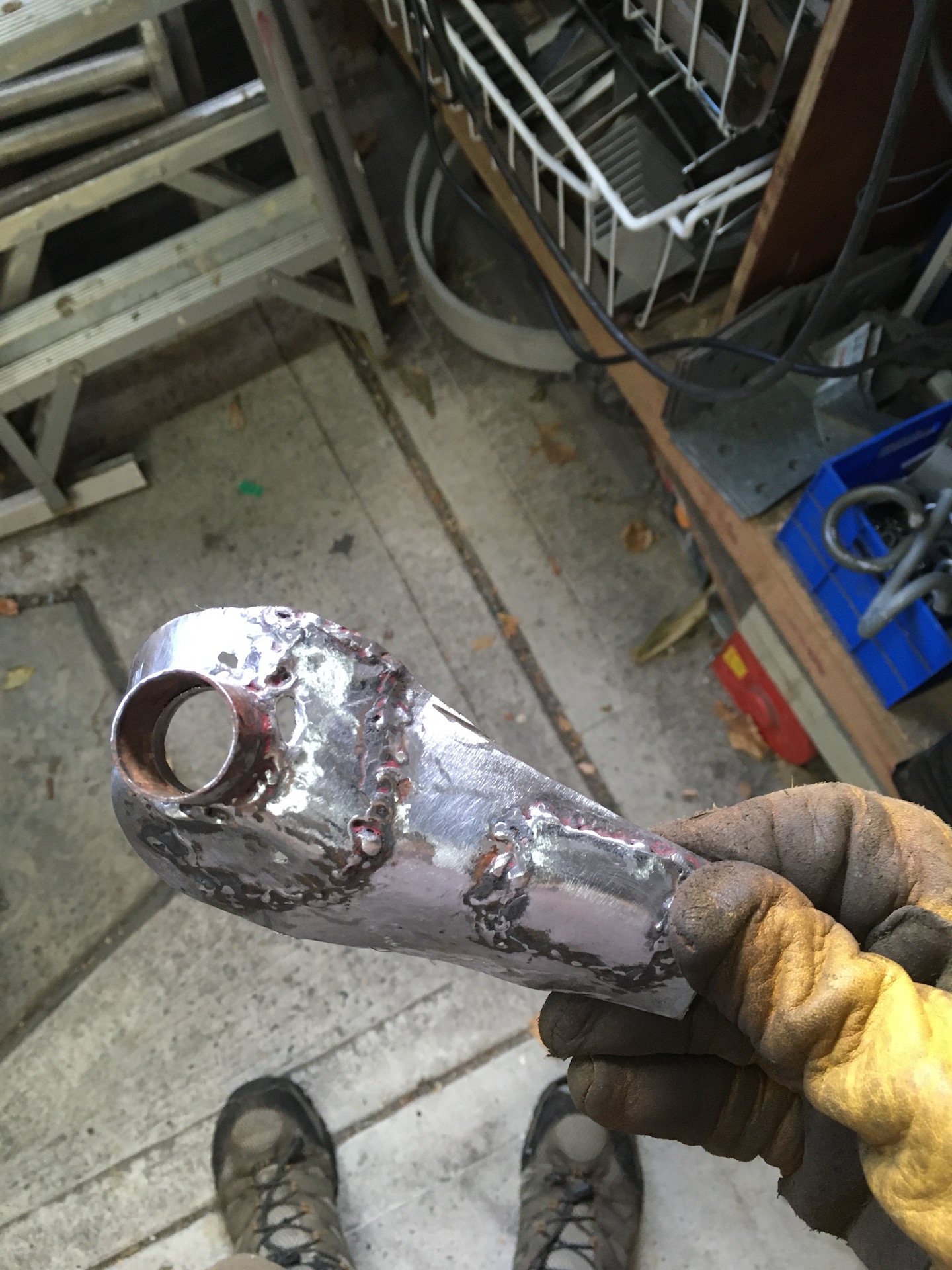

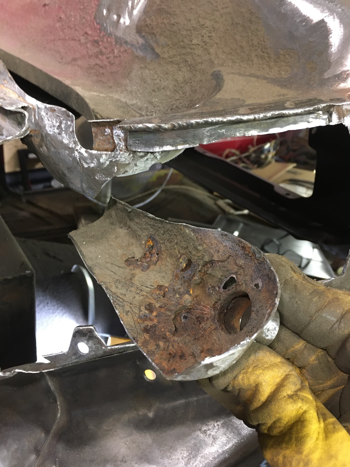

So before I fix the fire wall I have to fix this.
Well actually worse than just the bit at the back. Yet another dodgy repair. Off it comes.
Bit of a patchwork.
Grabbed a bit of off-cut from the new floot and attacked it with my shiny new ball peen hammer over my sand bag. Going to have a popeye arm by the end of this - it weighs 900 grams.
2 hours of hammering, grinding and swearing and ended the day with this. And yes I know I need to put the drain in!
