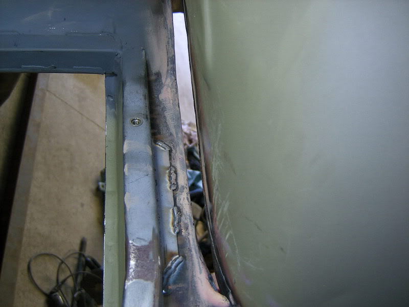

Posts: 14059
Re: Red Rattler Revamp
no pics, while the diff was out I cut the strip between the rail and the inner out, belted it across and welded it back together again, pretty easy job did them in a night.

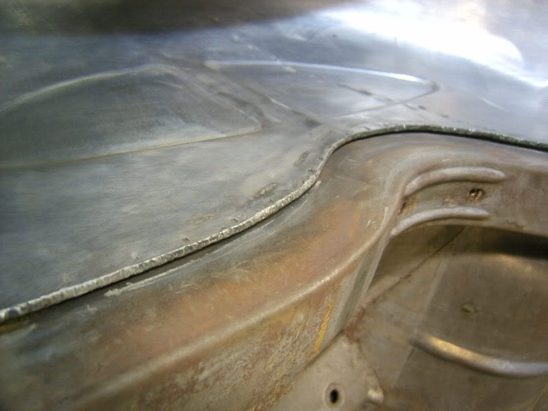

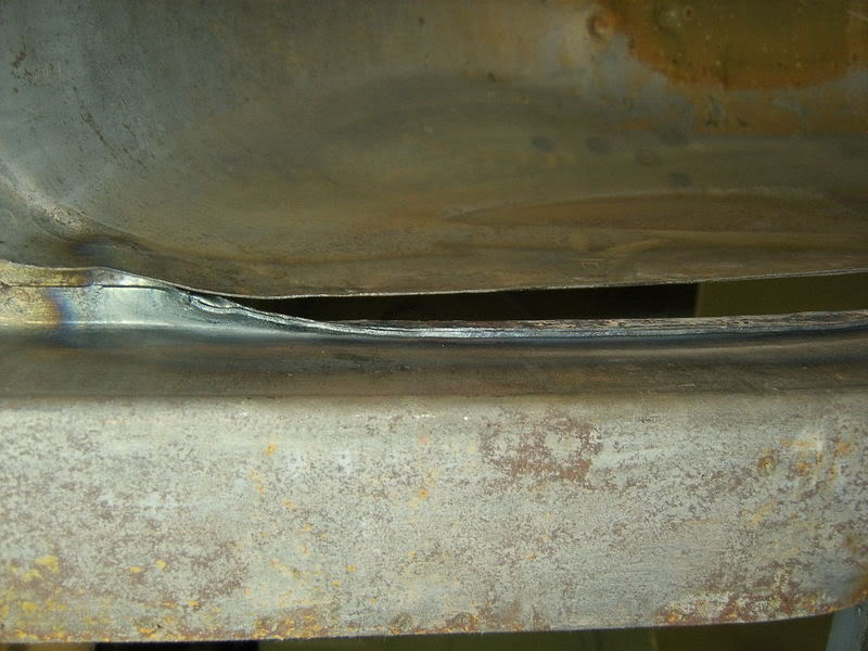

Posts: 11513
Blacky,
A lot of people seem to cut and shut the whole tub inner wall across, which is quite a bit more work. Seems to me your method be just as effective. As you say the gain is not great, although I've noticed that any rubbing tends to occur above the lip with body roll. Increasing clearance slightly beyond the rail could have some extra benefit.
