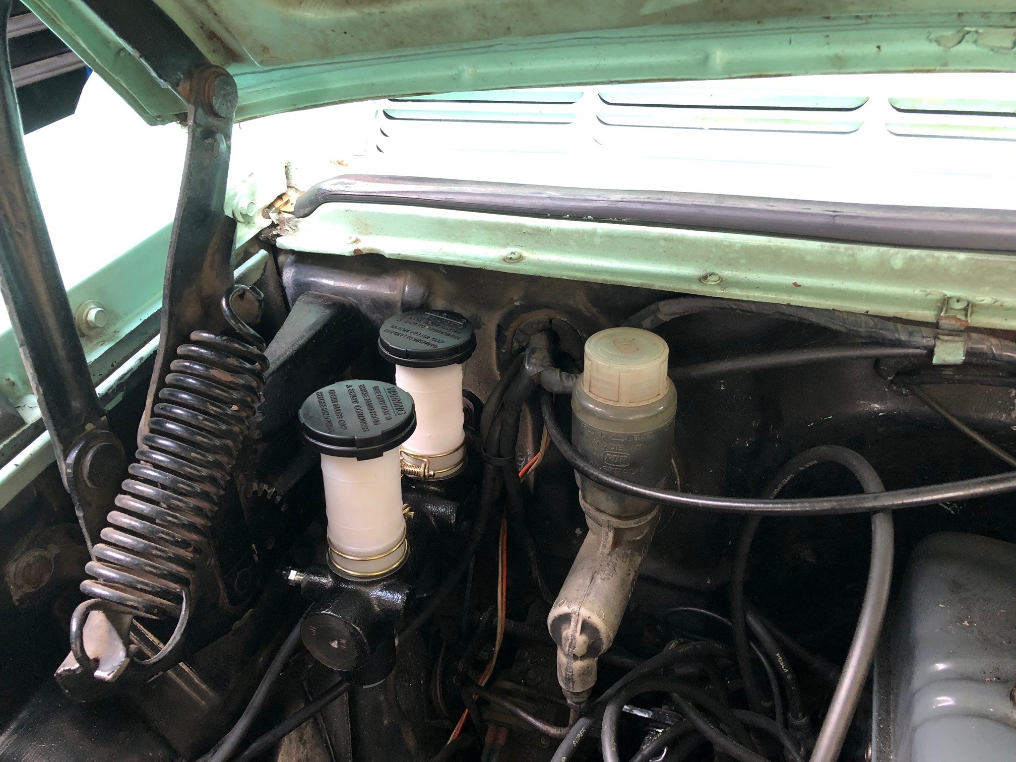

Still can't get out to buy the front brake hoses, so decided to throw the master cylinder in. It needs to be dual circuit, and look kinda period correct. Some discussion with the gents at Hoppers Stoppers led to this one.

Its a Protex JB1217, with 1” bore so the rear drums will be happy. The mounting surface is a spigot fit, with bolt centres within 1mm of the original master (near enough to bolt straight up once the firewall is hole-sawed for the spigot). Thought it would be touch-and-go on clearance to the bonnet springs, but it clears! Happy days - a near bolt-in dual-circuit master for FB/EKs :D
Had to take 0.4" off the pushrod length, as the spigot moves the pushrod contact point inboard (you can just back off the pushrod, but the pushrod threaded end bottoms out on the pedal arm before you get freeplay at the master). Probably wants another poofteenth off the length to account for my missing brake pedal rubber bumper (it was brittle, and did not survive the fit-and-fiddle). Need to be a little careful too on the fittings. The threads on the ports are M10x1.0 inverted flare, not UNF like the rest of the car. Flares up fine though on normal 3/16" tube.

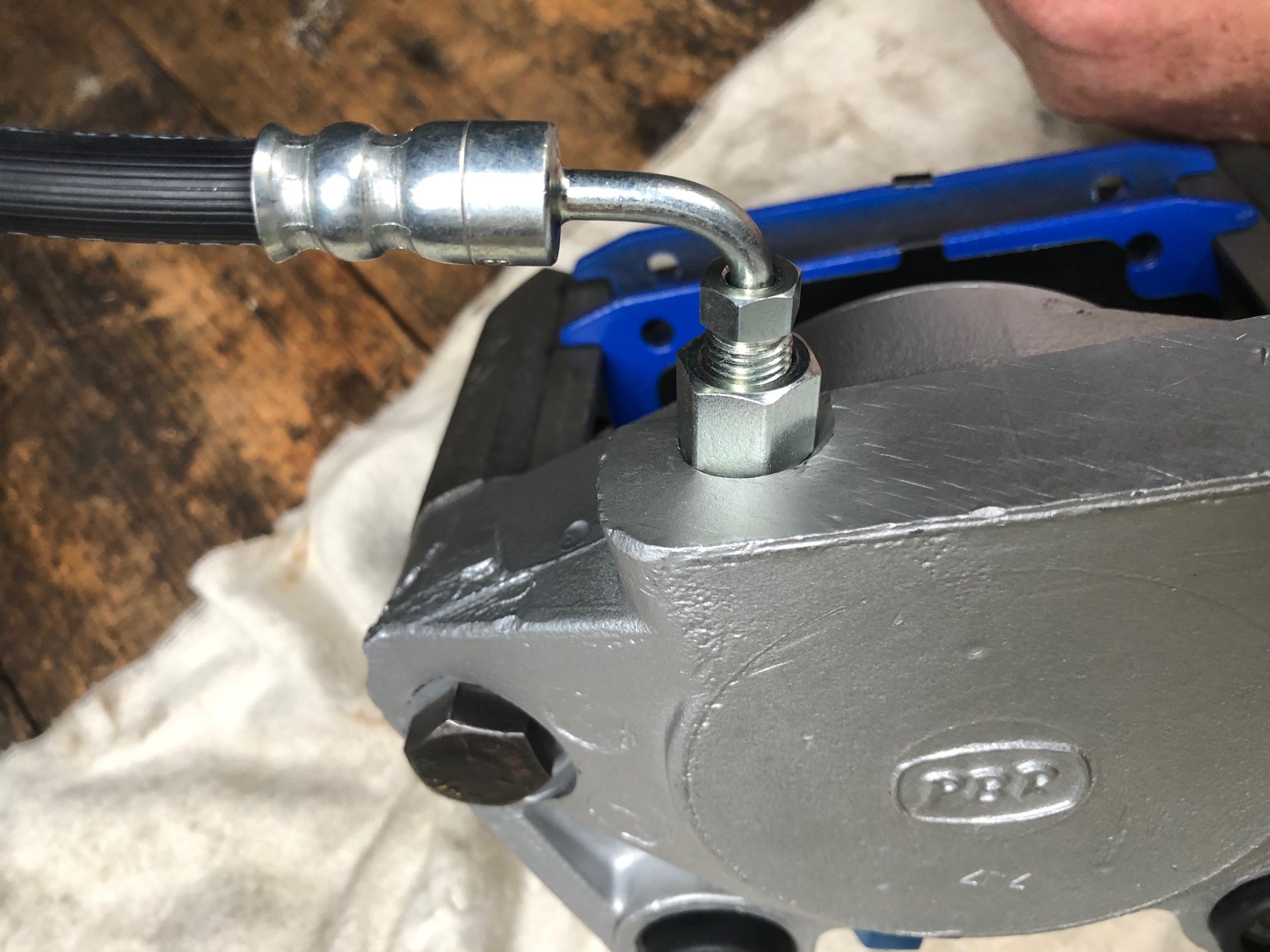

Also managed to get over to Burt Brothers and pickup the hoses:

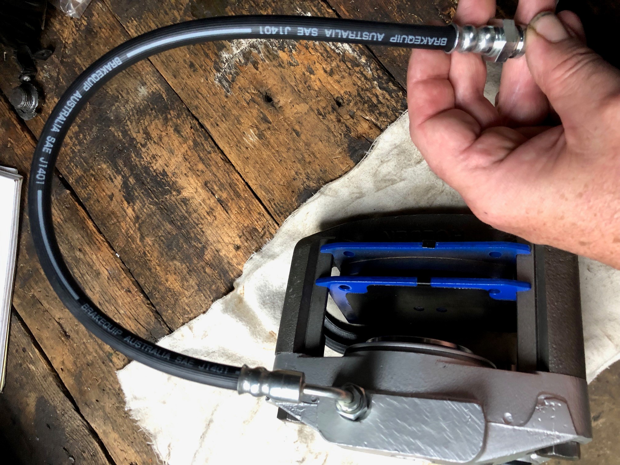

They have funky ends on them to turn the hose... standard hoses tend to point the hose into the front suspension spring coils at full lock :shock: :

The hose ends go into the old bleed screw location (same problem... use the original hose holes and they point into the spring coils). I had hoped to use the old hose hole on the caliper for a bleed screw, but don't think I will get away with it. The holes are drilled deeeeeeeeep into the caliper, and there is a pretty good chance that the pointy end of the bleed screw touches the piston. For now, I'll block them off with plugs (ignore the rubber o-ring... copper washers to come).

But how do you bleed them if the bleed screw is not at the high point? Easy-peasy. Take the caliper off (leave the hose on), put a block of wood between the pads, turn the caliper so that the bleed screw is at the top, then bleed them. Reinstall. Now, with a plug in place, that is going to be harder, but not insurmountable. Bleed, bleed, bleed then screw the plug in. Messy, but doable.
