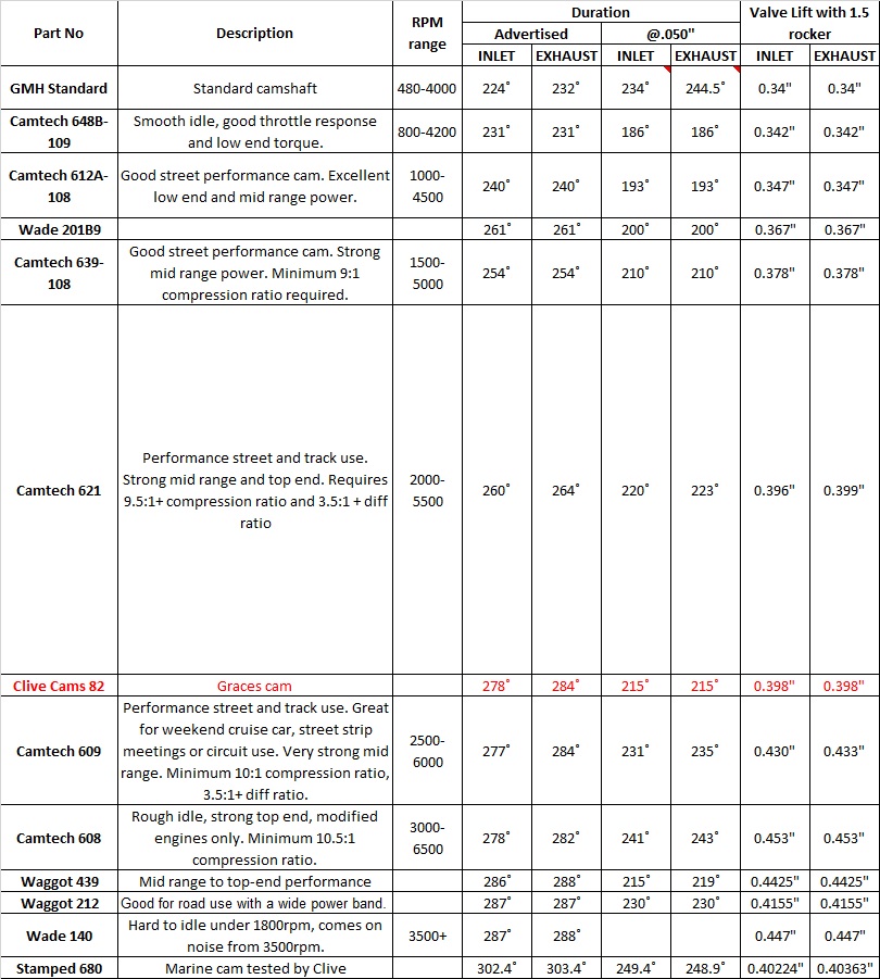

Bump stick came back from Clive. Hopefully get it put in this week. Lumpy enough for the task... should be fun.

Looks serious.
Re: Harv's (Grace's) EK ute
Posted: Sun Jun 20, 2021 1:19 pm
That thing is ridiculous, looking forward to hearing it "idle" :lol: :lol:

wow thats a lumpy stick Harv - going to be fun to get it to idle - what are you doing with the head and pistons to get the compression up enough?
The guys at Dynomotive are hinting that I need a lumpier stick for the new head.

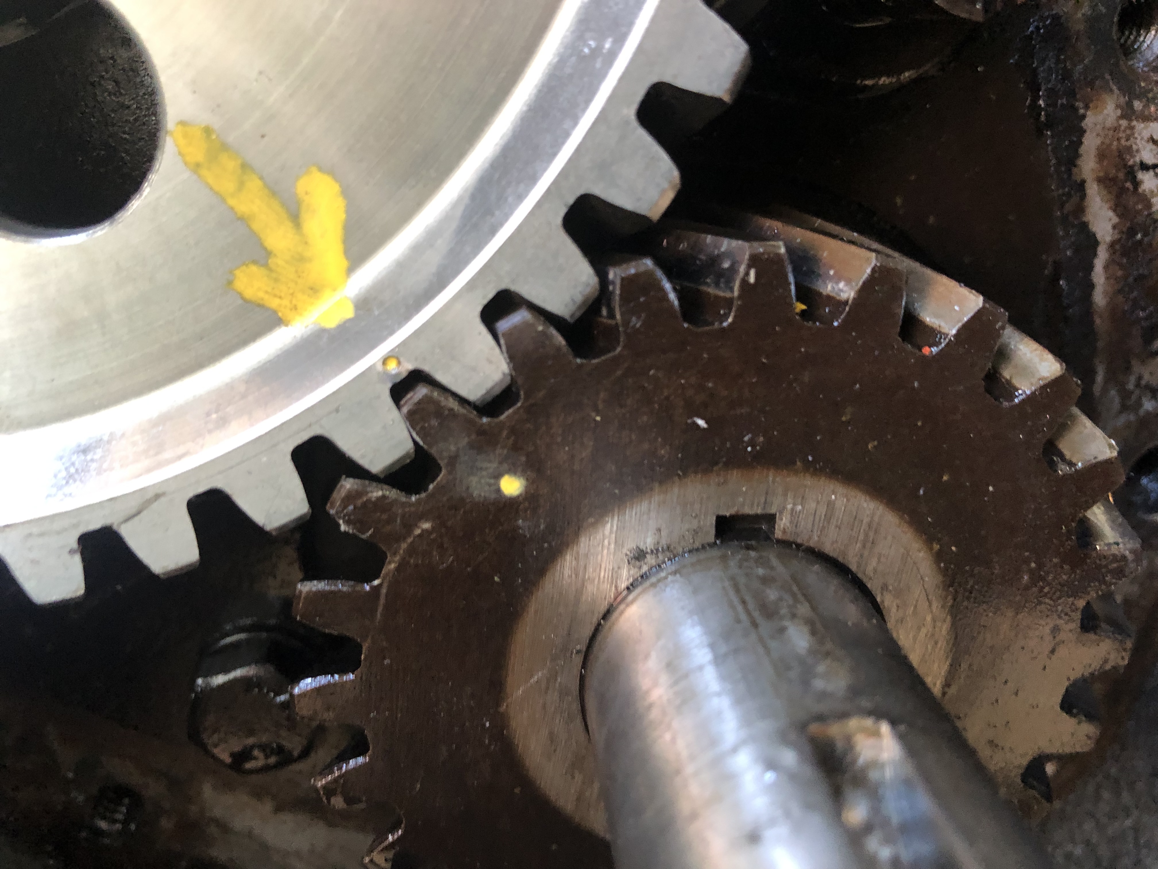

Pressed the timing gear on, and despite lube it wanted to “jump” in increments rather than ease it self on. Back and forth, on and off the cam hoping that one of the jumps would give me 4-6 thou float. Finally got there 5 thou).
Cam lubed and in, mandatory photo to remind myself later that yes, I did line up the dots:

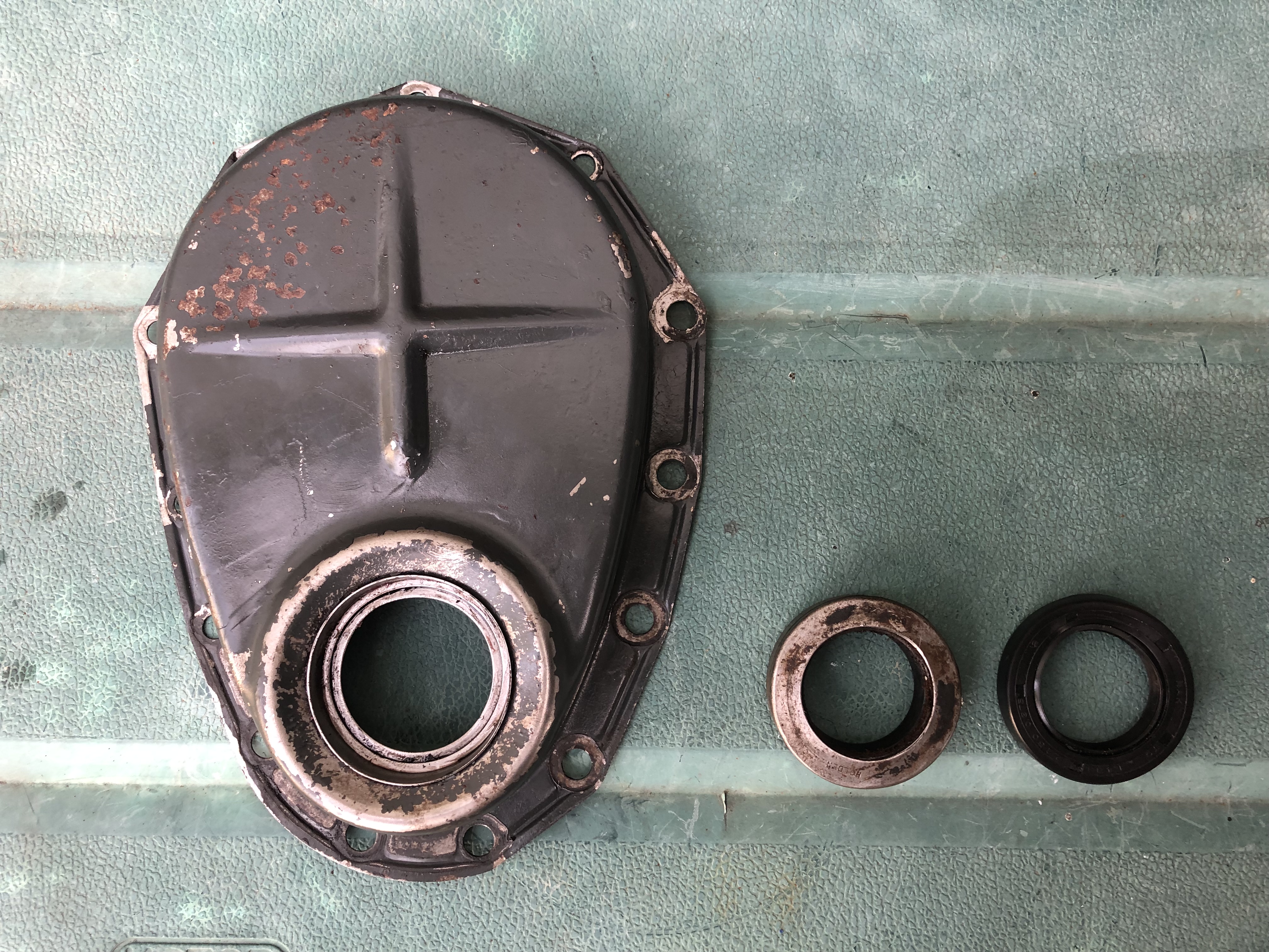

Went to press in the timing case seal (late grey motor… big seal). Felt waaaaay to big, and would not start despite greasing. Creased the rotten seal. More homework - suspect the seal is the wrong part.

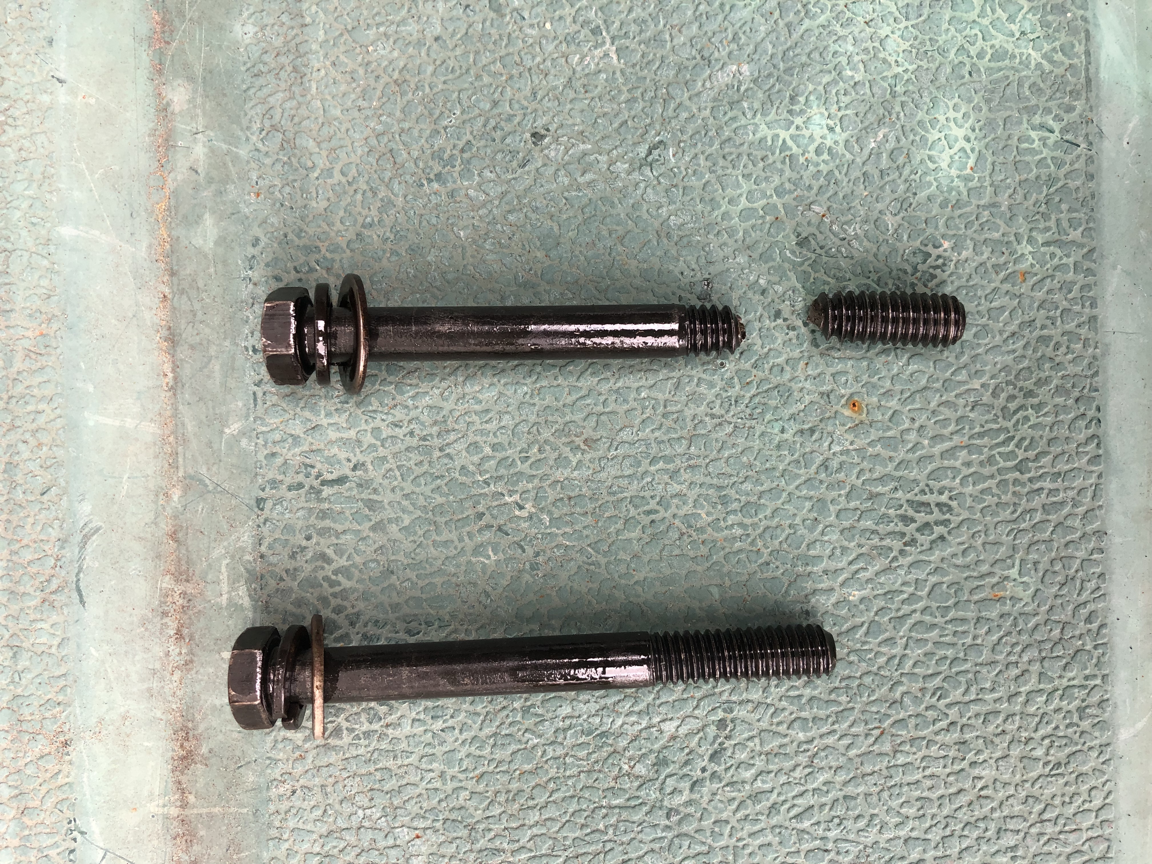

Lifters lubed and in, pushrods, rockers. Backed off the valve lash adjusters, started tightening rockers then torqued. Had one go soft. Swore. Could I be lucky?
Posted: Tue Jun 22, 2021 1:31 pm
Whew! Snapped off proud of the head. Easy removal by fingers… not easy-outs.
Off to the spare rocker department to find more bolts.

Found a bolt, rockers in. Bought two new timing cover seals. Same as the one I stuffed… too big. Dig out a spare timing cover, pull the old seal out. New seal fits new timing cover like a glove.
Then it clicked. Man am I thick.
When I pulled the timing cover off Graces ute, all I could see was a hard rubber seal. Looked like the new ones… no steel outer. Picked the rubber out, cleaned the tinware. No way was the new seal going in… creased the seal, dented Graces timing cover.
Turns out that whoever had last done up the motor in Graces ute had put a steel-backed seal in BACKWARDS… steel side in. Could not see the backer, just the rubber. I had picked the rubber guts out, leaving the steel backer in place. No wonder the new seal would not fit. That backer ain’t coming out… nothing to grab.
From top to bottom: Graces timing cover with special heavy duty Nasco seal backer in place, original steel backed seal, new rubber only seal.

by gpi
omg, you reckon they cast the aftermarket timing covers with the seal in-place?
