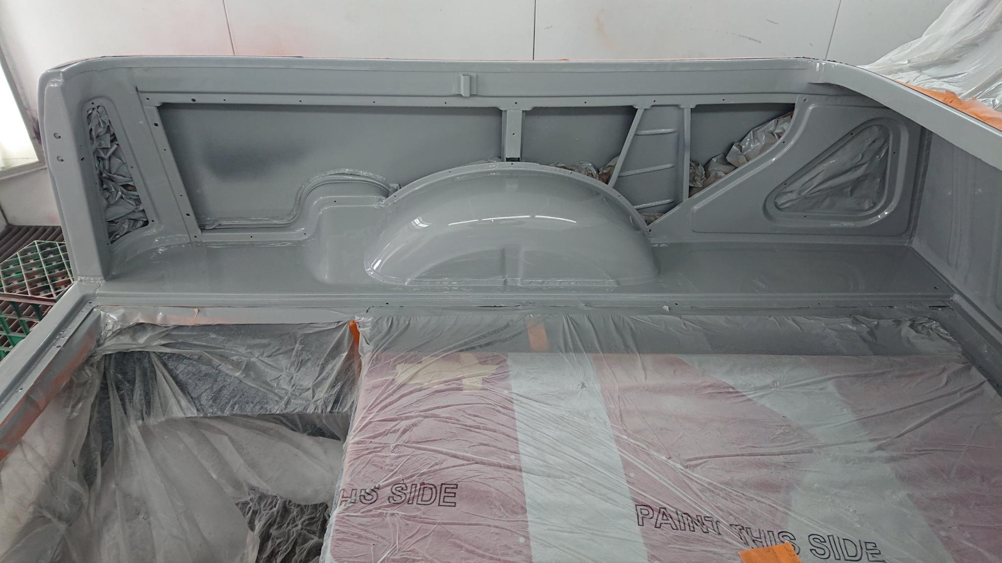

Some more paint on - tub done and looking sharp - hang panels all done and body being blocked next for the last of the paint - then the fun of putting the jigsaw back together.
Posts: 11260
Re: WALLY'S EK
The fun part. Looking great.
Posts: 5642
Re: WALLY'S EK
That grey really looks great. Looks very similar to the Silverton Grey on Grace's ute. Which colour grey is it?
