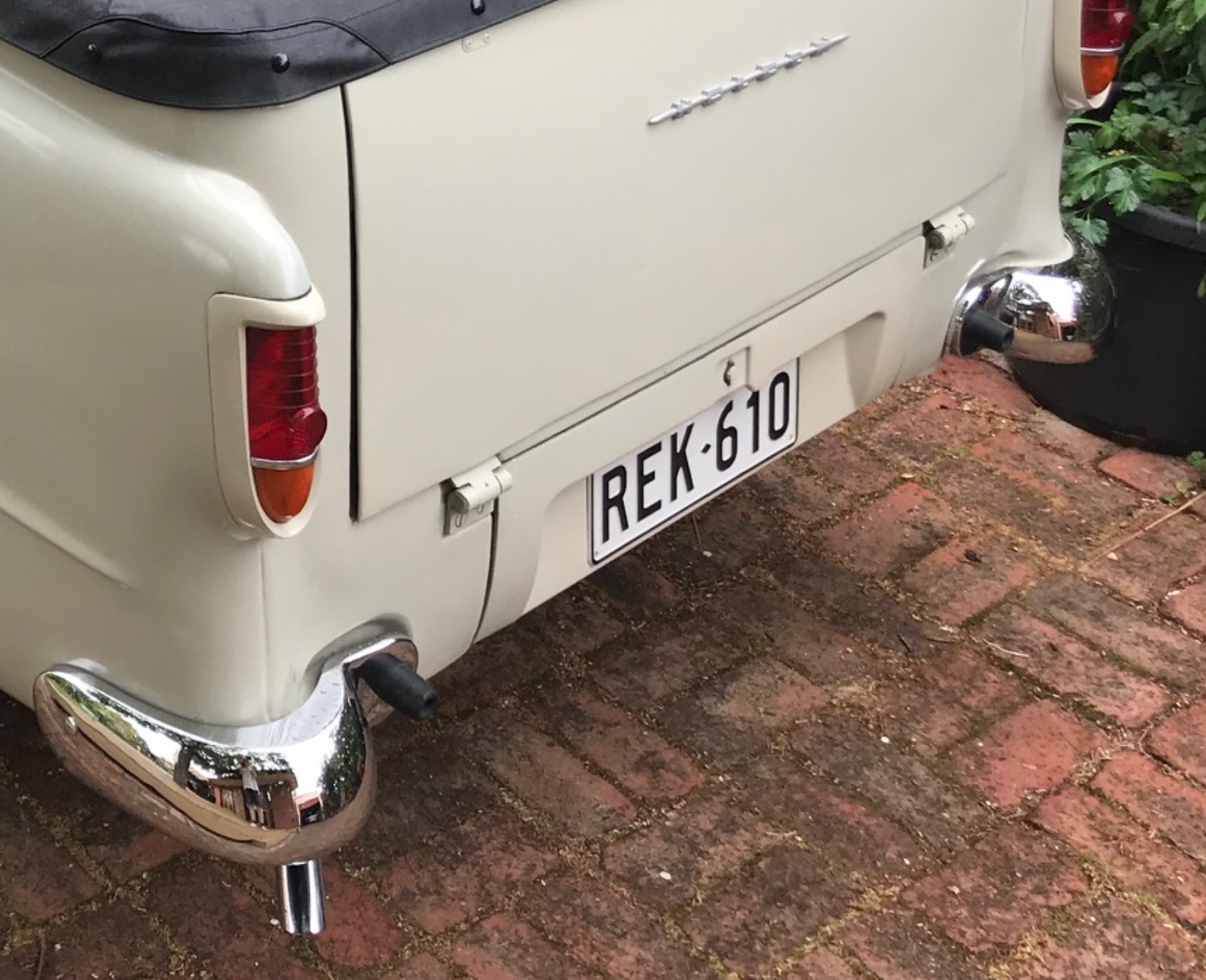

Nice work Clay ... where did you get the bumper rubber stopper bolts from? thanks Patrick

Reused original Patrick. Others have got coach head in stainless and buffed up. I was lucky and saved a couple from between this car, my van and Stephen and I ratted a rusty old Ute over our way.
Posts: 11303
All original bar the rubbers from better auto rubbers and nos bolts to suit from John Rayner at Lismore.
Posts: 2215
62ekute wrote: Fri Jun 05, 2020 6:57 pm Nice work Clay ... where did you get the bumper rubber stopper bolts from? thanks Patrick
Hey Patrick
I just used couple hex head bolts (painted heads black) and some black rubber door stops from Bunnings. The door stops come in different sizes. The ones in this pic are probably a bit too big, one day I'll fit the next size down that have been in the glove box for 2+ yeas :roll:
Posts: 11303
62ekute wrote:Nice work Clay ... where did you get the bumper rubber stopper bolts from? thanks Patrick
https://www.gumtree.com.au/s-ad/lismore ... pasteboard
