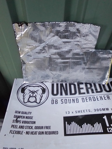

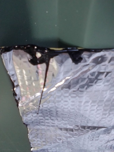

Hi Clay - I see your sound mat is heat rated to 130 degrees so should be okay. :thumbsup:
I was asking because I've got some stuff in the Sprinter that's been interesting. In my air compressor box under the van it has fallen off the upper surface and in some storage areas in the van (eg. under seat), the black stuff runs and sticks to my sandwich bags of spare parts. These places aren't above the exhaust.
I might have to grab some of the heat rated stuff - I had been thinking of some of this deadening with masonite between it and the headlining.
Patrick
Here's the left overs in the shed...the corner with the runny stuff was in the box, closest to the shed wall
