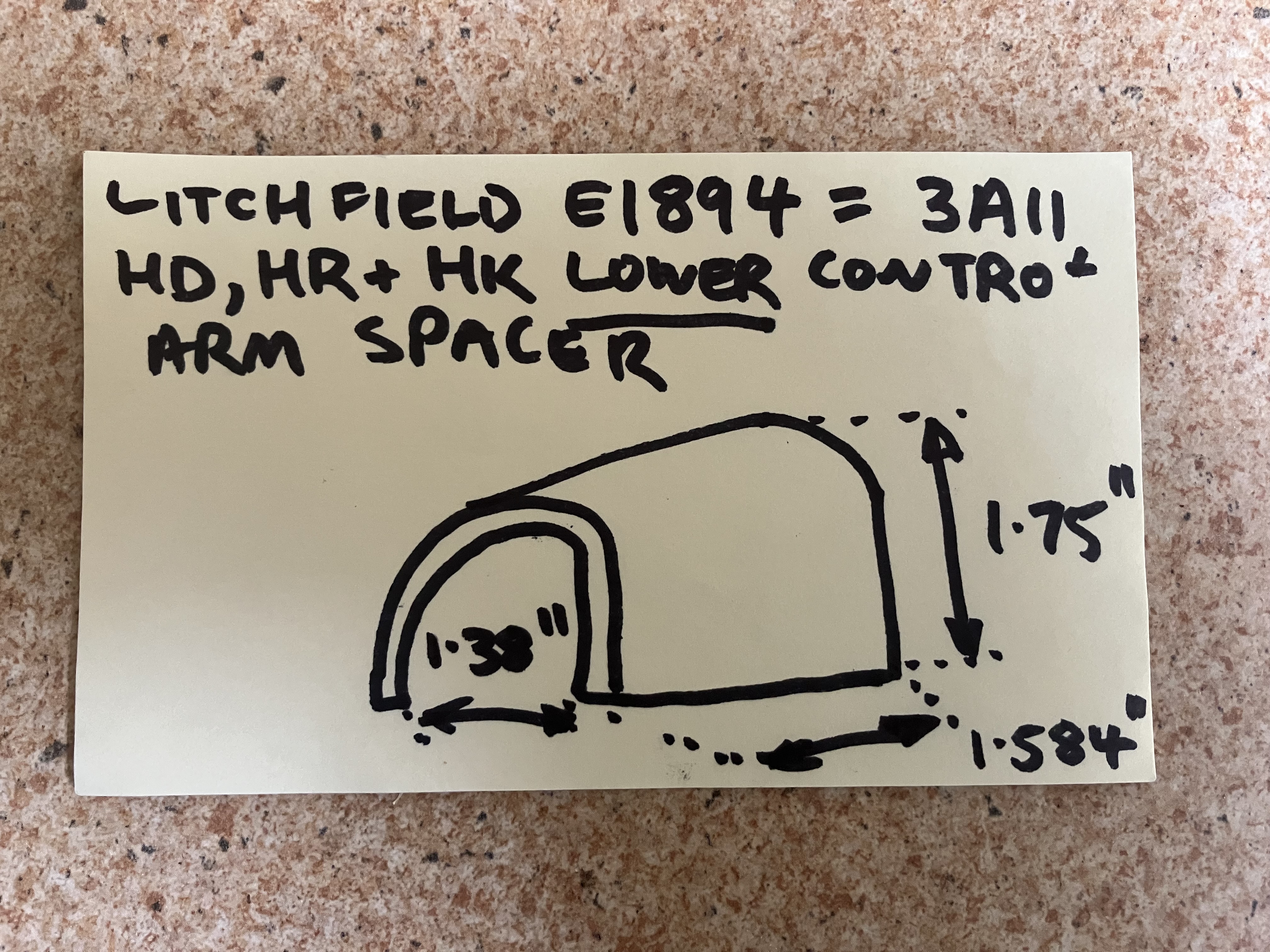

Thought I had upper and lower spacers, but can only find the lower one.

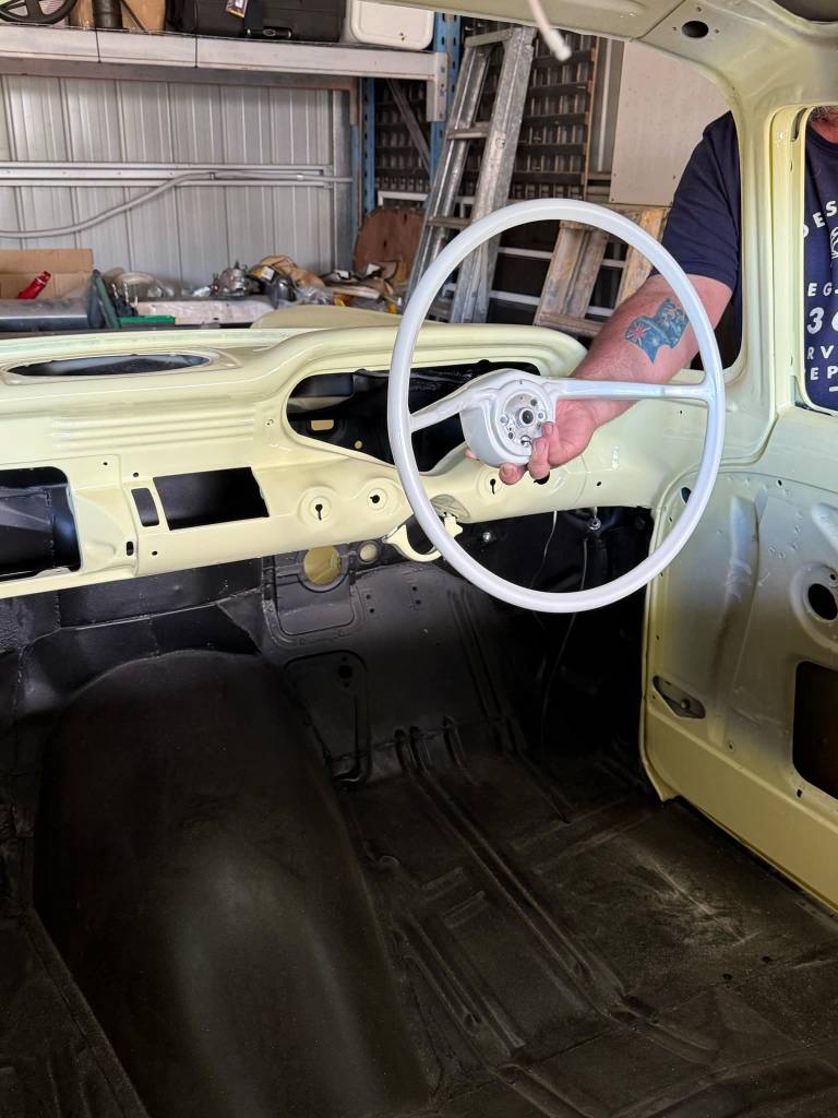

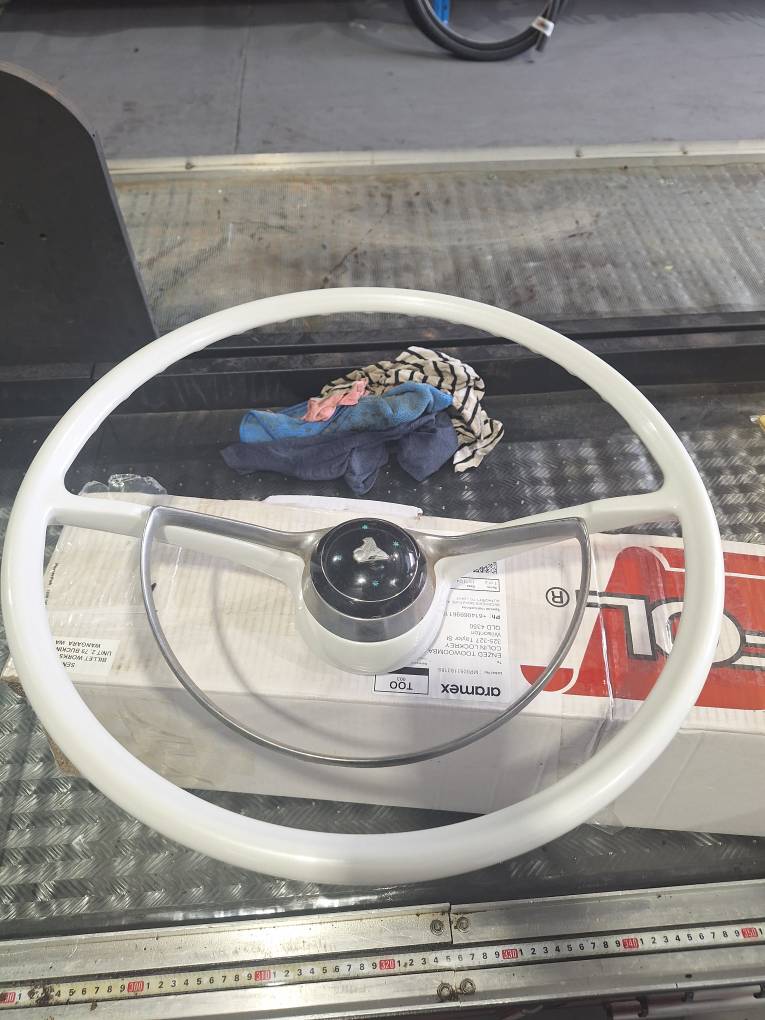

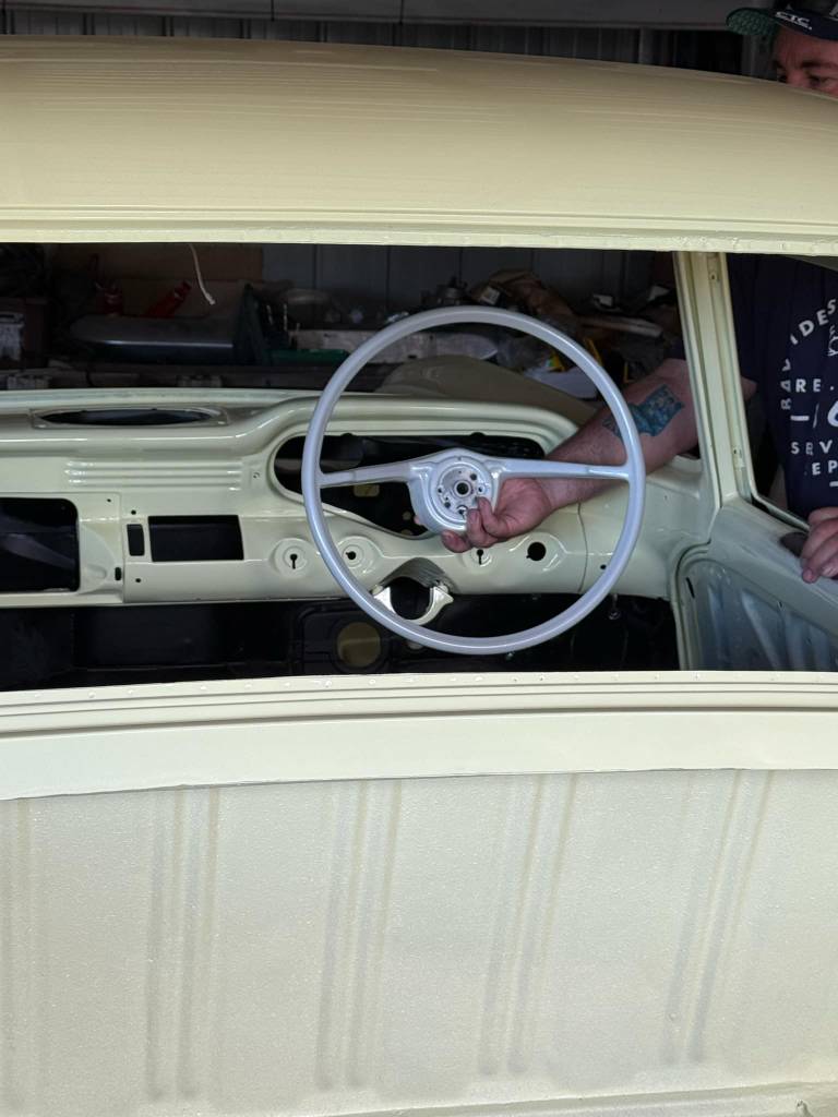

Recieved the billet collapsible column and steering wheel back from billet works in WA super impressed with there service and product. We sent the steering wheel to them as well they have a guy that restores them . He did a cracker of a job the wheel was pretty far gone had pieces missing from the boss and heaps of cracks . As much as I despise white interior cars we went with land cruiser pearl white finish to break up the interior a bit , I think it should work well.

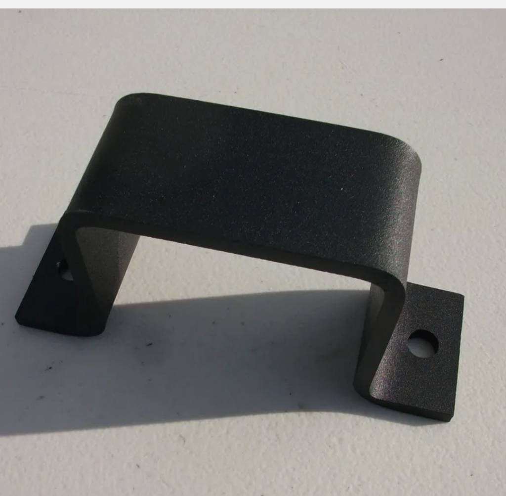

Today was frustrating, we took so much time bagging bolt and labelling and so on and still can't find parts !! Missing the out rigger bracket now ! Would anyone have one there happy to part with at all before I make one up ?

I will most likely have one here Sneezy if you cant find one locally

Thanks mate I got a hold of one.

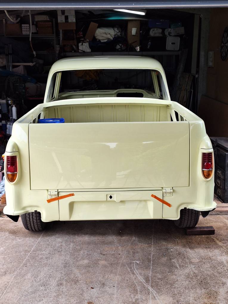

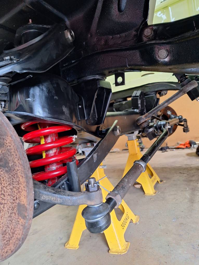

Well we finally have progress! Front end is back in and almost made new again wheel bearings and rotors arrived yesterday won't be far of having that part ticked of . One small step at a time.
I had to put the new tail lights in looks much better now when ya open the roller door haha.

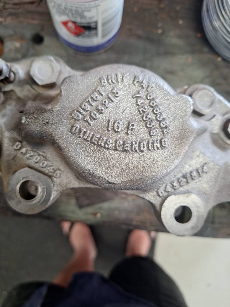

Hi all

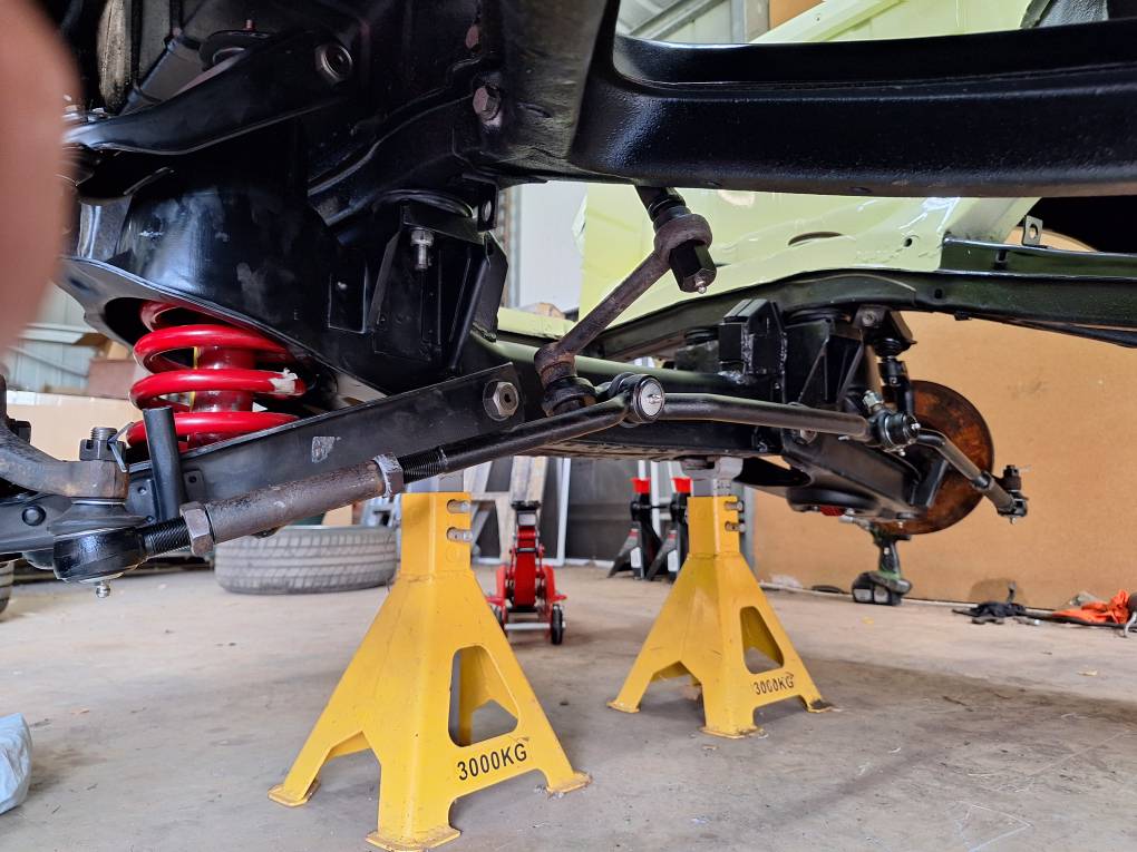

Wondering if anyone can help identify the callipers so I can get a rebuild kit ? Hr disc frond end if that helps ?

Posted: Sat Feb 08, 2025 3:41 pm
Genuine HR disc caliper for sure.
9” is overkill though relatively accessible. They are big and heavy. Shortened Borg Warner are easily capable of handling abuse. Banjo are easy but getting scarcer and dearer. They handle sensible use well in a lighter car such as FB EK.

Posted: Sat Feb 08, 2025 7:50 pm
Agree with Clay re the caliper.
What engine are you running ? A 9" is overkill unless you are planning on a 400+hp donk and sticky tyres

186 out to a 192 , star fire rods extensive head work and tripple webbers with a celica 5 speed . The car won't be driven stupid so will probably just stay with the banjo.
