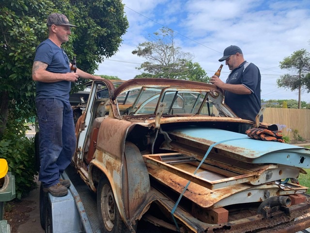

Well it’s been awhile since updating this post but it has a been a very busy week or so.
I met a guy named Jeff who is on this forum but he doesn’t visit often, he had a couple of bits I needed on a wreck.
Last Sunday I went down to have a pick over it to learn that his plans were to send the wreck to sims metal after I took what I wanted off it.
Pretty much said that I should be happy to act as Sims and take the wreck off him as it had so many parts that I wanted It would be just easier to do it at my house in my own time.
Considering the wreck was a roller I just went and got a trailer and took it home with me all for the cost of a slab of piss.
It has been a blesssing in disguise and I have been kissed on the dick by a an angel as it has so may parts that are actually better than what I currently have!

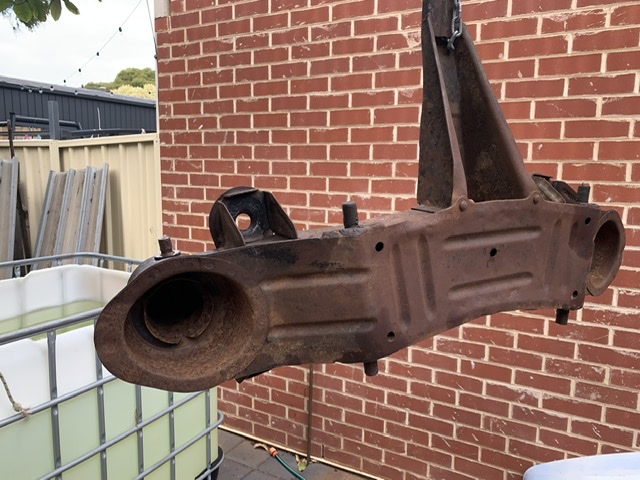

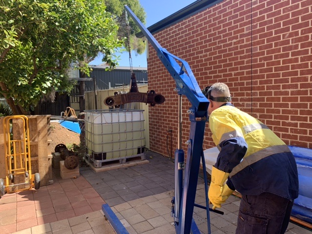

So once I had that ratty old beast home I concentrated on a executing a long term plan of building a citric acid bath for the bigger underbody components like frame, wish bones, y frame and diff housing.
I am fully de rusting, neutralising with baking sofa and the coating with penetrol all components that I can fit in the bath.
The chosen bath is a 1000ltr IBC container filled with 800ltrs of water mixed with 40 kgs of citric acid granuals.
This makes a 5% citric acid solution that works well over 24 hrs.
I pressure clean off when the components a are pulled from the bath and Ineutralise the acid with a water and baking sofa mix.
A couple of hand fulls of baking soda in a bucket of water is plenty accorto my chemist mate.
I then dry the component with my map gas torch, which works much better then imagined.
When dry I Coat with penetrol and the components come up really quite amazing with a bare metal look.

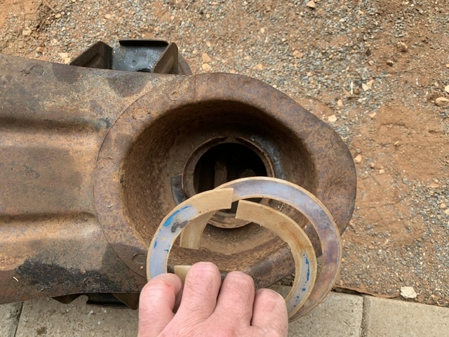

One thing that had me surprised was that nylon Spacer’s were on top of the front coil springs.
The spacers are only 2-3mm thick with 2 spacers over the drIvers aide spring and only 1 spacer over the passenger side spring.
What is you experience with these nylon spacers?

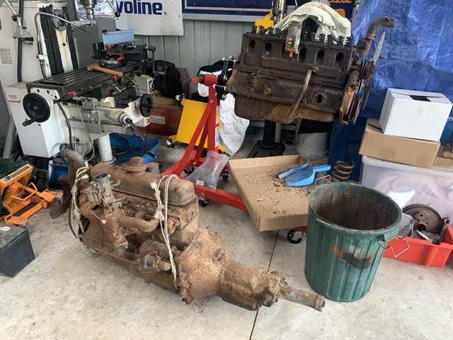

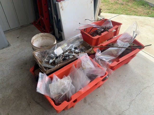

So it’s been a while since I have given an update but the work has been pretty steady.
Spent some time stripping the wreck, having a spare of all the mechanicals has made me feel better about making something work successfully
All the parts I have been removing are all bagged and tagged for easy identification later on

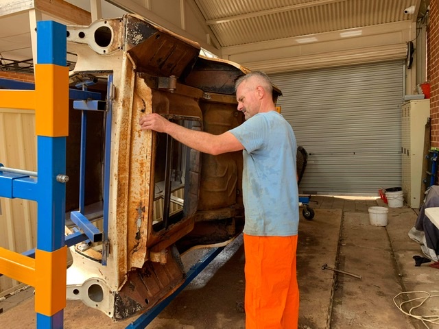

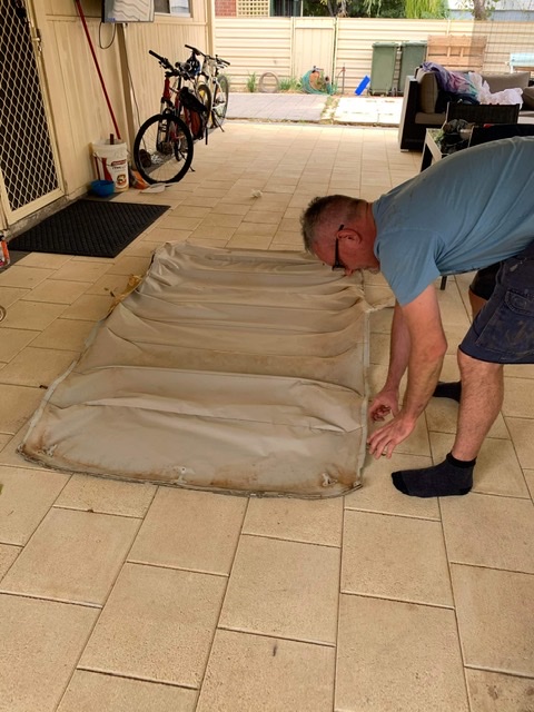

I moved ahead with removing the rest of the interior.
Originally my idea was to leave it in there but there is no way I could clean the body properly with out removing it.
Everyone said the roof lining would fall apart but it has held together. I hope to repair it a bit, clean it and refit it.

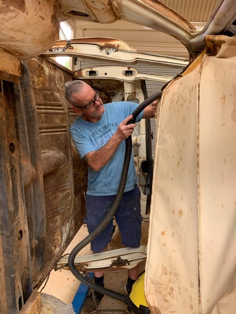

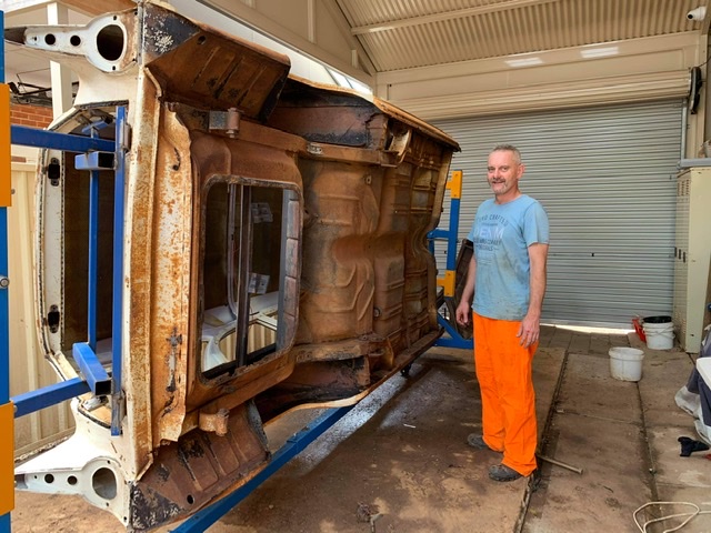

Re: FB Standard Wagon

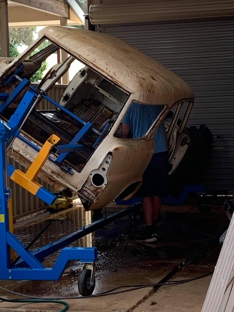

I then went bonkers with the high pressure Karcher and gave it a good blast.
Drilled some holes to access the sills and chassis for a clean out, gold I did as everything was full of dirt.
A good couple of cleaning sessions got it to a point where I could really see what the body was like.
Still pretty good but yes a bit more rust to fix

I reused the headlining in my sedan with considerable success. Used a donor lining to patch up a few torn bits, mainly C pillar bottoms where the rear seat back had come in and out too many times. Main issue I found is that the material that the wire bows go through tends to rot.
