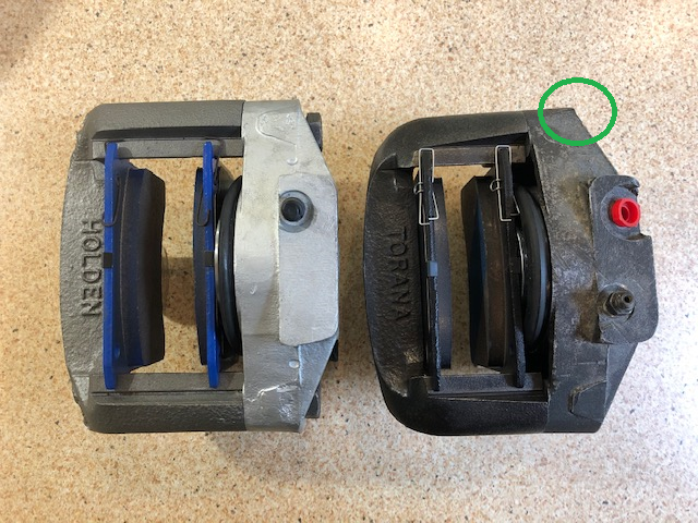

I then got curious about the Torana calipers that Rob donated to the cause. Would they give me more clearance? Sadly, no. The cast ally caliper body is near identical to the HX-HZ caliper, so no better in clearance for the kingpin. Clearance for the wheels is no better either - the part that clashes (circled in green below) has the same clearance to the rim.
Torana versus HZ calipers.png (598.67 KiB) Viewed 3198 times
Worse still, the HX-HZ units will retract to allow a 1.1” thick rotor. The 0.95” rotors used in the kit are a good fit. The Torana calipers, when fitted with new Bendix pads, will only retract 0.7”, and hence cannot be used with this rotor without fitting slimmer/worn pads. Approximately 1/8” would need to be removed from each Torana Bendix pad… this is 60% of the usable pad thickness. So all up, the Torana calipers will fit no better than HX-HZ, but will need the pads modified at each pad change in order to work.

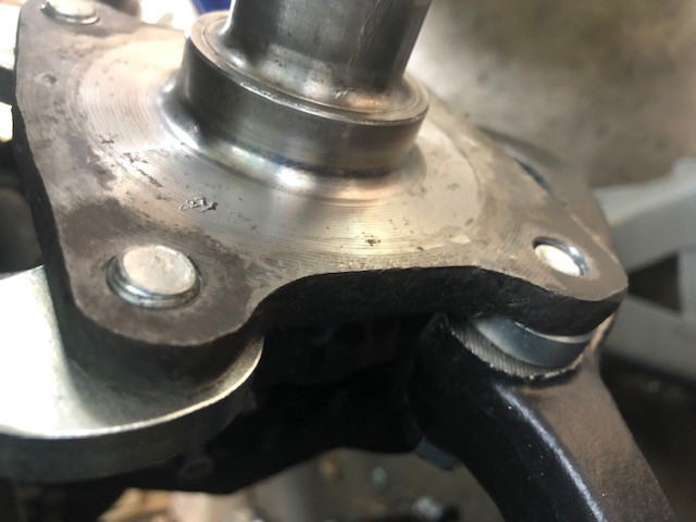

With the EJ-HD steering arms nicely machined back (with thanks Greg - nicely done), it was time for a fit-and-fiddle.
Put the arms on, and sadly still have clash. It's hard to measure, as it is a round edge (steering arm leading edge) swinging in an arc and hitting another round edge (control arm outer edge).
Option A: skim down the caliper bracket. Played around with some washers, and I would need to cut the bracket down so it is only 3.5mm thick. That's less than half the 8mm bracket thickness. Probably not a good idea.
Option B: "massage" the control arm. Suspect this is the only option. Back to the engineer to discuss.

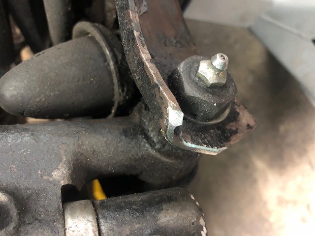

With a green light from the engineer to modify the control arms, I ducked under the FB with grinder in hand. A gentle kiss of the control arm outer corners, both front and rear:
FB control arms clearanced.jpg (67.82 KiB) Viewed 3060 times
Voila! The adaptors now fit without the steering arms hitting the control arms (nods to Greg, with thanks again for milling the steering arms). Removed the dodgy temporary bolts, drilled and tapped the four steering knuckle holes, and bolted up the adaptors, spacer and steering arms. All good, but one bolt 1/4" too short... needs a few threads to protrude to keep the engineer happy. Two 7/12-20x2" Grade 8 bolts to buy.

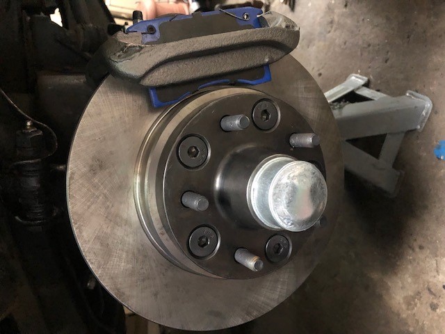

Bolted up the rotors and calipers, and other than some missing wheel bearing washers (see Parts Wanted post) all is looking pretty sexy:
FB whopper stoppers.jpg (71.12 KiB) Viewed 3060 times

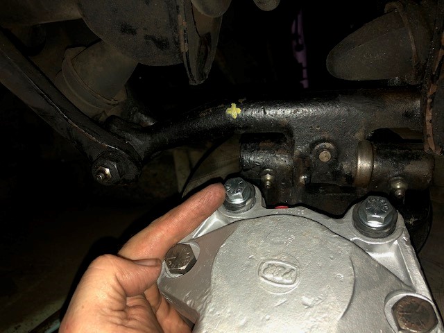

Quick check shows clearances look OK, except for the upper caliper mounting bolt (the one my finger is on in the photo below). It comes very close to hitting the kingpin on full lock (where the yellow cross is on the photo). Misses, but not by much. Will swap out for allan-head cap screws a'la Torana (thought that the cap screws that came with Rob's Torana calipers might have worked, but alas too short). Two 7/6-20 UNFx3" cap screws to buy.
FB kingpin clash.jpg (74.09 KiB) Viewed 3060 times
Need to do some more thinking about the hose connection and bleed screw. The hose connection faces in to the kingpin, and is tight for space. You can just see the red plastic plug in the photo above. Maybe a 90-degree pipe adaptor needed. The bleed screw is up on the outside of the caliper... wonder if I can swap out the bleed screw and hose connections? Would make bleeding hard, but not insurmountable (undo caliper, rotate on rotor so bleed screw uppermmost, bleed, rotate back and bolt caliper back on). Hmmmm.... more thinking to do.

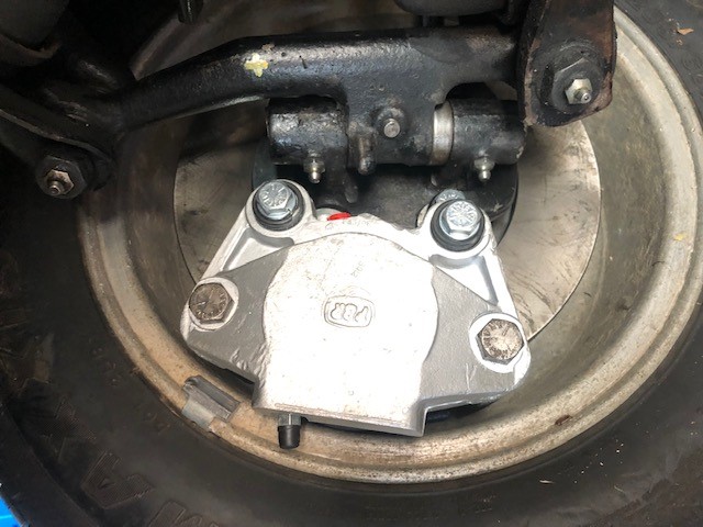

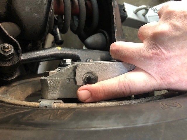

Calipers are close to the 2 o'clock position.
I think I will be OK with the hoses on the outer - I have a fat-finger clearance to the rim, and the calipers sit outside the rim (mostly).
Perhaps 90-degree elbows or banjo bolts. The drilling idea sounds like a plan though.

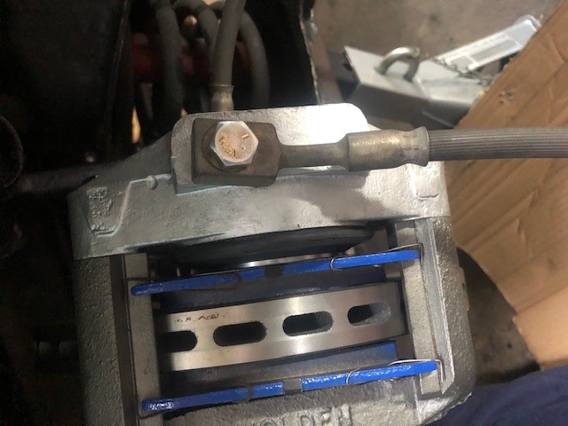

Kidding. Used the hoses for mockup though. There is room to get the banjo between the caliper and steering knuckle:
HXZ alloy caliper with VNS hose.jpg (63.37 KiB) Viewed 2999 times

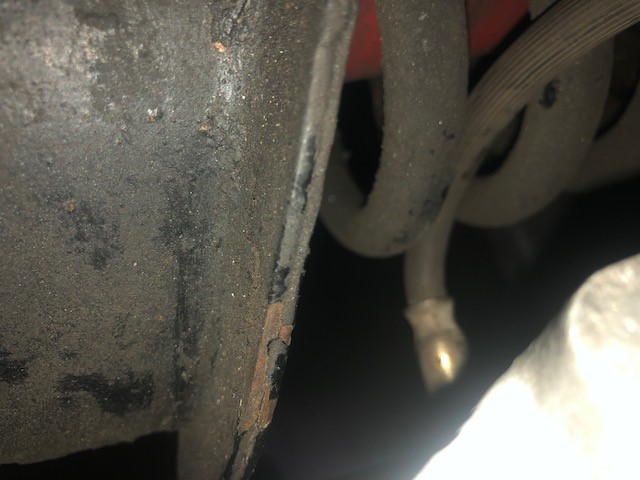

But sadly, at full lock the hoses point straight into the springs:

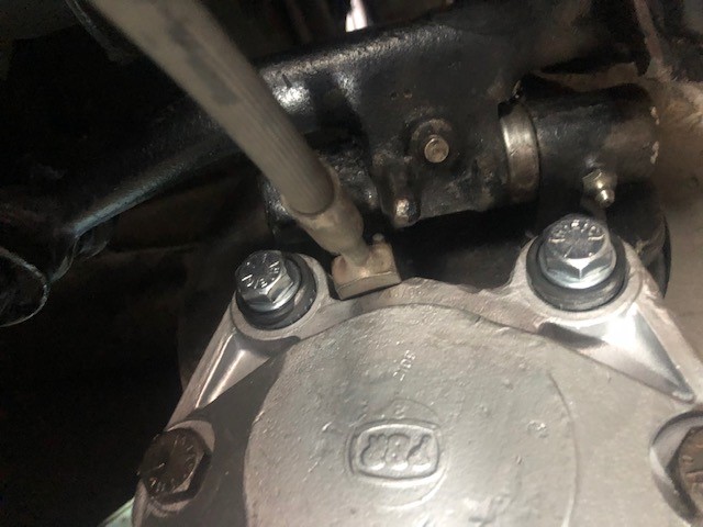

HXZ alloy caliper with VNS hose clash at coil.jpg (65.57 KiB) Viewed 2999 times
The hose needs to go on the front bleed point instead of the bleeder valve. It will need to point "down" though, otherwise at full lock the hose again points into the coil:
HXZ alloy caliper with VNS hose at bleed screw.jpg (69.3 KiB) Viewed 2999 times

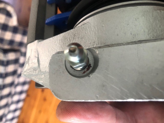

The VN-VS hoses have an allignment roll pin that stop them from rotating. Handy. The bleed screw is supposed to seal on the cone seat at the bottom of the hole. No good for a banjo bolt. It does have a suspicious round flat on top though... maybe a thick annealed copper washer in the flat to seal the banjo bolt. Would save me having a bigger flat milled.
HXZ alloy caliper bleed screw flats.jpg (59.31 KiB) Viewed 2999 times
VN-VS hoses are a bit short, and are metric on the other end too (along with being a ball flare). Looks like I need to get a VN-VS hose made, bit longer, UNF thread on the non-caliper end. Should be easy enough for Burt Brothers once lockdown ends.
