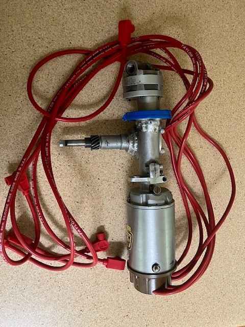

Picked up the angle drive from the machinist. It now drives both a magneto and the McGee pump (that pump is mighty tight to the engine plate, but fits).
Angle drive.jpg (130.84 KiB) Viewed 3441 times

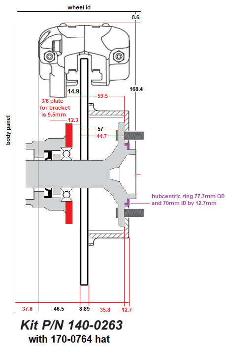

Some Googling through the Wilwood online catalogue shows a rear-wheel drag race brake kit that is a close match to what I need (140-0263), but the rotor hat has too much offset (pushes the brakes inboard too far). Changing out the hat to another one looks like a winner. Lots of cut-and-paste of Wilwood images with MS Paint and some calculations gives this:
Brakes dimensions.png (59 KiB) Viewed 3294 times

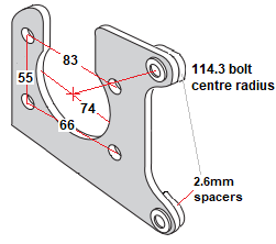

Looks like it will work. There is some room for brackets, made from 3/8 ally plate (probably 6061). Wilwood use clinch nuts for the fasteners on their brackets, but I suspect that I will need to use countersunk bolts instead.
brakes brackets.png (13.85 KiB) Viewed 3294 times
