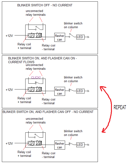

Voltage is a constant where as current is a variable depending on what is being drawn eg light wattage etc.
A 12 relay coil must be wired plus to minus or vice versa depending on what you are using as a supply or switch.
When you measure current it must be done in series and when you measure voltage it is done in parallel.
So when you say the supply feed is straight from the fuse there is no switching as such because its constant. When you measure in series you are measuring the current drawn by the globes and flasher can and this is in amps (giving the illusion it is going on and off) but your voltage remains constant.
So back to my initial comment the relay needs a ground and Switched supply voltage from the flasher can or blinker wire to operate.

Here's how I reckon it will work, without providing an earth to the relay (just run it in series in the power supply line)... I could be wrong though.

Yes you are right it will work this way alright. Its a bit like the Christmas tree lights of yesteryear in series, with the relay still going to ground just that its completing a circuit with all the other gear.
I know its probably not going to effect anything cause the current is probably very small in the relay anyway I'm just old school and prefer to have everything turn off and on by a separate trigger.(just my opinion).

You two have gone well over my head now.... but, if I get this correct -the relay is finding earth to energise the coil through the LED's....
I do know that positive will flow one way through a diode - and the opposite way in reverse polarity - is this how the relay is getting earth?
- by the positive going through the diode to power the LED - and negative feed back coming back the other way to provide earth to the relay?
Re: harvs ek 327 wagon
Posted: Fri Oct 13, 2017 9:56 am
I'm no sparky, and can only think of power like water flowing. My mind struggles with anything other than simple DC... the fancy electrical stuff I once knew has long been dissolved in ethanol :mrgreen: .
The relay is really just a glorified electromagnet. It needs current to flow through its curly curly windings to generate a magnetic field. The electromagnet pulls the relay switch shut, and gives me my clicky noise. I use the battery voltage (pressure) to push current (flow) into the relay via one end of the electromagnet. The current flows through the curly curly windings, and comes out the other end of the relay. It then flows through the flasher can. There is electrical sorcery inside that flasher can that sometimes makes the current flow, and sometimes dams it up. I've got no idea how that sorcery works, but suspect it involves Magic Smoke. If the flasher can sorcery decides to dam the current up, no current can flow and my electromagnet stops working. When the flasher sorcery decides to let current flow, it flows out of the flasher can, through the blinker switch (only if it is shut), through the LED into the LED earth connection then back to the battery. The LED is like a non-return valve, but performs no one-way function in this circuit... all the current is trying to flow one way all by itself.

got all that. What I was asking though - was if there was opposite pole backfeed through the LED (diodes) which gave the relay connection to earth to enable the coil to energise..... my suspicion is that this is the case.
Likewise, I find DC a lot easier to understand.... far too much backwards and forwards without actually going anywhere in AC for me.... very much like the string of steel balls.... you bounce one in at one end of the string - and one pops out the other end - no matter how many hundreds of miles of steel balls there are in the row.... and we need a minimum of two lines of these balls going in opposite directions at the same time - each time they change direction... I suppose, best put in our application - with an alternator, I understand the DC output bit - I don't have a good grip on the unrectified AC bit that comes off the stator/rotor.
DC is simply making connection from one side of your battery to the other - they are madly in love - the more robust the communication, the more intense this passion becomes....
Like your water analygy - if we refer to the use of a water pipe - voltage is the speed of the water going through it (pressure) - amperage relates to the volume of water which can pass through the pipe at that speed - as the diameter increases, so too does the volume...... and watts is the force it ultimately can produce when it comes out the pipe (power).....that's how it was put to me in simple terms.

Tried my extra relay to get the indicators to go Click!. Works awesome... except that the new Tridon relay is too quiet (can't hear the clicking). Might have to find a louder relay.
