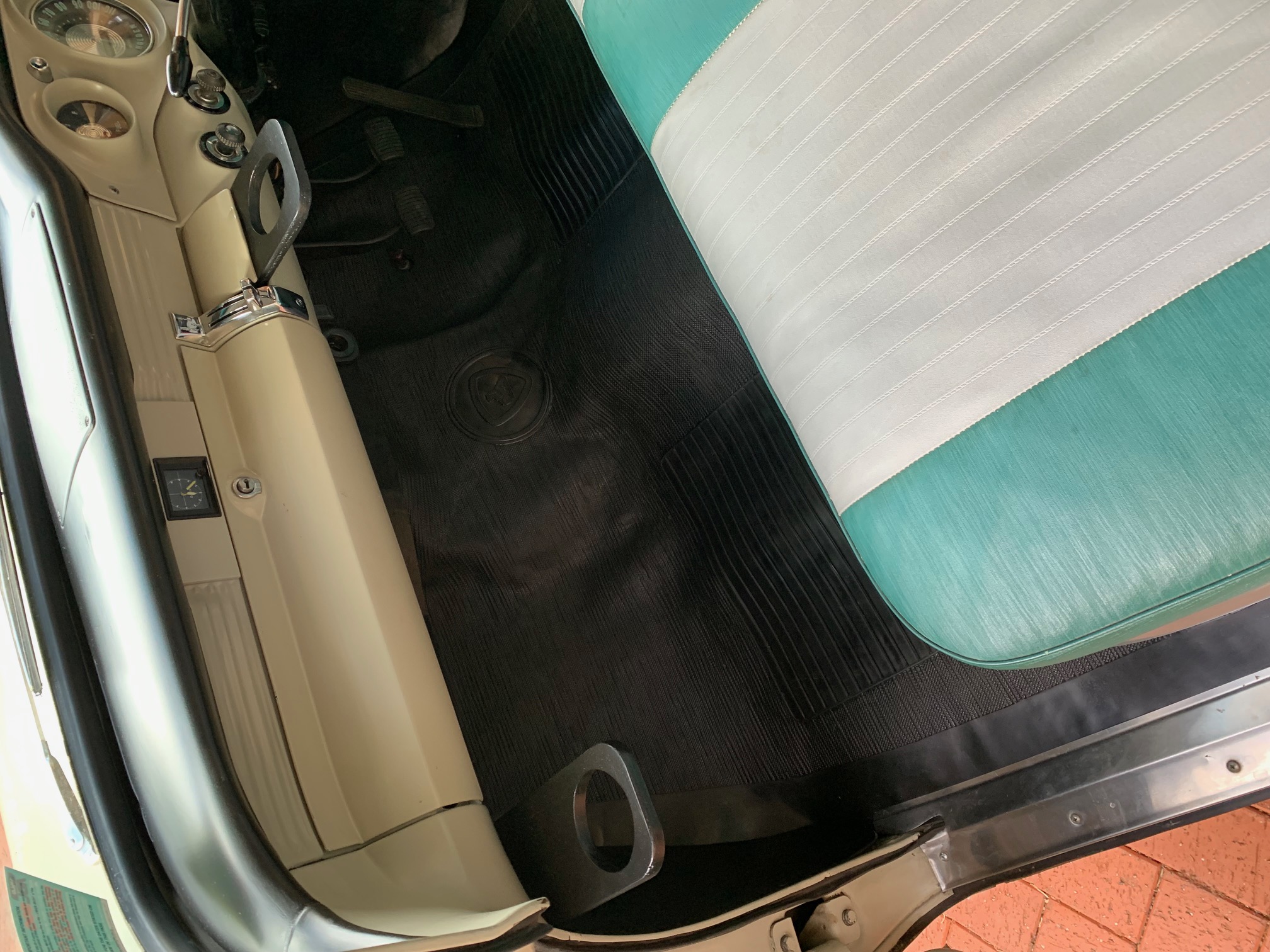

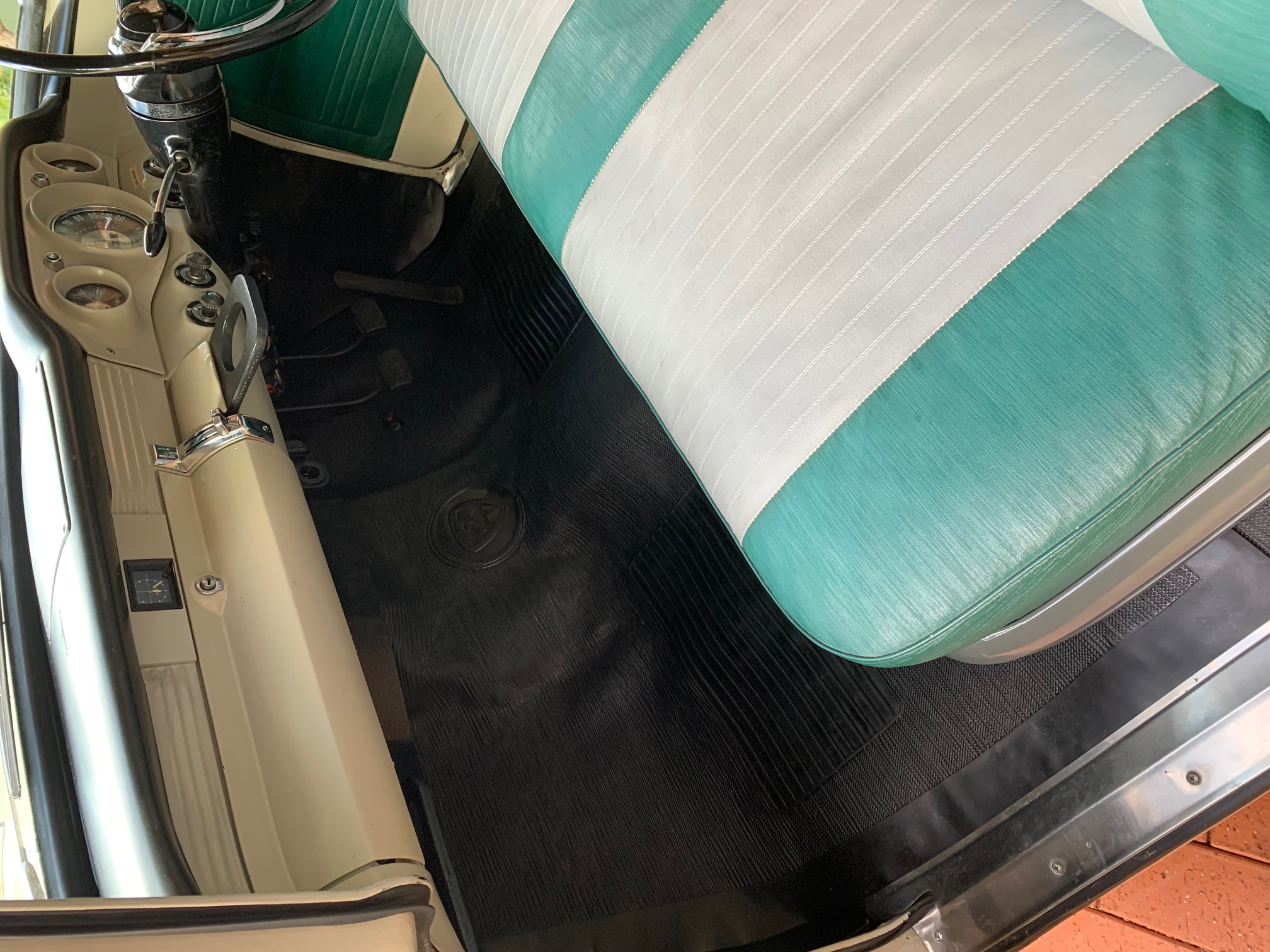

Finally got around to removing the carpet and putting the rubber floor mat in that arrived a week after the 2022 Nats 😁 Very happy with the rubber mat and how it looks. Will be easier to keep clean too.
Refitted the firewall panel, after having to disconnect the heater hoses as I forgot the heater pipes go through the panel. Swapped over the heater surround and knobs as they were rechromed.
Also fitted another shutoff valve to the cylinder head for the heater. I discovered even with the one water control valve (operated by internal control) shut the air flowing into the car was slightly warm.
