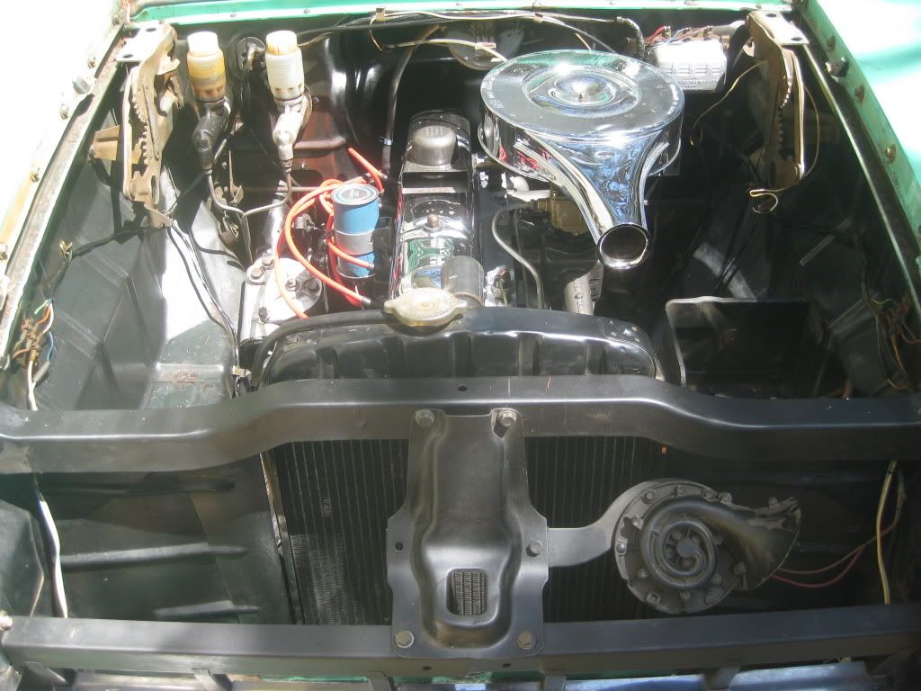

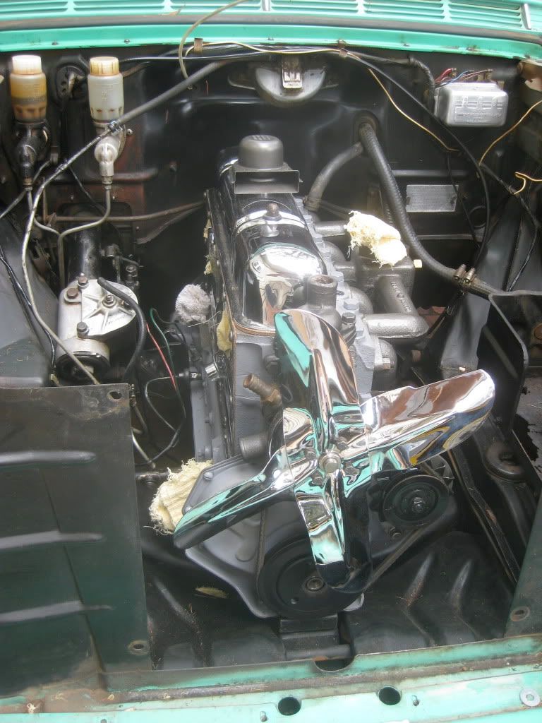

Thanks Trev, I will be back trying to start it up first thing in the morning. Hopefully I will have a result by the arvo....fingers crossed :oops:
She is starting to look the part, now its just a matter of getting her movin! :D

what is your colour called there ados???

Jim I Think the colour is REEF GREEN. Code on my ID plate reads 585-9903

looks very very 8)
