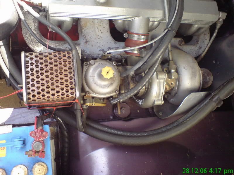

Here it is guys, plans initially to run twin strombergs and genie extractors, but i've since sourced a complete Strata II Turbo kit,
it wont be in and running for a while, but never the less it sould be an interesting combo, once its up and running i will start planning with some water injection.
if anybody has any information on the turbo kit or injection i would love to hear about it (i do know what i'm getting into as i have a fair bit of knowledge to start with)

hey mate that looks like a nice kit there, nice and not so obvious to the unsespecting eye. How much does a kit like this with the lot set u back? 8)

these turbo kits are generally around $1500-$2500 if you can get a complete kit!
generally you have to source all the parts seperately, i've ended up with a spare exhaust manifold, carby (SU) and carby to turbo adapter, but i think in the end its worth it!
i wont be driving my car everyday, so its only for a little bit of extra fun!
i recommend, learning as much as you can about the strata kits before deciding if you want to go that road as they can cause problems like any turbo setup!

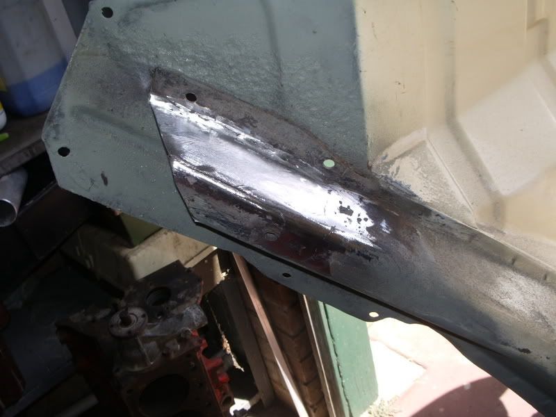

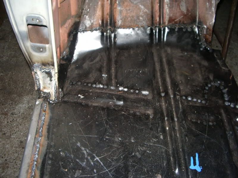

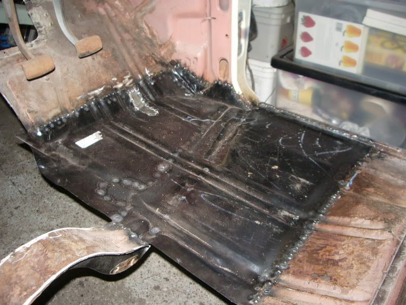

Update IV - Rust Repairs
Post by NoMAD »
Got started on some rust this weekend, the old man scored a welder for a brief period so this was the only sane thing to do was put him to work with it
Still need to grind the welds back and clean it all up - but you get the idea!
Drivers Side -
Passengers Side -
Front Clip Passenger Top Rail -
And the next task to tackle - previous repairs of dodgy welding & bog, going to get this blasted so we know what we are dealing with -

Good stuff, boy does that bring back some fun times :shock: :roll:
Still well worth doing and nice use of available help and tools :lol:

Post by NoMAD »
Cheers DR,
it will be good when this side of things is done!
also if anyone can supply a rust free healthy section of this piece of guard i would be greatly appreciative!
here it is again (even though its just above)
perferably in Perth (dont want to pay to much) - but if someone over east wants to give me one i'll happily pay for postage! :D just pm me and let me know and i'll give you my email for a couple of photos - actually now that i think about it if anybody has inner guard sections that can be cut up to form this area also that may work, just let me know :wink:
