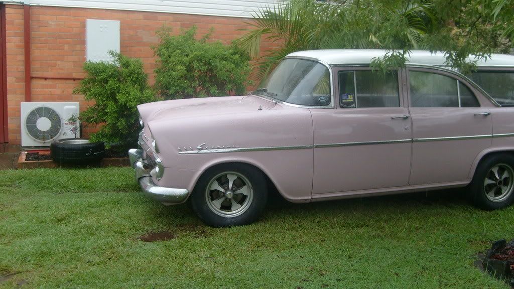

Sorry J,
I too have suffered from the I'm not sure factor.
My Sedan runs standard king pin front end. I run 2 1/2 inch lowered heavy duty front King springs. It seems to have a nice ride and no bump steer which can be a problem on uneven roads. It is as low as I would want it to be. I have also reset my rear leaf springs to 2 inches lower than standard and don't think I need to go lower. OH! I run 14 inch rims as well, So I can run with the Caddy caps.
