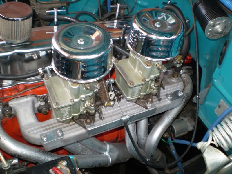

Trev wrote: If you mean this? I'm pretty sure it's out of a L300 van, Trev 8) .
thanks trev
still using the same cable setup, but have changed over to an x2 manifold with twin strommys 8) 8)
just purchased a few bits n pieces from speco to make this work, ie: cable holders - inner/outer, ball joint & a throttle lever
& had a bracket made up
im confident you could addapt the L300 cable, to almost any carb/manifold setup :wink:

Looks cool as Ray 8) I know you were looking for a more period look under the bonnet with the carby setup, you certainly nailed it!. So how does she run now? any more power etc?
You won't be late with a 138!
MINT62
Posts: 840
Location: South Oz
Post by MINT62 »
cheers mate
yea happy with the overall look and feel of the new setup 8) :D
they sound great when you open em up, a real "throaty note" :twisted:
runs good, bit rich
just need them fine tuned to the motor, & dyno to see any hp increase :wink:

not too sure if fe/c's are the same, but you should be able to adapt this setup
from a wreckers - you'll need a complete L300 cable (from pedal to carby) which will be shortened to suit - when fitted
its a bit hard to say without seeing your carby (pic) - to see whats in place already, but...
1st you'll need an inner cable holder - attaches throttle lever(carby) to inner cable
2nd youll need an outer cable holder - holds outer cable to a fixed point, usually a bracket etc attached to carby base (see pics)
3rd youll need a return spring or 2, & maybe a balljoint (see pic of my twin setup)
you can source the above parts thru stockists of speco & or redline carby bits :wink:
dont know if you can do away with the guide bit?, as it acts as a fixed point for the pedal end
dont know about unexpected problems, relitively basic setup - but you may need to extend pedal lever to gain full throttle :?:
make sure when you source your throttle cable its not freyed, kinked etc & moves freely
