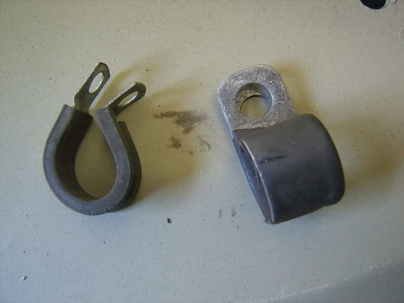

Sorry for the delay but these are the clips I was refering to

clips
Post by mattymartin »
hey terry
thanks for the info... i'll let the mechanic know as the engine gets taken out next monday & the car gets sent off to the panel shop for repairs & paint...
hey what are those clips called & where do i get them... can i see some pics of them on your car...
matty martin
go the wagons....
Posts: 13331
They are called "P" clips and you should be able to get them from Repco or an autosparky.

I've run the wires through the guards and run ducting/flexible conduit to protect it. I used the P-Clips as mentioned above to hold the cable in place - worked a treat. I used some longer bolts (which hold the guard in place) to allow a nut to fit on the end - which holds the P-Clip in place. They ain't going nowhere! Thanks for that tip.
