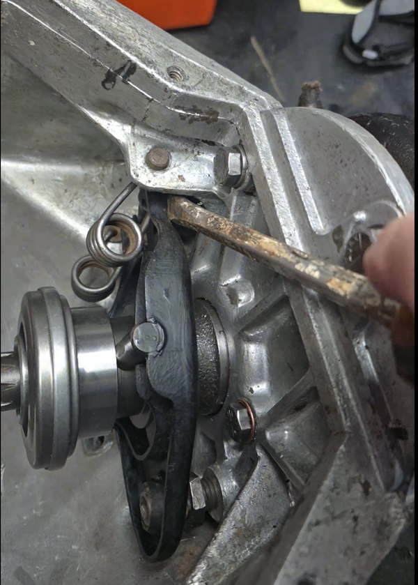

If your clutch lever assist spring pops out of the clutch fork when you go to actuate the clutch, I'm willing to guess that the "mouse-trap" part of the spring isn't correctly located behind the "dimple" for the slave cylinder pushrod, under the tabs in the clutch fork.
You may have to use a screwdriver and hammer to tap the "mouse-trap" part of the spring into place. Remove the slave cylinder before attempting to seat the assist spring in place. And beware stored energy. When the assist spring lets go, it really lets go.
Spring tension acts to hold the spring in place, but it needs to be in place first.

All my testing has been done purely on the bench just looking at the action as the lever is pushed forward.
By the sounds of it, all the right pieces are there, the spring is correctly orientated, so I will just go ahead and assemble it and see how it performs once I have everything connected.

Looking at the photos i posted i would have to agree with Rob, the tabs look like they are bent over the spring so it cant escape.
Its tough when you dont pull things apart yourself and you are left guessing i must admit.

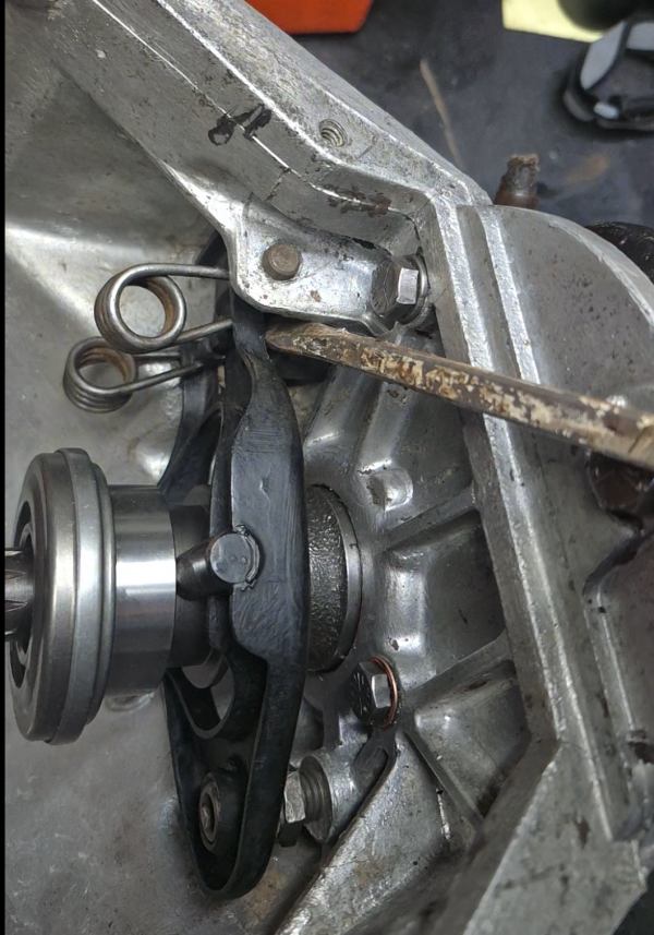

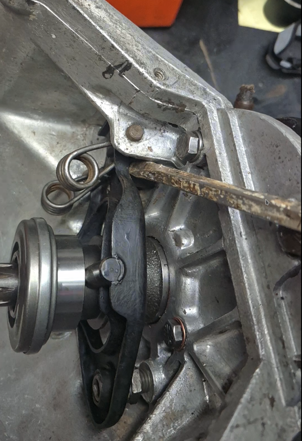

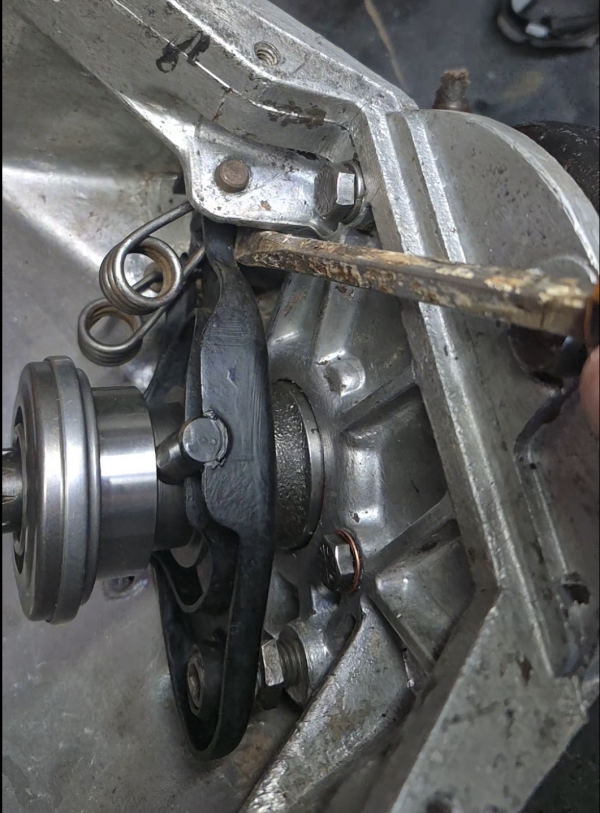

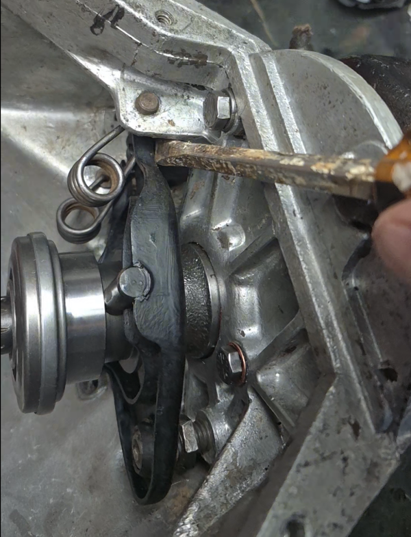

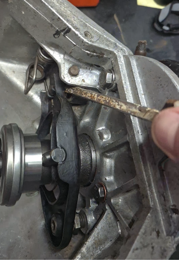

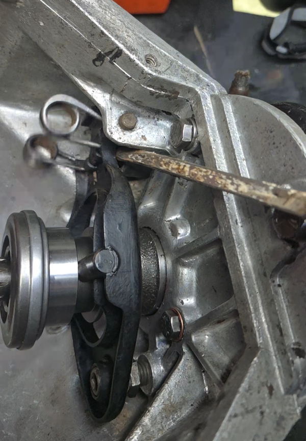

The actual issue is not the spring jumpting out of its holder on the "mouse trap" side, but the level pushing on the coils pivoting the spring around as soon as the lever moves. I took a slow motion video and screen shotted some frames to show the action below. You can see how little the front of the bearing moves before the spring snaps around.
The first pic is the resting position of the level on the front of the slave cylinder.

Can the pivot ball be screwed further into the bellhousing mate ? Looks like its out a few threads from where it could potentially go ???

Yes, possibly, I will actually fit the gearbox this weekend and set the gap, not sure how much this will change things though. I will do that and get back to you.
I did move it back to where it was when I took it out, the nut is just loose and brought forward, so gives the impression of it being further out than it is.

Spring is over extending.
3 to 5 mm of travel on a thrust bearing normally to disengage a clutch.
Ball will probably screw in more, measure the clutch fingers from the block and then transfer that to bellhousing to thrust, that will give you a ball park distance.

Your assist spring is, in fact, seated correctly in the clutch fork. All the parts are operating correctly. And yes, the assist spring coils are supposed to swing over a wide arc as the clutch is actuated.
As for the over-centre "sproing" and spring dropping out of the clutch fork, bear in mind that the diaphragm spring of the pressure plate pushes back hard against the throwout bearing, so the over-centre "runaway" effect won't happen. But to be doubly sure, you could bend the clutch fork's tabs over a little when the assist spring is installed.
I reckon you should be OK. But it'd be a pain in the rear to assemble the gearbox to the motor, try the clutch out and hear the dreaded "sproing".
If you don't have the adjusting tool, go buy a long-handle 3/8" Allen key and cut maybe 1/2" off the foot of the L. With the gearbox out of the car, you'll be able to test-fit the tool to make certain it fits.

Aweomse., thanks again, just what I wanted to hear. The whole mechanism does seem to be working right on the limit with not much tolerance. If they just made the fork sit further back in its home position, it would have given the fork alot more travel before moving the spring around. Live and learn I guess.
