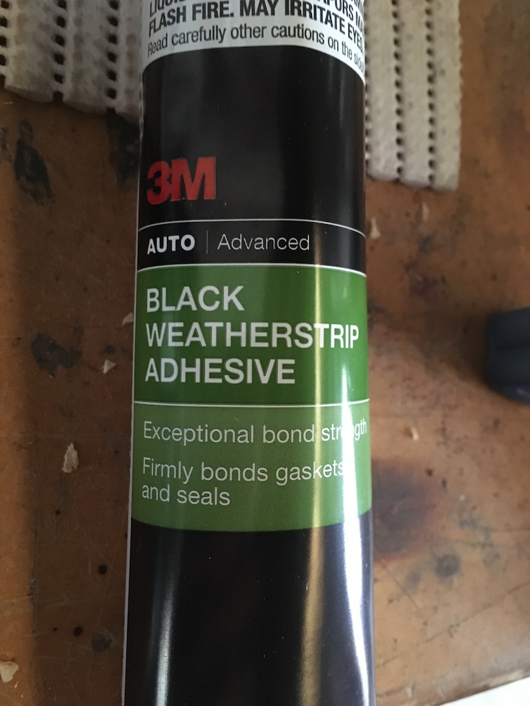

I have just bought some 3m super weatherstrip adhesive for my 1/4 vent seal and have noticed the superglue on the door rubbers have come off in some spots. Looks like another trial and error session in front of me ! I will trial the 3m glue and give a report after next week when i get it delivered.

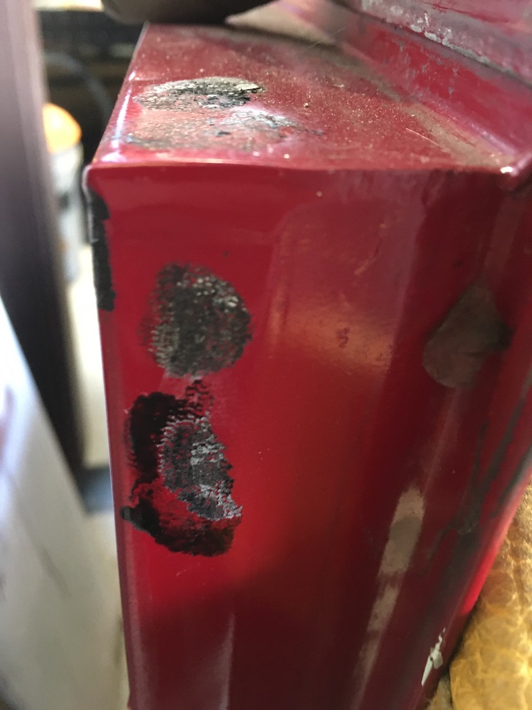

Hey Billy, I'm about to do door/boot rubbers on my Karmann Ghia. I have spent ages getting the old contact adhesive off. The engine bay rubber is impossible to remove as its hardened (I guess) with the heat of the engine.
Bought this stuff after loads of reading as I was not happy with contact adhesive. Wanted something stronger. After some testing I do NOT recommend this!
Essentially its rubberised superglue for sticking rubber to metal. I don't think there is any room for error with this stuff. You have about 5 seconds to reposition after initial contact is made. Once its stuck it stays stuck. Here's the residue left when I tested on the holden's door frame.
Tried to get the residue off but it will only come off along with the paint.
So now I have done some more research and found this.
Reads like its contact adhesive but black (and hopefully stronger). Going to give it a go on the weekend. Will let you know.

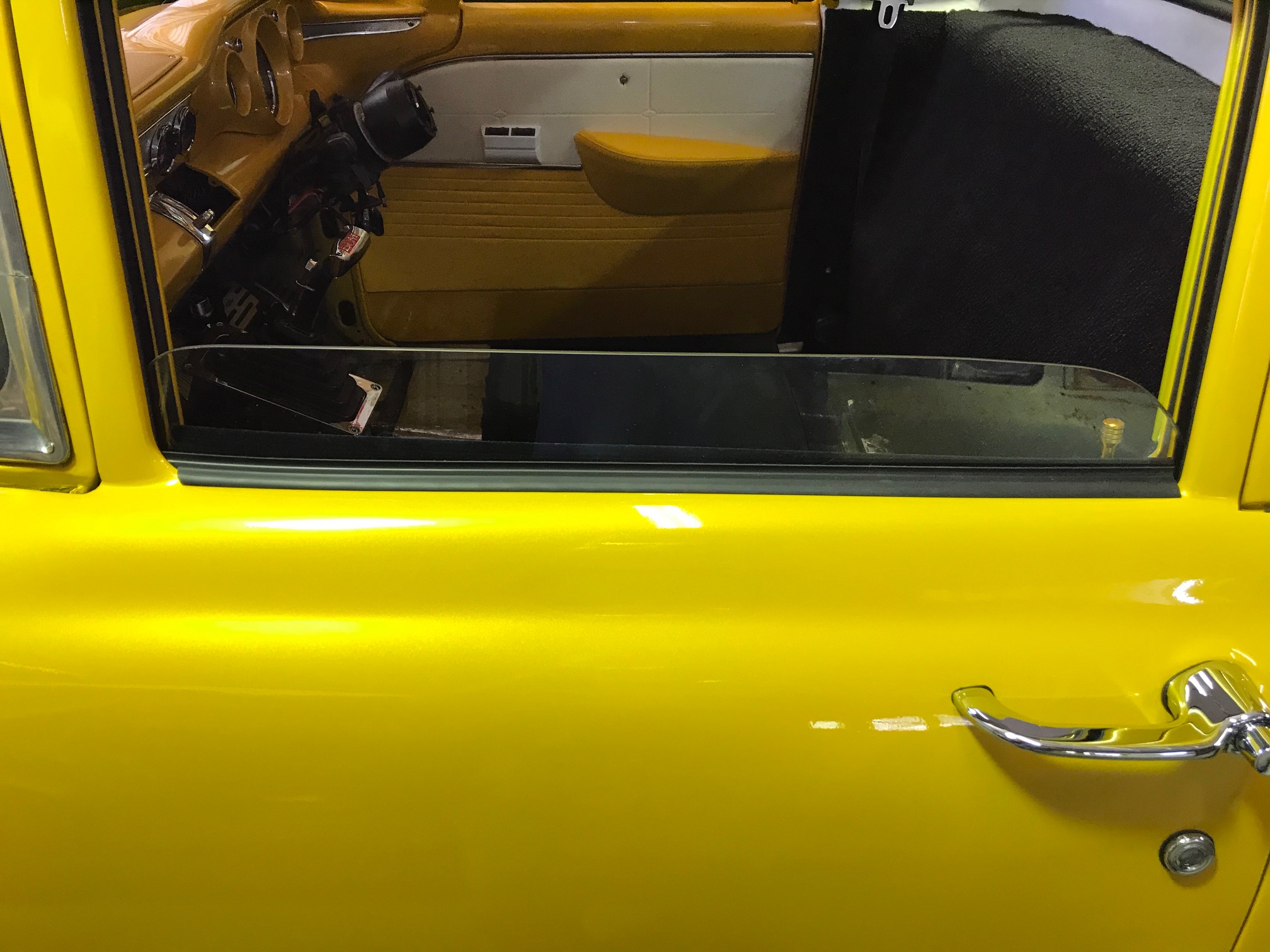

Hey guys that is what I used on Franks side window seals and it sticks well, it helps if you just rough up the paint a little.

I'm referring to the 3M product, Black Weather Strip Adhesive

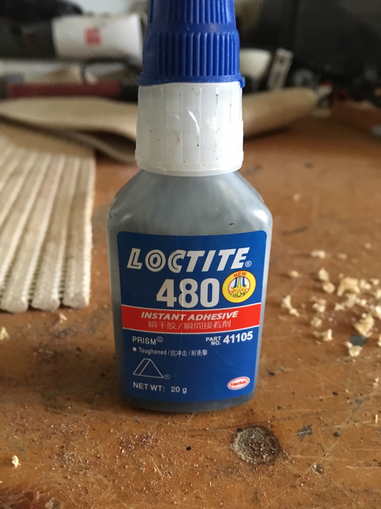

BILLY BLACKARROW wrote: Fri Feb 26, 2021 1:54 pm I didn't use Superglue or contact I used a Locktite product but cant remember the No of hand 425 possible is superglue or contact glue what i should be using what have you used over the years
What I used was locktite 424 only one digit out :grinnn: :grinnn:
