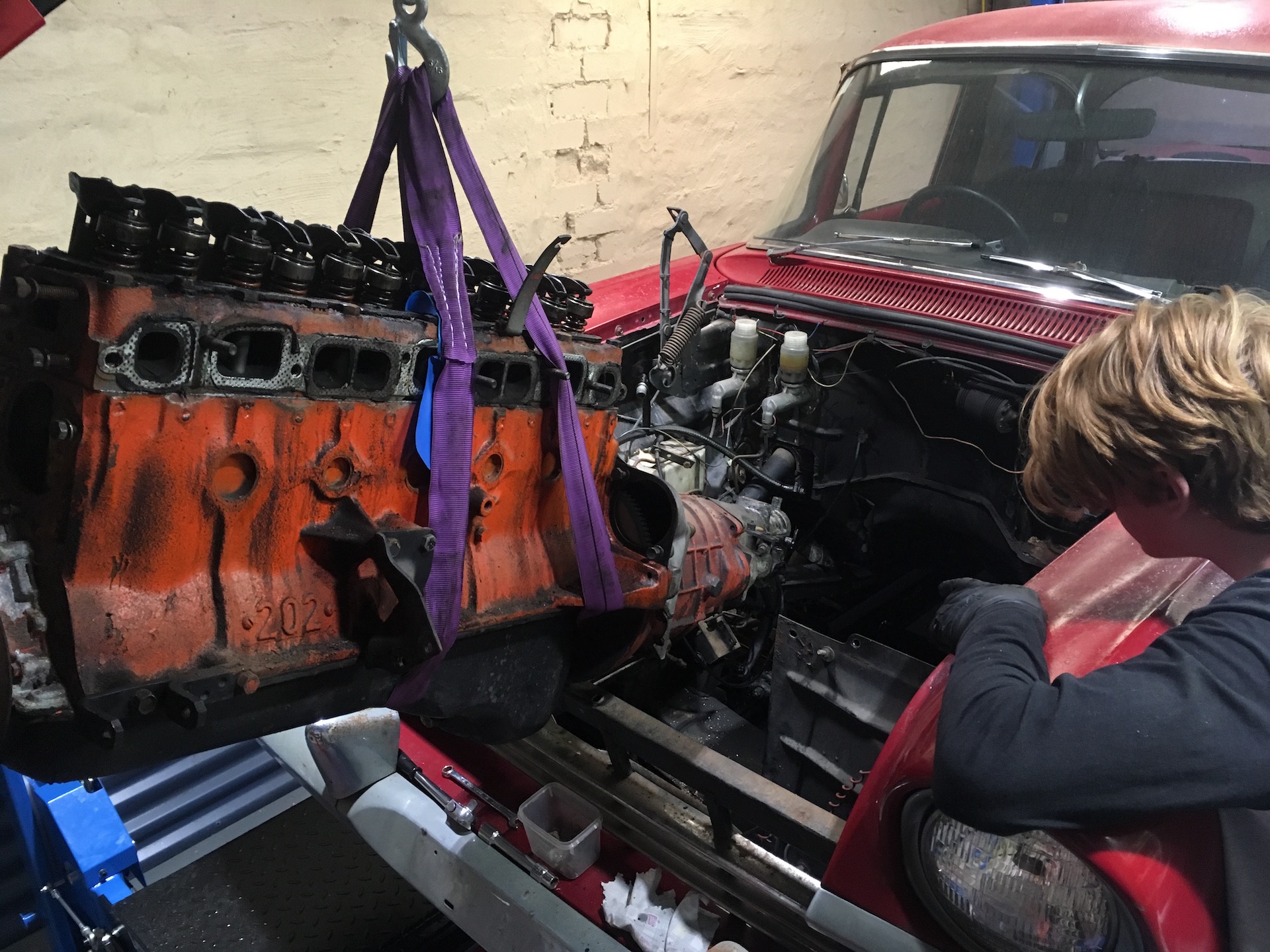

Unbolt the drive shaft, cut the exhaust (all welded), and it’s time to get the gumtree hoist into action
Re: Ol' Rusty - FB/EK Sedan
Posted: Tue Nov 10, 2020 7:35 am
by funkyscooter

Advantage of hoist. Lower car when engine won't go any higher.
