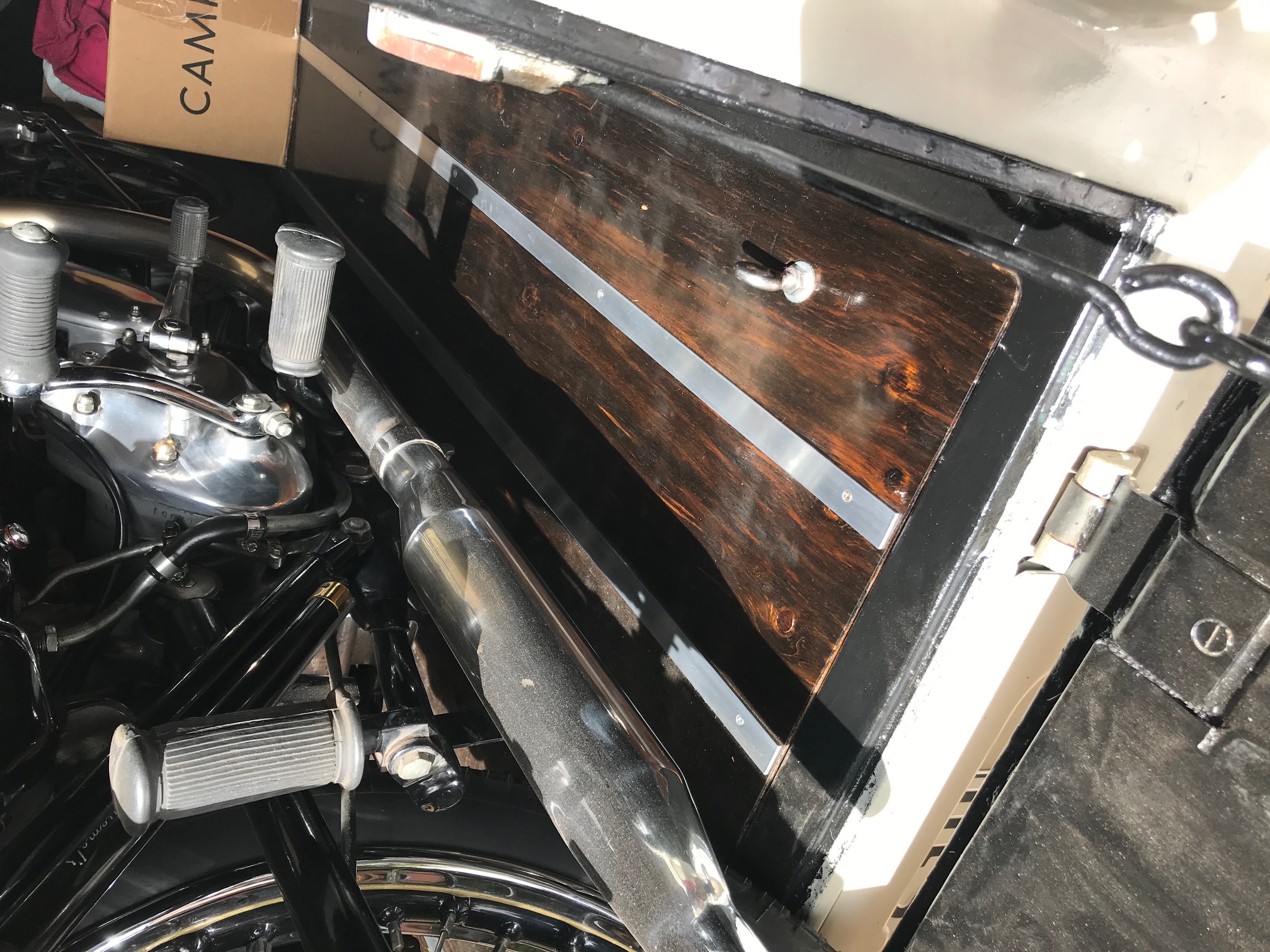

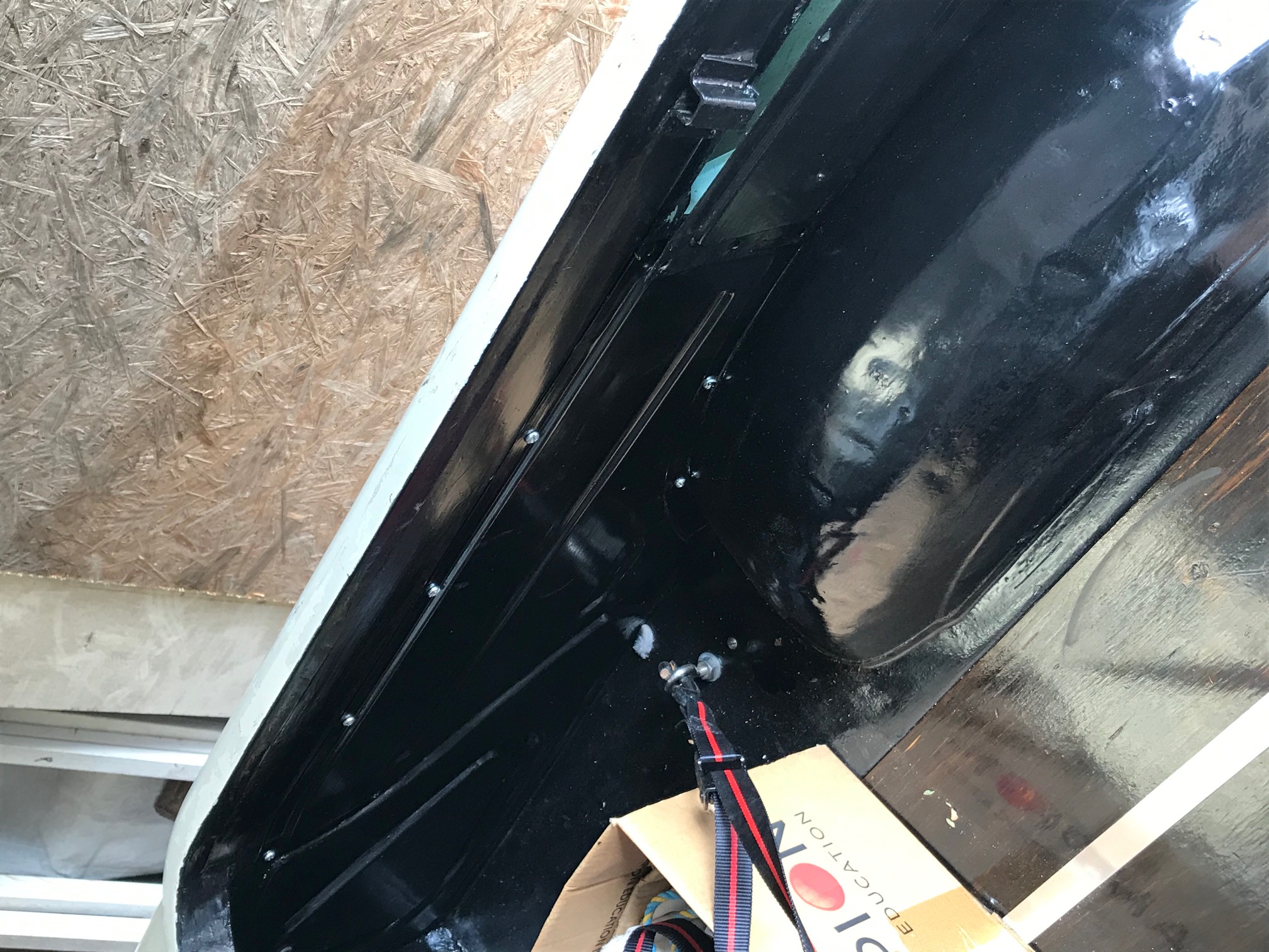

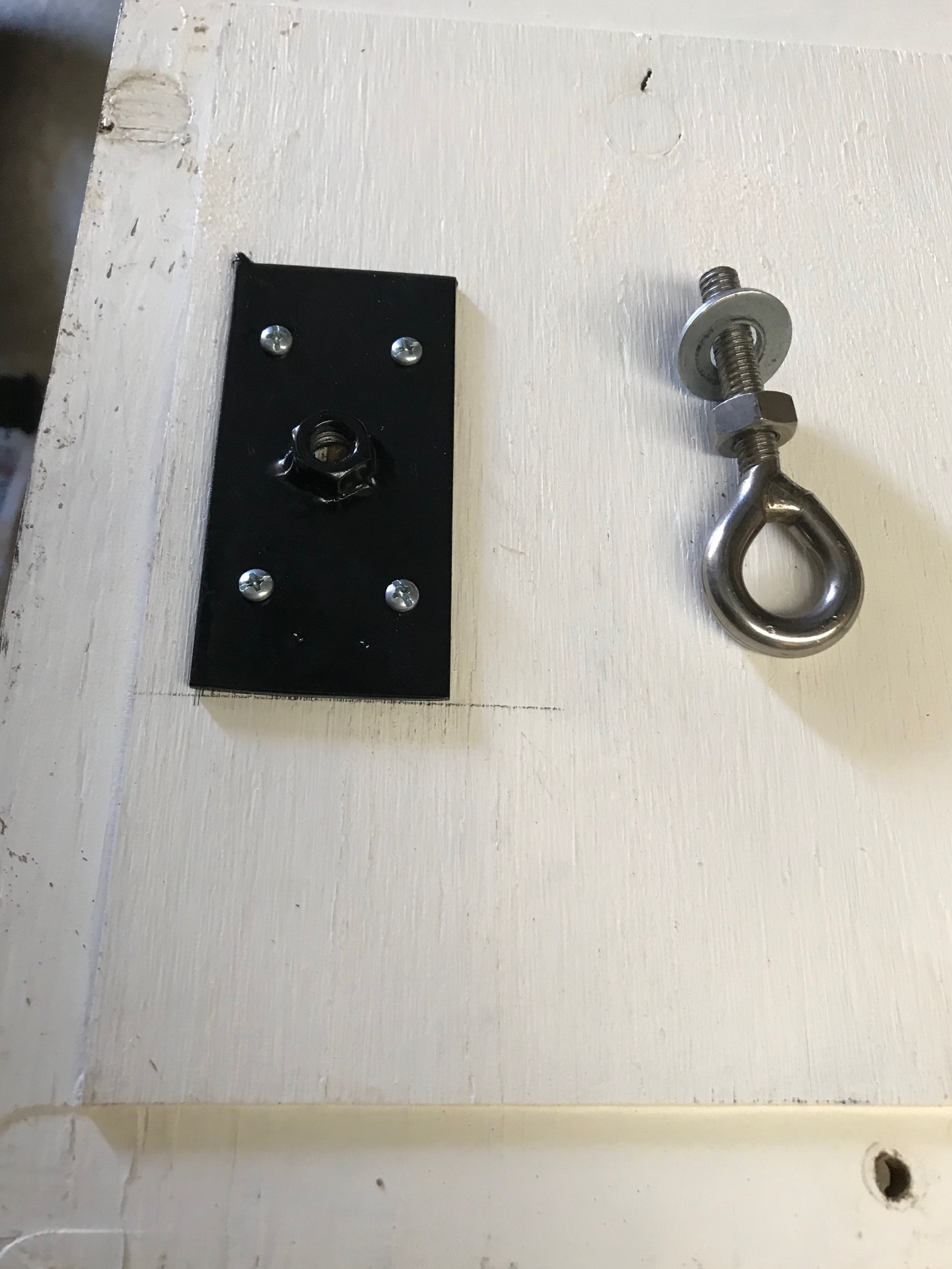

To tie a load down i have used stainless steel bolts as per below. I have two bolts that go through the timber floor. Underneath there is a steel plate with a nut welded in place. Then I have two more forward of the wheel arches again with steel plates underneath. The eye bolts can easily be removed once the lock nut is loosened. I use these to tie my bike down which weighs around 400 pounds. The electric winch under the parcel shelf pulls my bike up into the back.
Underside of timber floor

Looks like you’ve done a nice job painting the cargo well Stephen.

Errol62 wrote: Thu Apr 30, 2020 10:59 pm Looks like you’ve done a nice job painting the cargo well Stephen.
Thanks Clay,
Yes I'm happy with it. I don't have any pics at present as my bike is still parked in the ute. I need the shed space for another job that's been on the go.
