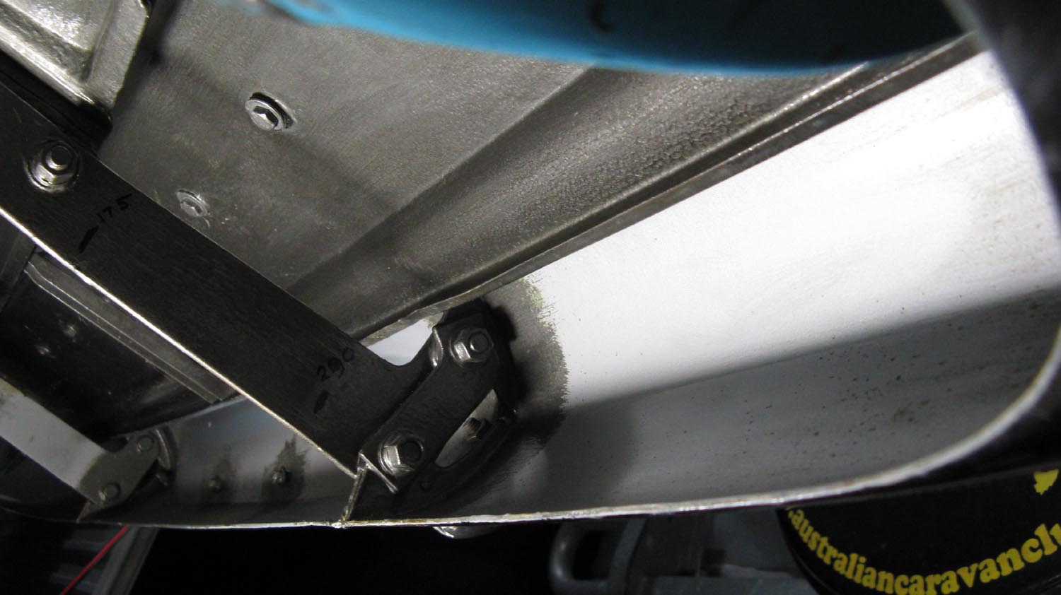

This one shows the bend from underneath looking up.
007 rh bumper mounted mail.jpg (114.55 KiB) Viewed 695 times
This one was taken from the edge of the guard.. looking across - don't know if it helps at all, but you can see both irons in this.
I fitted the bolts from the inside.. and the nuts from the outside with spring washers and flat washers on them.
I also cut out some thin neoprene rubber as a gasket to fit against the sub-frame... I like to fit rubber gaskets where there is risk of crud getting in and eating away at two flat pieces of metal bolted together...

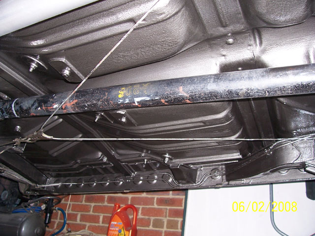

rear floor 0002 mail.jpg (104.68 KiB) Viewed 686 times
The pix are out of order... the first one should have come up second...
The sills in the second pic show it clean again after a rub down with some soapy water and dry off with a towel..
The next pic shows what it looked like after getting back from a run over road works which were wet ... sills picked up a bit of muck on them .. but the rest of it stayed pretty clean... needless to say, it was all sparkly new looking again after a scrub up...
I like to go over looking under the car every now and then (with a wet rag in hand)... checking for stone chips.
The POR15 is mainly up the front on the toe-boards and under the front guards where the front tyres tend to create havoc with anything which can chip... also a fair bit of it down the back where the rear tyres throw stones up as well..... so far, not one chip in POR15 yet.. and we've been over some fairly rough territory ..

I might further throw in some suggestions to anyone who wants to go this far.. or anyone who wants to add a bit more protection to the underside....
I use "butyl-mastic" on all the gaps between the floor and top-hats.... and also the openings around the jacking point frames. I did this after the undercoat went on.. then painted more undercoat on after it had cured enough to paint....
Further, I drilled drainage holes in everything under there which could trap water... the jack frames, top hats and sills are all open to drain at the lowest point on all of it...
With the holes, drilled - I could push a flexible dip tube into the area and pump fishoil in using an aerosol can... plugged up the drainage holes first, left for a few days to penetrate - the removed the bungs and drained out the excess fishoil...
I go way what most people would with my old bus to preserve it.. I lost a sub-frame to rust (left front corner).. I know what a build up of crud can do.. and, whilst we are on the subject - please... everyone! - go to Clark rubber and get two 1" blanking rubbers and fit them to the holes for the socket to enter for removing the outrigger bolts... that's what killed my sub-frame... all the rubbish and debris that went into it through these two holes in front of the radiator baffle... and - drill holes in the bottom of the sub-frame to allow any water to get out.... it can't go "uphill" over the crossmember mounts... and it will well up if the two pathetic little drain holes at the front corners block up - and they will... please check these and take action..
