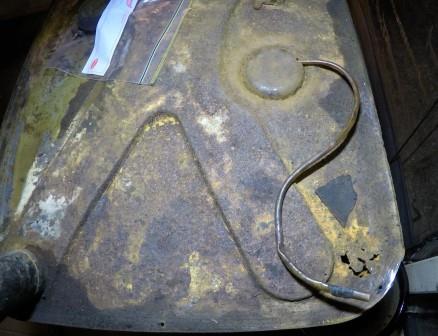

Removed the fuel tank. There is a hole in one corner and some stuff rattling around in it. Can the sender unit be replaced, it doesn't look like it on this one? Is it worth salvaging?

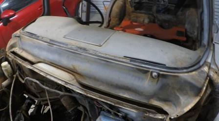

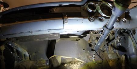

Also removed the "shroud upper outer panel" and am up to removing the "plenum chamber cover panel and door assembly" which I assume is this:

but the manual says it is located under the instrument panel?
Under Dash.JPG (36.05 KiB) Viewed 1370 times
Can any point me in the right direction?

There is a cover over the fuel sender mate ya just have to gently prize it up then ya will be able to see how to remove it the senders can be purchased from rare spares but fuel tanks are getting pretty hard to find but your probably in the right place on this forum to find one..

Dave,
Have a good look under the dash. Carefully remove the cardboard glovebox insert. You will see the plenum door and frame which is actuated by the chrome lever next to the ash tray. Can you see any evidence of rust holes in the panel it is mounted to? Is the plenum chamber full of pine needles or leaves? There are drain tubes either end of the chamber which allow any water to escape to the inner guard area. You can remove the door assembly if the seal needs replacing. Minor rust holes can be accessed under the dash rather than removing the cover panel but this is easier if the interior is out of the car and easier still if the car is on a rotisserie.
In my thread EK panel van project
https://r.tapatalk.com/shareLink?share_ ... are_type=t I have som piccies of the under dash area. Also recently described replacing the plenum door seal in my FBUte thread. This job was actually the first task I ever undertook on my EK sedan when I first got it in 1986.

Orange Betty wrote: Mon Jul 16, 2018 7:03 pm Removed the fuel tank. There is a hole in one corner and some stuff rattling around in it. Can the sender unit be replaced, it doesn't look like it on this one? Is it worth salvaging?
Hi Dave, when you remove the sender unit, you can test to see if it works. If it's not working, it's possible to fix, depending on what's wrong and how far you're prepared to go fixing it. They're about $170 from Rare Spares, which includes the gasket and new screws/washers. If you need help, just sing out.

The fuel tank might be saveable if you can find someone to weld and patch it - If you can and the rest is reasonable you can get a POR15 Tank sealer kit - Ute, Van and Wagon tanks are getting rare these days. :)

I managed to prise the cap off the fuel sender. The screw heads are very rusted and I don't like my chances of getting them out easily - any hints? There isn't a lot of room to work in there.
