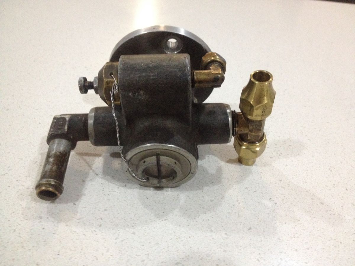

Thanks Blacky - please do post a photo. I heard that the guy was casting them, but I don't do Facebook, and missed the boat. How heavy is the wall thickness around the cam gear? I'm wondering if it is heavy enough to either mount a fuel pump to it, or stiff enough to take a doubling plate to mount a pump to. Plan is to use the older Hilborn pump that I overhauled and posted on the forum earlier:
Optimized-Hilborn pump.JPG (690.71 KiB) Viewed 1560 times
... or failing that, one of the PG150A pumps I own.
