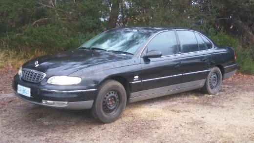

Sooo it has been a while, but I do now own this donor car, LS1, auto and electric everything so stay tuned although things will be moving slooooowly due to having litited funds :wink34: I have just spent the last few months doing the rust in my mates FB, it came down to get the parcel shelf done but I ended up replacing the whole rear drivers side rear quarter plus inner wheel arches plus removal on the rear beaver panel as the bottom was completely rusted out which also led to the rear section of the boot being done and then there were the rear quarters that needed doing......

Post by TAZ »
TAZ wrote: Tue May 02, 2017 8:44 am umm photos wont load so pretend there is a picture of a WH Statesman there.....
Here she is in all her glory, am now deciding whether to go with a LS1 5.7L or LM7 5.3L cast iron motor which is a heavier motor but can handle more boost on the stock bottom end but can be taken out to a 5.7L decisions decisions......

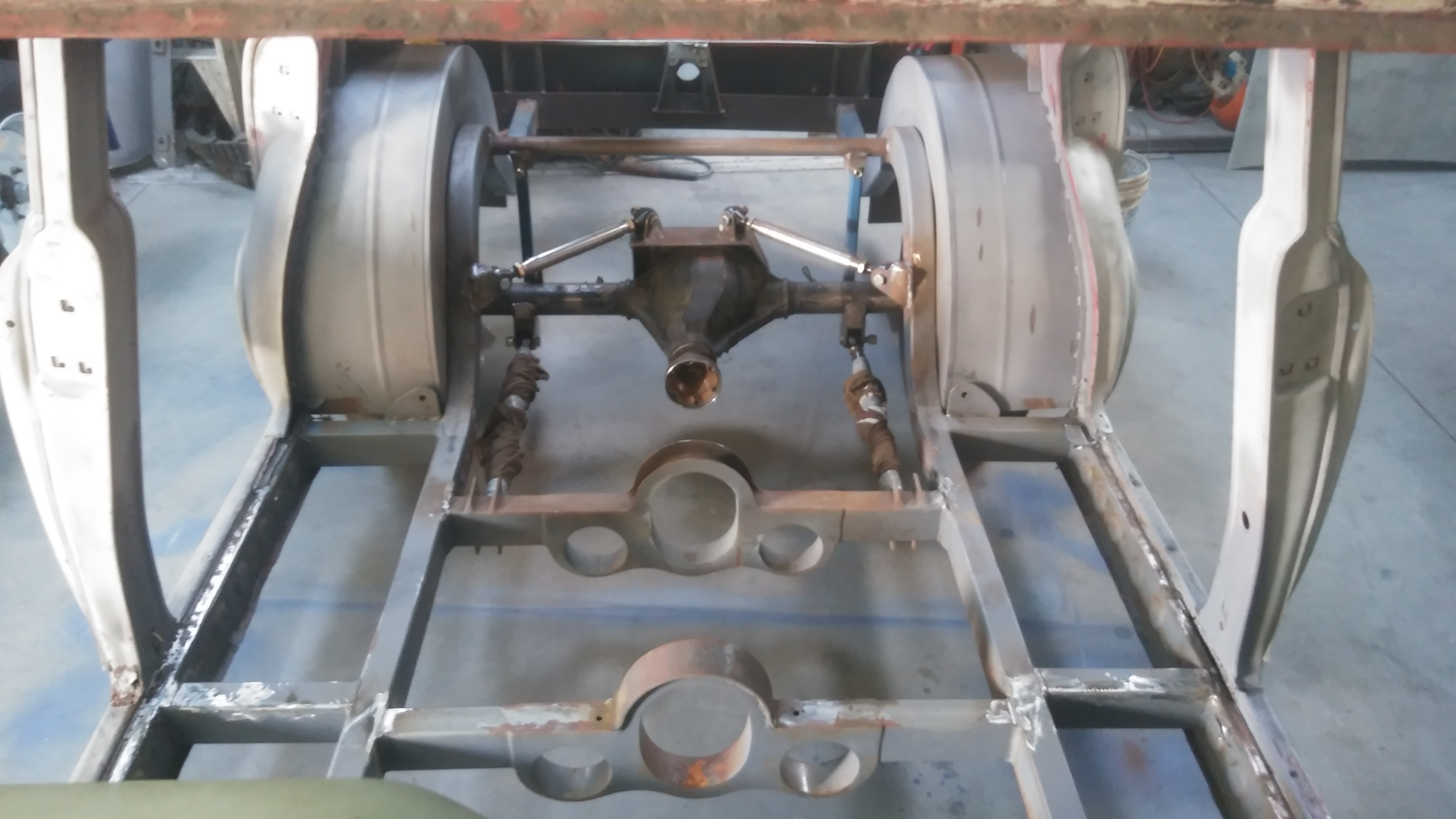

So in preparation for the arrival of the new donk the car is back on its wheels. I also bit the bullet and cut the floor out that was installed by the previous owner. Too many gaps between the new chassis plus no proof costing applied, was just to dodgy for me, she does sit low ImageImage.ImageImageImage

Rusty EK
Posts: 830
Location: Hobart , Tas
Re: LS1EK
Post by Rusty EK »
Probably easier in the long run to replace the whole floor than to patch it all and will look better in the end :thumbsup:
