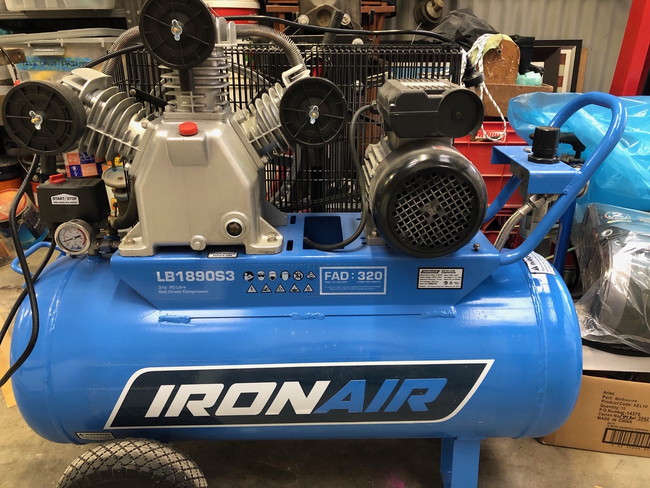

Posted: Sun Mar 31, 2019 10:34 am
by Jonty
- IRON AIR.jpg (505.36 KiB) Viewed 1184 times
i spent ages trying to get the most air for the least money. In the end I got this compressor from total tools in the Boxing Day sale for about $700. 320l/m FAD and 90 litre tank. Needs 15amp power but that wasnt a problem at home. So far it's been good. It's pretty busy running a DA sander at full speed. I've only sprayed water based house paint on the interior of an old caravan with a $15 Aldi spray gun, but had good results. I've now got an Iwata AZ3 HTE2 gun which I'm looking forward to spraying the outside of the van, and then getting back to the FB!
