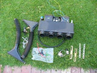

Got the hard word from the 'boss' that its getting a bit hot, and that i should put the aircon in now :shock:.......... "happy wife happy life"
The unit is from desert coolers (the radiator mob) and cost $450. It comes with the under dash unit, fan and hot cold switch, mounting brackets. The items to the left did not come with it. the vents are out of a 3 cylinder charade, but they looked pretty easy to adapt for demisters or outlets which i will mount directly under the dash. ie you will just see the slit, the heater taps from rares and the vent lever is the standard fresh air vent lever, which if you reverse becomes the heat lever on your dash (for those that don't have a nasco heater)

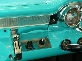

I mounted the controls in the ash tray. you can see the two levers now for vent and heat

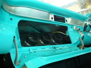

Its a tight fit but no cuting required. once the ductings in place you might just have room for some sunnies
All looks neat and hidden just got to get it plumed and gased and happy days (will let you all know if it works any good)
