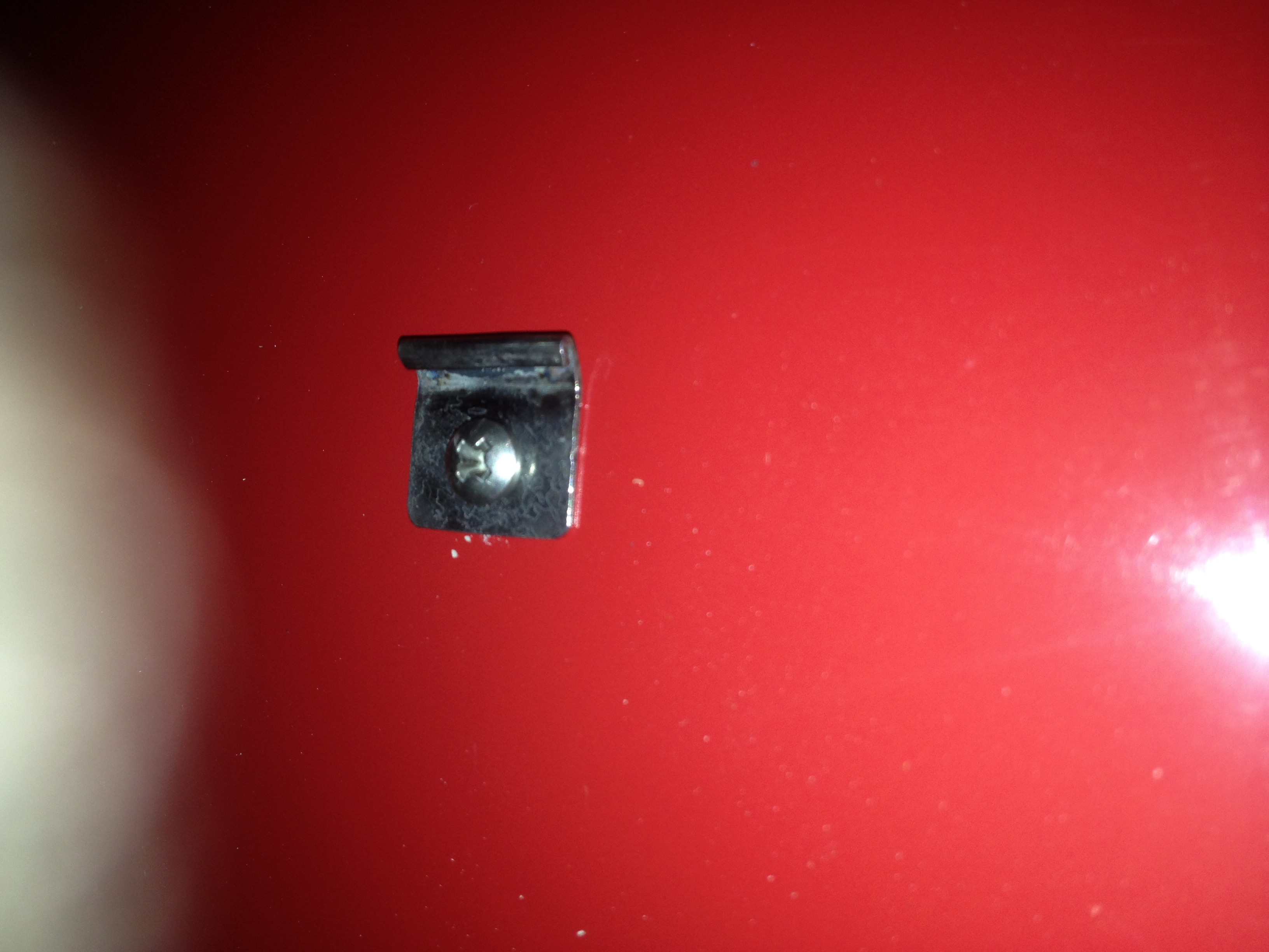

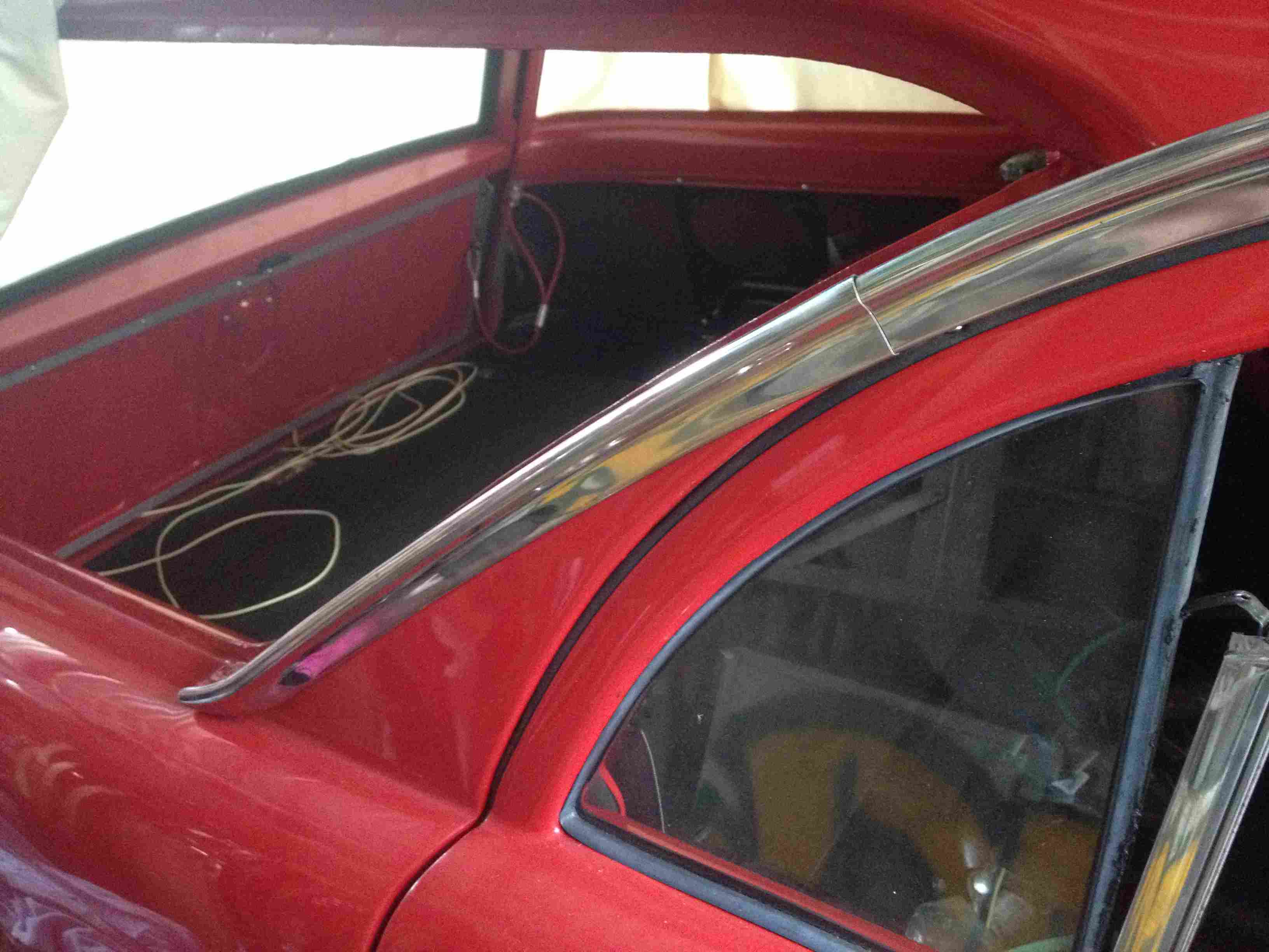

Used the stainless clips from Sam Crupi for the piece of moulding that goes along the rear of the wagon roof:
Roof side rear 2.jpg (87.83 KiB) Viewed 1659 times
Roof side rear 1.jpg (95.49 KiB) Viewed 1659 times
There are five of the clips each side, held on with a #4 screw. I used some stainless screws, as the old ones were pretty rusty. I put a quick blob of mastic into each screw hole, then put the clips on. I ran some painters masking tape (the blue stuff) either side of where the mould goes on (cause I am hamfisted and was frightened of gouging the paint). I then bumped the mould into place with the bottom of my fist. These are left and right hand moulds, so trial fit first.
There is another mould that butts against this one, again using the Sam Crupi clips. Will take a photo of that one too once it's on.

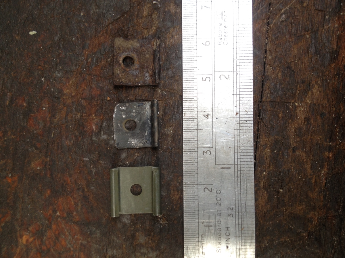

Had some fun with the square clip at the rear of the wagon's waistline moulds (the mould that nearly butts up against the taillights). Mine were rusted beyond repair, and the Rare Spare clips were all too small. I ended up cutting a Rare Spares MB0003 clip down to size. They start out 19x63mm, and I cut down to 19x25mm. This did the job nicely. Excuse the clip in the photo... it needed some file finishing before going on.
Rear quarter side mould cutdown to 1 inch from original Rares 19mmx 63mm part number MB0003.jpg
Rear quarter side mould cutdown to 1 inch from original Rares 19mmx 63mm part number MB0003.jpg (137.55 KiB) Viewed 1659 times
These are supposed to have a sealing washer (rubber plug) but a good blob of mastic does the job (put some more on the hole from inside the panel too).

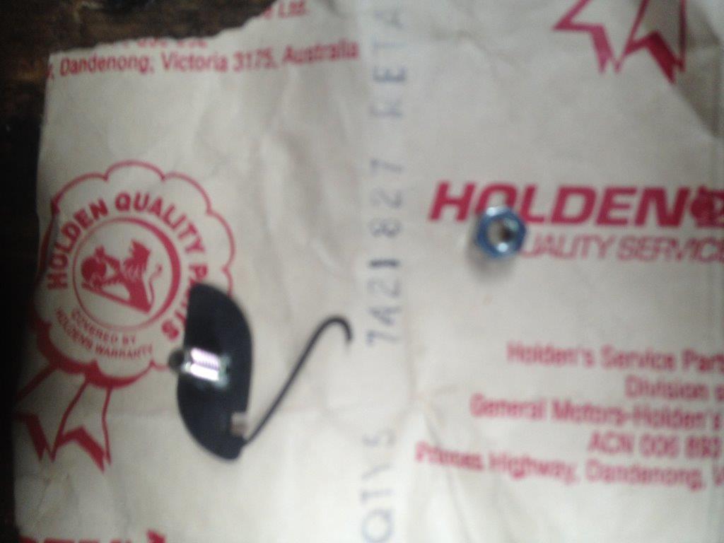

The other four clips in that mould are the ones with spring hairs available from Rares. I bought mine a while ago, which Rares supplied as NOS GMH part 7421827.
These four clips were fun, as you get at the nuts from the inside of the wagon rear panel. They all appear to be 1/8 Whitworth. As Mater says "they ain’t metric, they ain’t inches, you never can find a wrench to work on them”. After finally finding my trusty Whitworth spanner (don't ask :oops: ), I got most of the nuts on... then dropped the spanner between the rear guard and the wheel well. The gap is tiny... but perfect to swallow a spanner. Too small to get my magnet-on-a-stick down there. Had to walk away from that job, still trying to work out how I'm going to retrieve that spanner.

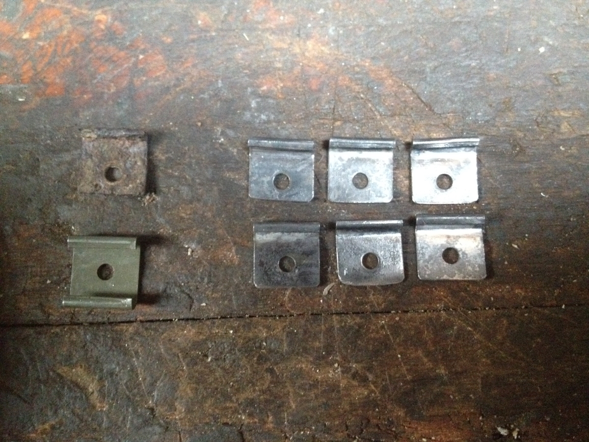

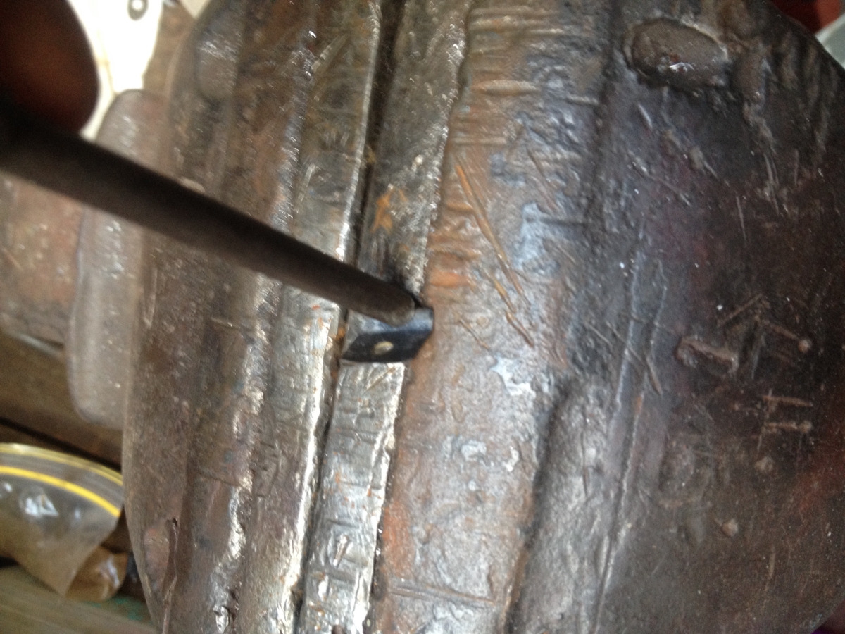

Harv wrote: Sun Aug 06, 2017 2:10 pm The next mould going forward is the triangular one at the rear of the C-pillar. This has three clips on them that are similar in design to the Sam Crupi clips, but only have one "curled up" side. I cut the side off one of Sam's clips... so far so good. The "curled up side" needed to have less angle (and the lip rolled over). I gave my cutoff clip a gentle squeeze in the vice (and I mean gentle)... and it turned pear-shaped. The clip snapped off. My guess is that the stainless is very work-hardened by Sam's forming process. I'm going to try annealing the clips - heat to red-hot then air cool. Hopefully this will let me bend them.
Took one of Sam's clips, and annealled it by heating red-hot with the LPG bottle:
Cut one side off, and a few gentle taps with the SFH to recurve the bend:
... and voila! the missing clip. From top, the original rusted out clip, my modified Sam clip, and one of Sam's originals:
Rinse and repeat:

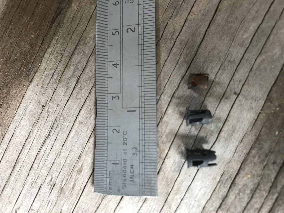

Across the bonnet of the FB/EKs, the letters H O L D E N are installed as badges. The badges have two pins each, with different pin directions to suit each letter. The pins can corrode, and often snap off when removing the badges from the bonnet.
In between the badges and the bonnet holes are small tube clips. The tube clips "squeeze" the pins, giving a nice firm fit. The tube clips are often tapped out of the bonnet before a respray, and sometimes come off by sticking to the badge pins.
I bought some tube clips years ago from eBay, and thought I had the issue sorted. Sadly, the eBay tube clips were waaaaay too big for the bonnet holes. It looks like what was sold on eBay is the clip sold by Rare Spares as part number NS0039:
http://www.rarespares.net.au/rarespares ... uct=NS0039
Some discussion with Rares in Sydney show that they also stock the "little brother" of NS0039. The photo below (from top to bottom) shows an original (rusty) tube clip, the "little brother clip", and NS0039. The "little brother" clip is perfect for the FB/EK bonnet.

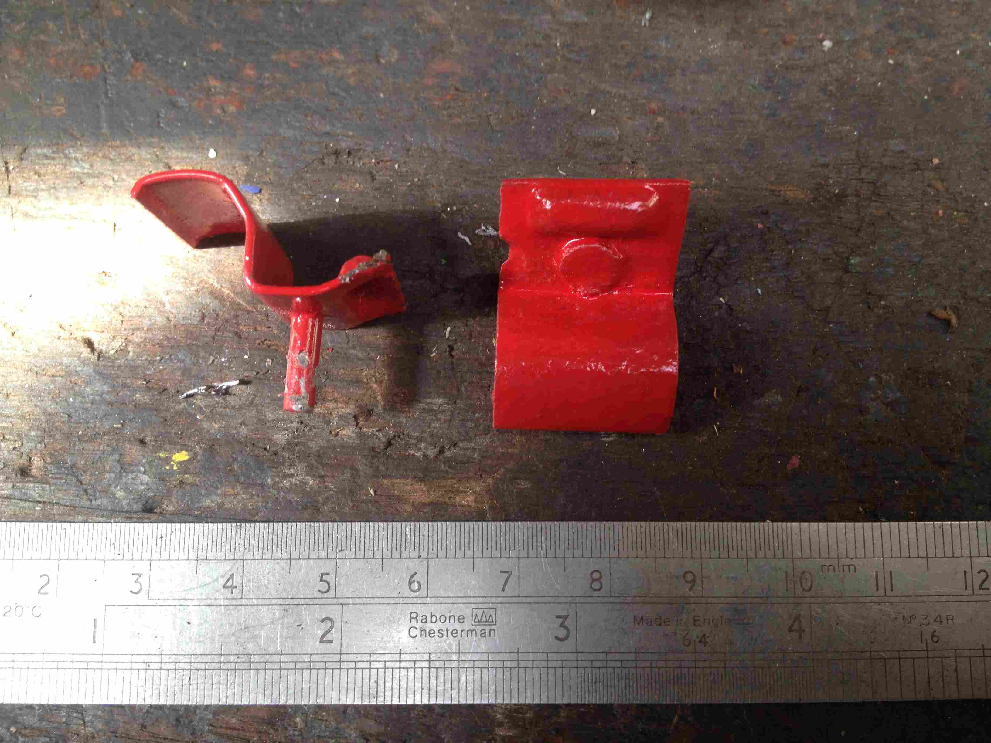

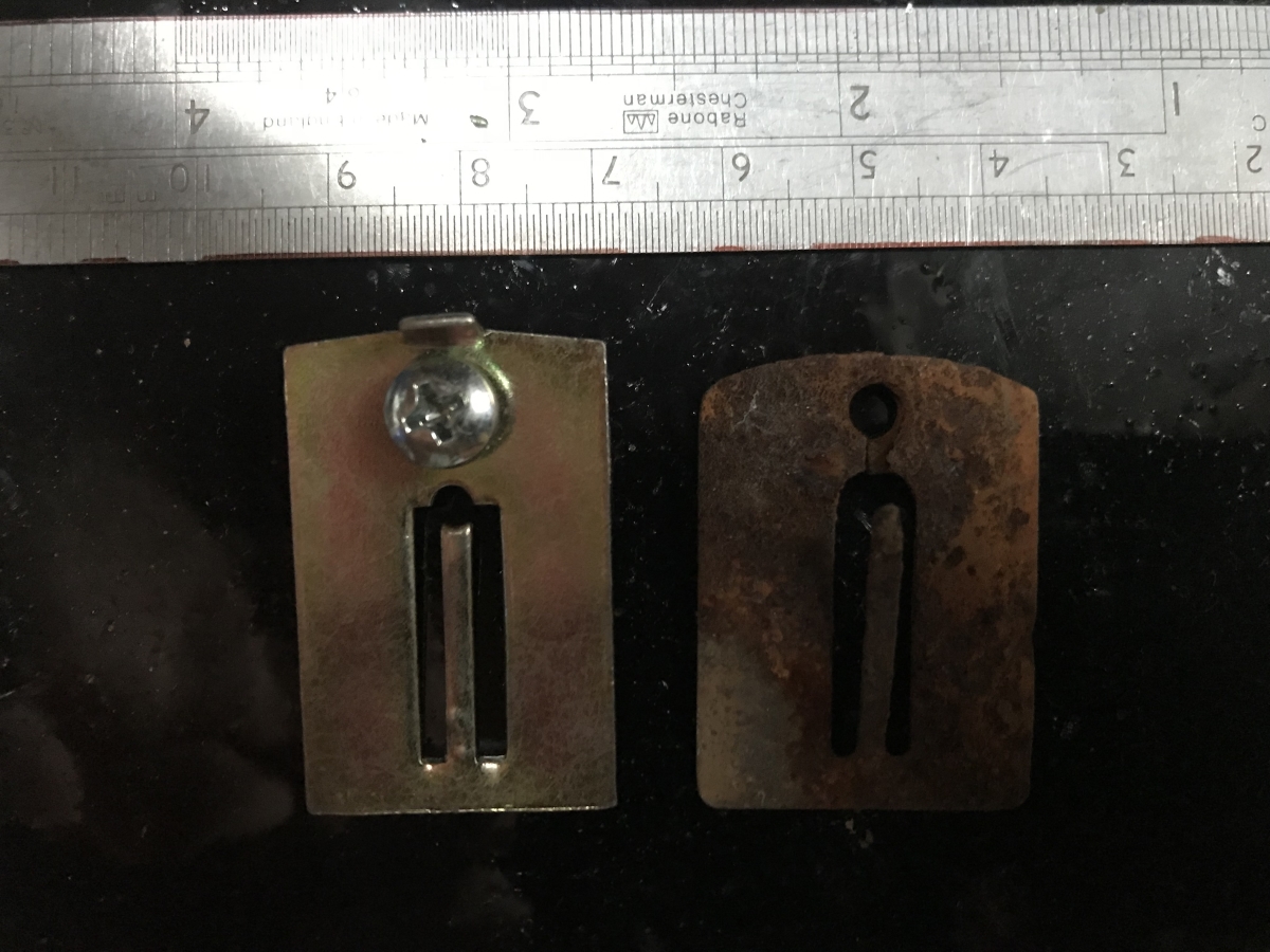

Got a bit more serious with the front door moulds. At the leading and trailing ends of the moulds are moulding anchor plates that look like a razor blade:
The one on the right is the old original one (7401726), which is held on by a No.8-32 x 1/4 set screw. FB's use the same anchor plates too. I haven't been able to find a replacement for these. The closest I can find are the 7421833 clips EH boot mouldings shown on the right, that I bought from Rares, though these are a poofteenth too narrow. For now I've cleaned and painted the old ones.

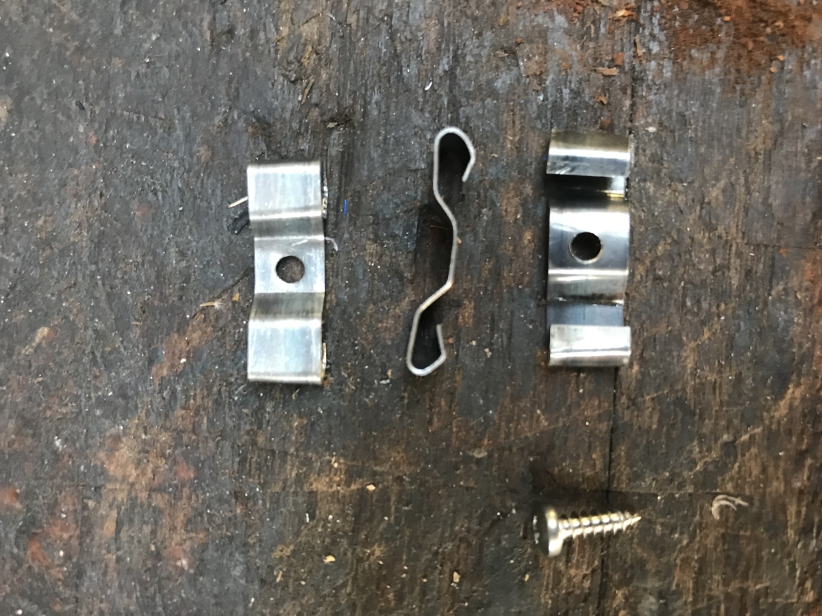

In between the two ends the moulds are held on by moulding retaining clips (7134149) held on by No.4-24x1/4 screws. FB's apparantly use a moulding retaining clip that is different (7416464). The EK clips are reproduced in stainless by Sam Crupi:
The clips screw in place (I used some No.4 stainless self tappers):

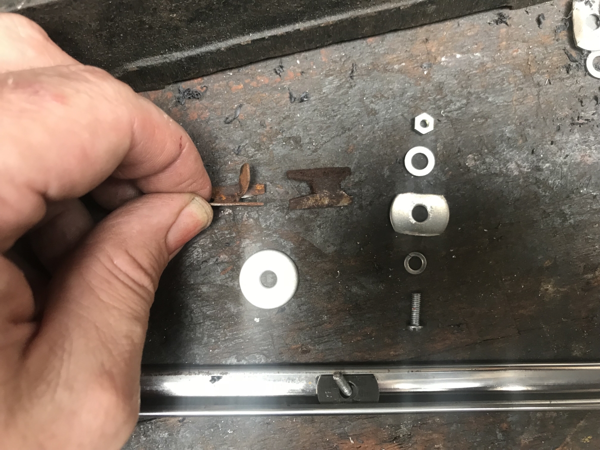

The FB/EK front bench seats have steel sides. The steel sides are painted in the body colour, and have a stainless moulding. The moulding is normally retained by three wierd clips, as per the rusty ones shown in the left of the image below. The clips slide into the stainless moulding, then are inserted into the steel sides. The clips are then bent (twisted) to hold the moulding in place.
When I removed my mouldings, most of my clips disintegrated. I could not find anyone making repros. I ended up taking some stainless washers, and grinding flats on two sides. The ground-down washer will then slide into the stainless moulding, as per the image at the bottom. I used some 1/8 Whitworth bolts, which are just small enough to pass through the steel seat sides. With three of the modified washers in place, the three bolts slip into the steel sides and are then held on with the whitworth nut.
