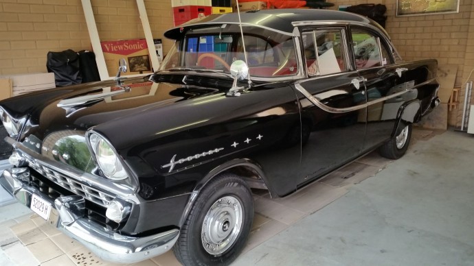

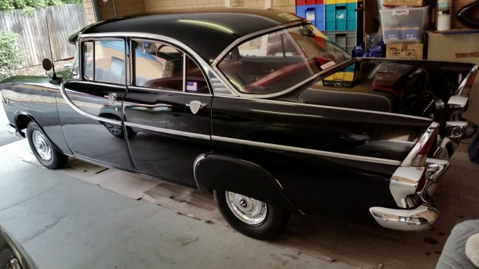

All fixed!!! Sunvisor all mounted and sitting proud Image Image Image ImageImageImage

Hey Blacky, I used speed nuts and a combination of the old flathead screws and the zenith metal screws. I test drove it at 80 kph and no movement what so ever. Not my first choice in fixing the problem but for $10 it worked. ImageImage
