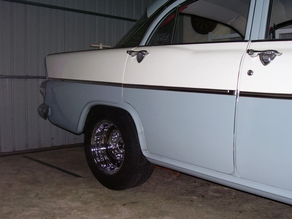

Third Disguise
You've seen it dressed 'Retro 60's' & "Grandpa", and now I'm putting together a third disguise.
This time I've got some 14x8 & 14x6 Chromies for a 70's look.
'Old Holdens & Chromies to me is as Aussie as it gets.'
Heres a sneek preveiw of the rears, fitted with dagy tyres
while Im waiting for my new F70-14 Mickey Thompsons to come.

kool - i thought the mags looked abit smallish :wink: :D :D :D
I love chromies, you couldn't get more Aussie if you had a meatpie as a hood emblem :lol: .
Trev 8)
I do agree with you (AUST)Mod, But 215/60-13 where the biggest
tyre on these rims I could find that would tuck inside the gaurds.
Since these pics where taken, I've fitted Tiny 155/13 up front to
help with propotions.
If anyone knows of a 215/70-13 I could swap these tyres onto the 'Grandpa' set.

are they real plates? looking good man, geez those are tiny fronts :) looking great proportion wise. will post up a pic of my fb with new 15x6 and 15x7s when i get it lowered and the guards rolled :lol:
