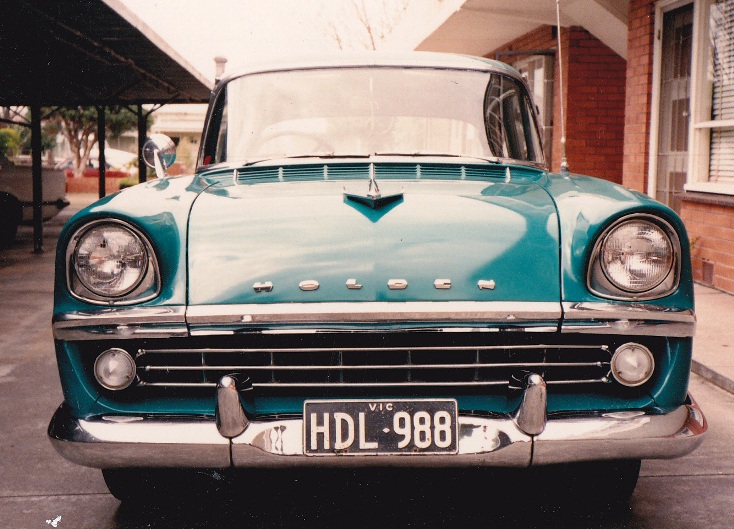

Steve, when I had my first EK (when I was 18) some people from down the road came up and said they liked my 'old' holden (back in 1979 it was still called an old Holden back then! ) and they asked me if i wanted another one!
I went down the road and saw this very original, in good shape 2 tone Green FB. They said they tried to sell it but no-one wants it. My family would not let me keep it in the backyard or out the front - so the people said "take anything you like off it as its going to the tip". I just took a few small bits off it. i can't remember if much was wrong with it at all
It was the same color as Andy Woods FB shown here. A medium green color with lt.green flash - Is this the color you were referring to?
NB- Andy's car got written off in the late 80's when it was hit in the rear real hard (It was being driven by a mechanic- when Andy put it in for a service)
Paul K
Like you my first car was an EK henceforth I'm sentimental towards them.
Paul K
