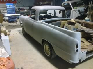

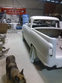

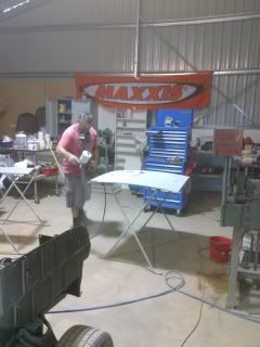

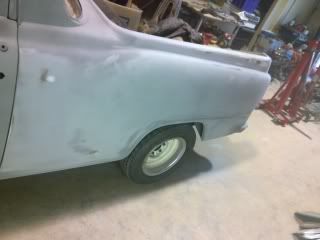

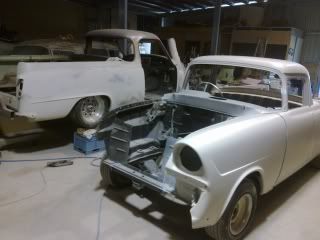

Some updates off whats been going on .Ute has been rubbed and reprimed twice.Unly drivers side front guard to re prime then its ready to be final rubbed then painted.Gearbox tunnel cut out and screwed in place hopefully welded this afternoon.
regards fatboy

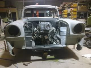

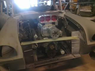

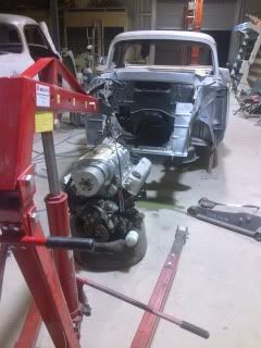

FATBOY
Posts: 506
Joined: Wed Jul 06, 2005 7:50 pm
Location: BATEMANS BAY
Post by FATBOY »

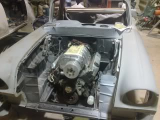

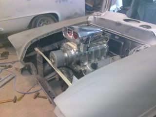

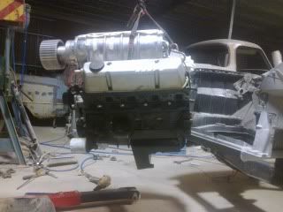

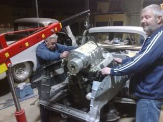

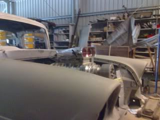

Some updated pics and some progress from the weekend fitted up first chrossmember that i had modified with a rear mounted rack conversion /Problem number one when i fitted the engine up into the engine bay the sump which was modified by v6 conversions fouled on the sump.(Different mounts for the rack).So i went to the container and dragged out the other chrossmember that v6 conversions done about 5 years ago (number one fc ek v8 conversion)Fitted it up then refitted the engine to the car fitted up fine didnt hit on the firewall but the blower snout was 35mm in front of the radiator support.To fix will need to move blower and engine back approx 70mm no big problem just need to get some sheetmetal this week whilst im working in Canberra.
regards fatboy

That's a serious 'Grey Motor' you've shoe-horned in there, Fat! :shock: :wink:
How did you go finding the right size 'tank' for the front? ..I''l try to get down to the shed soon (now if fixed my oil leak)..or give us a bell when you're ready to lay some colour on...(and don't panic I'll do the line-tape over the louvers on the tail gate. :wink: ).
