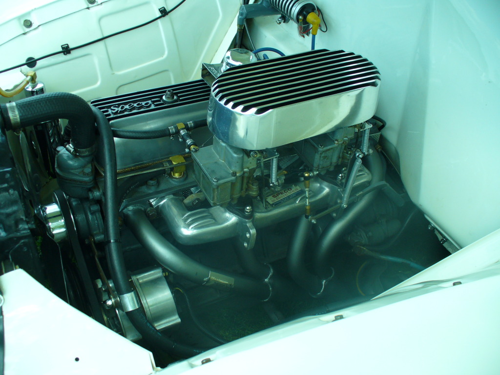

Just wondering how you are going with the twins, here is a picture of my setup, I used three small tension springs to distribute the load on the carb shafts evenly. As I said in my earlier post I didn't go with the original linkages designed for this manifold as I thought they over complicated things. :wink:
Mick 8)

that looks AWESOME!!!

Gotta love Grey motors, they can look pretty dam cool. :wink:

Now that's just plain pornographic newman... I LOVE IT! 8)

That looks cool Mick

Nice motor newman!- what aircleaner is that?
