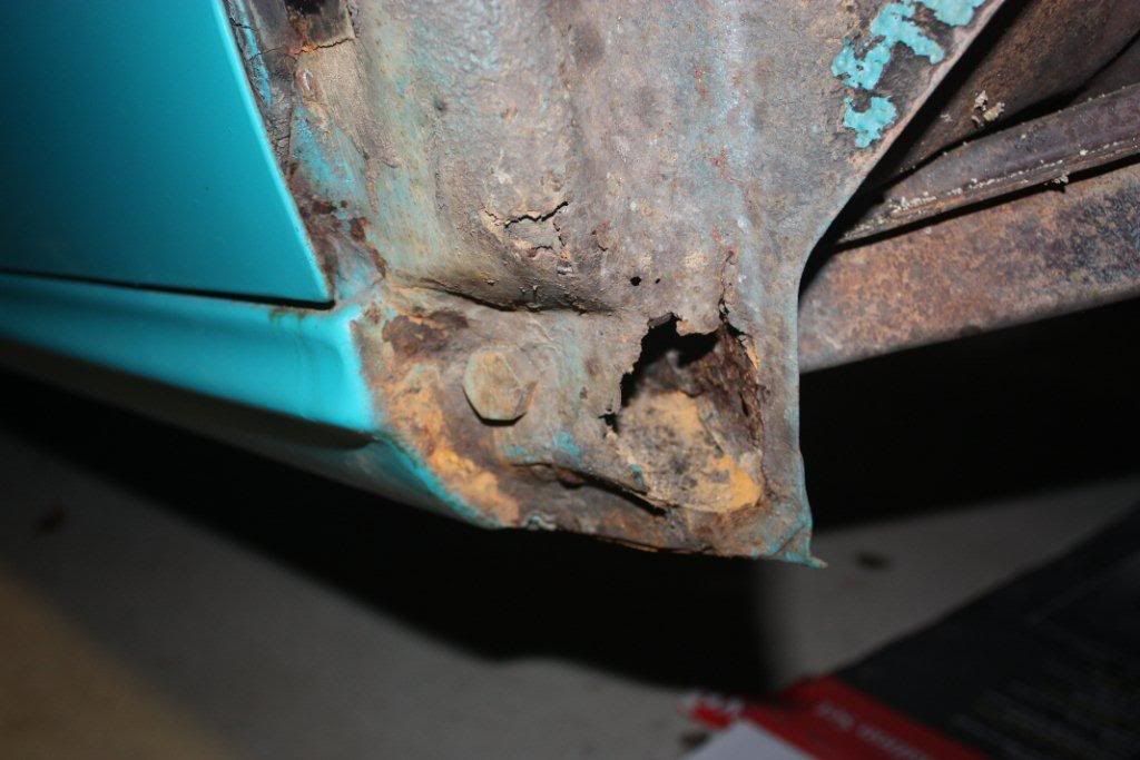

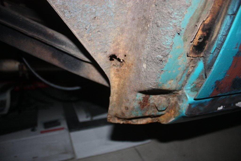

Its amazing how previous repairs can be hidden, the rust you have is pretty normal for the FB EK range.

I bought the car sight un seen, overall its in great nick no rust at all underneath. I have just gone and had a look at an FB sedan which has a number of rare spares rust panels including two sills.

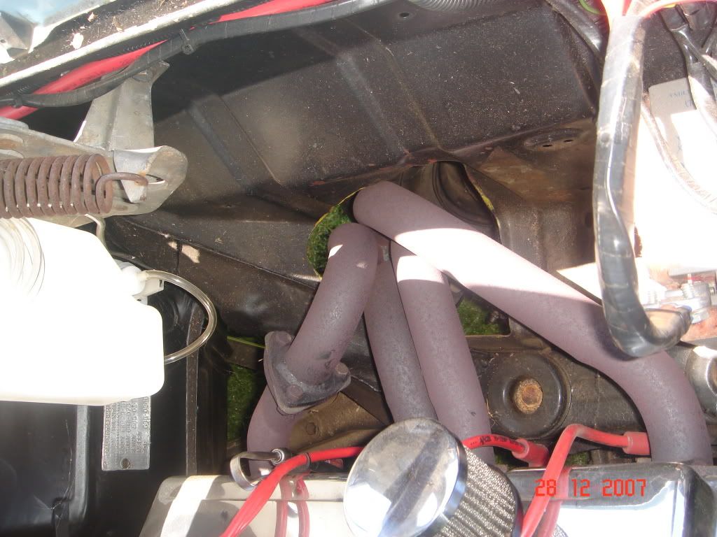

G'day Gazza,
Sorry mate, I don't have any photos of the BFH dent on the firewall - I put my motor in for trial fit, and it went in but rubs. I have a texta mark on the firewall, but need to remove the motor to make the dent (and freshen the old girl up.... we did the valve job on a bench grinder
). I do have some photos though of the CRS headers going through the inner guards, the radiator mounting (VL Commodore), the insulated battery box to suit the CRS headers and the alternator mounting. I'm in Canada this week for work (looking for Canadian blocks
) with a slow network, but will try to post them shortly.
Re: Small Block for EK Wagon

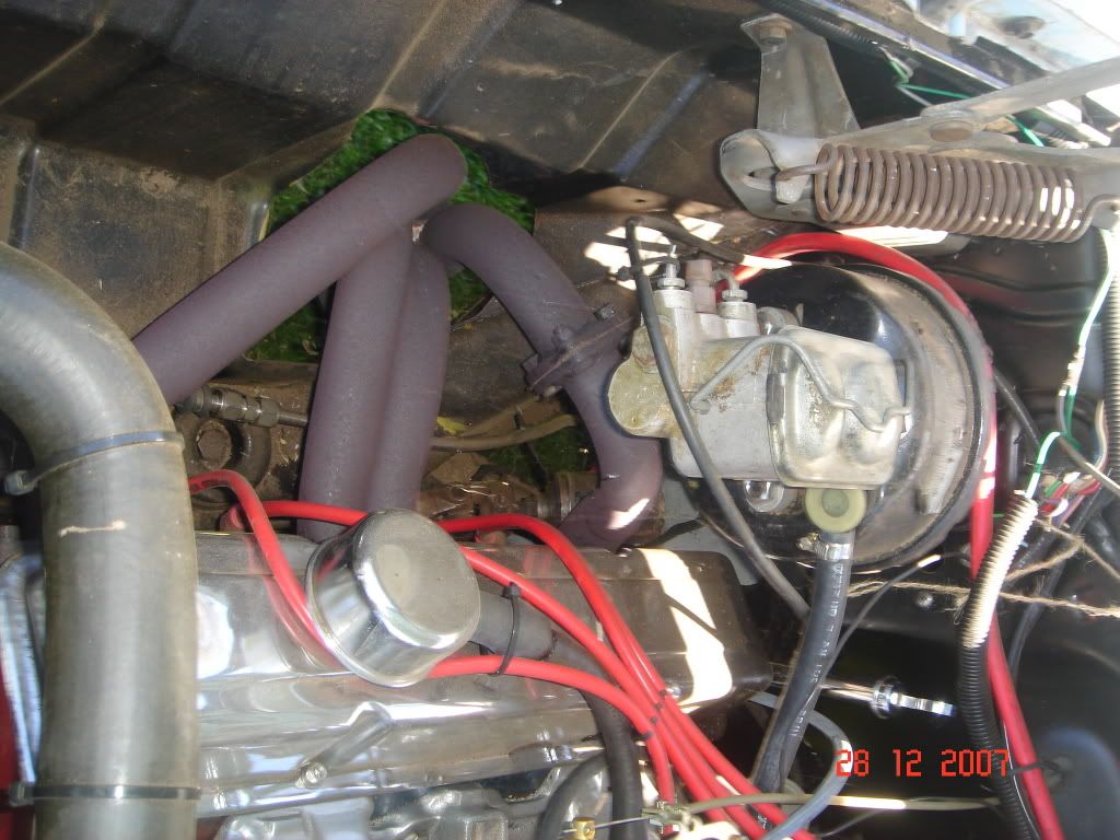

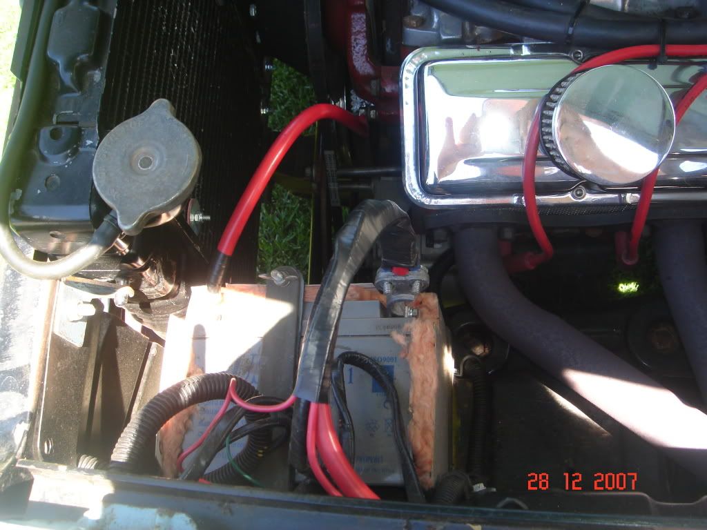

Pictures as promised.
Overall layout:
Alternator bracket (homemade to clear swaybar). No comments on the block paint... someone had given the old girl a Dulux Overhaul before I bought it
Battery box (insulated with roofing batts offcuts, uses gelcell battery to reduce size- notice how close the front pipe comes):
VL Conformadore radiator (fittings are on the right side for SBC, core is same size as used for VK 308's, and are plentiful):
Fuel and transmission coolant lines:
Passenger side CRS 'tractors:
Driver side CRS 'tractors:
Note that my fenderwell holes were cut so that the holes were only just big enough to squeeze the pipes through with the engine in place - they are an odd shape that need cleaning up (whole project philosophy is fit, fiddle, rego, drive, fiddle, drive, fiddle, drive, fiddle a bit more, and only then pull apart for paint). Let me know if there are any specific photos you want - the vehicle is in storage at the moment, though I will be up that way in a fortnight's time.

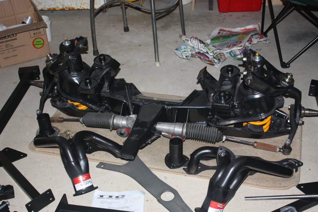

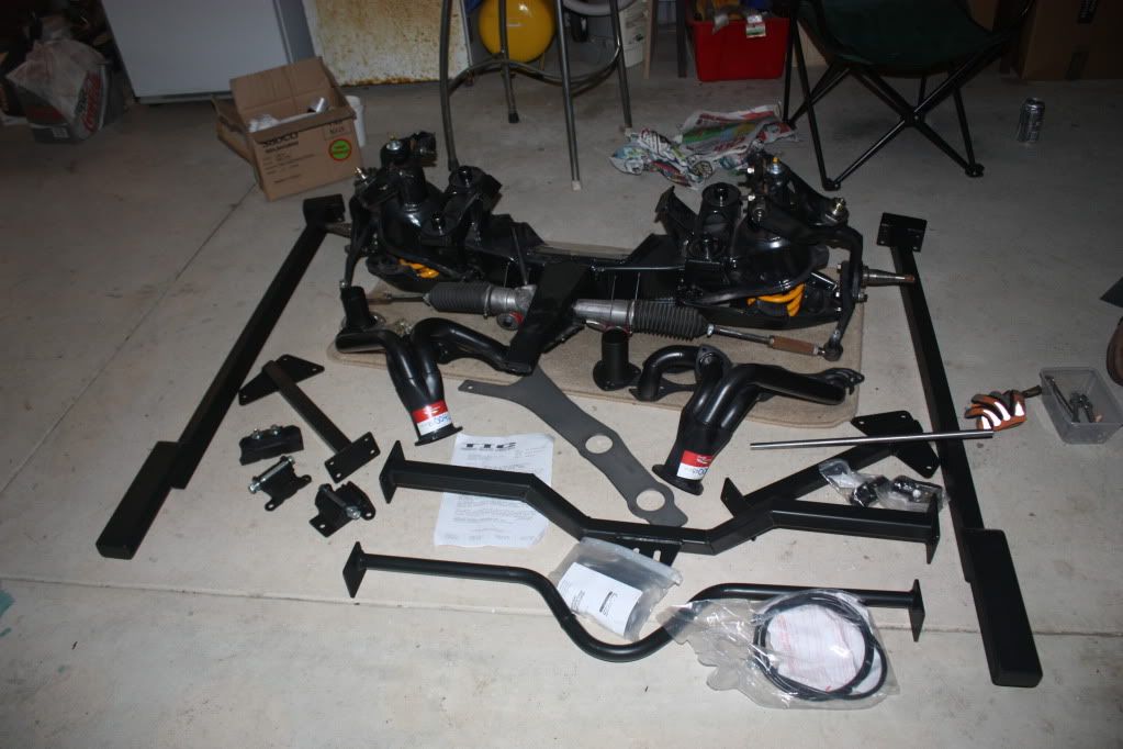

Thanks for all the pics they are a great help, I just got home Thursday night 2 x 2 rota all my parts have now arrived (see pics) I will get stuck into it next week as my beloved Saints are playing g today and I will be out of action for the next few days
Hope to have the front end to the sand blasters before I go back
I am on the lookout for a small block as a dummy bock possible later rebuild for a 2 door HQ,
Gasman
I would love to come and have a look Bunbury is always a good run from here I will send a PM with some contacts
Gasman

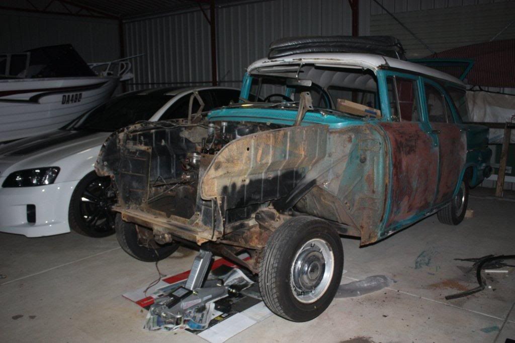

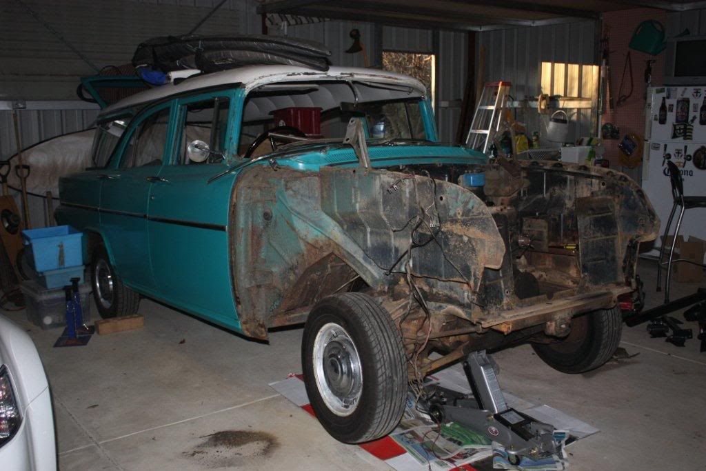

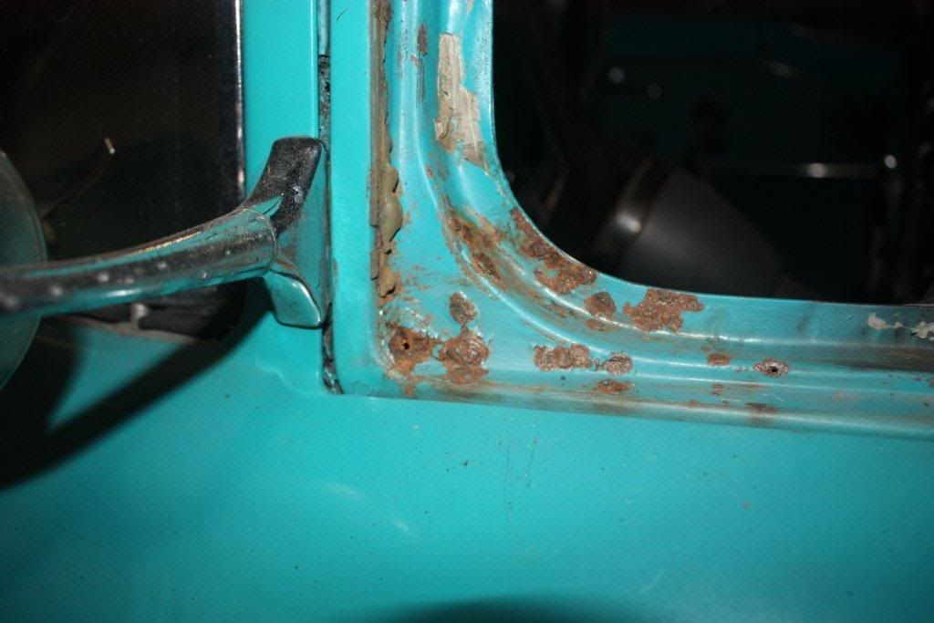

Finally got some shed time this morning, hope to get the motor out tomorrow and the get the front end to the blasters. A few hidden bolts on the guards kept me amused for a while.
The car is in very good nick for its age very little rust. A few spots in the typical areas. Both gauds are complexly rust free.

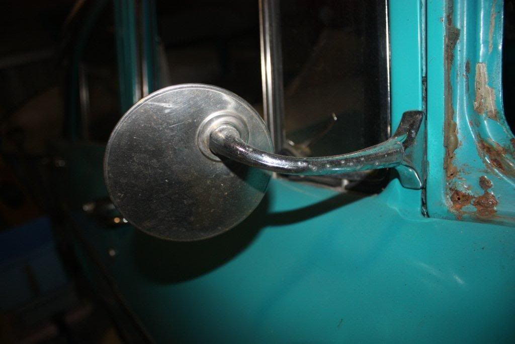

Cool Nasco mirror
Gazza
Cool Nasco mirror
