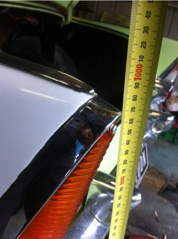

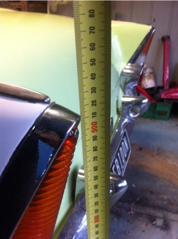

Just did my FB sedan using Trevor's flipping method. Took two inches out of the back. Originally, the front only was lowered, (The look from the 80's). Always thought the downhill rake looked a bit naff, even back then, let alone now, and on my car. Now the tip of the fin is almost exactly the same height as the tip of the headlight eyebrow. (900mm). A spirit level along the sill bottom has the bubble inside the lines.
My springs were a bit different to Trev's, being a sedan. I only have four leaves. and the second-bottom has the metal straps surrounding the larger two above. The bottom one was removed and placed inverted at the top. All done in-situ, just the diff housing jacked up out of the way.
Much happier, but I'm afraid I won't be getting the downhill fuel economy anymore
