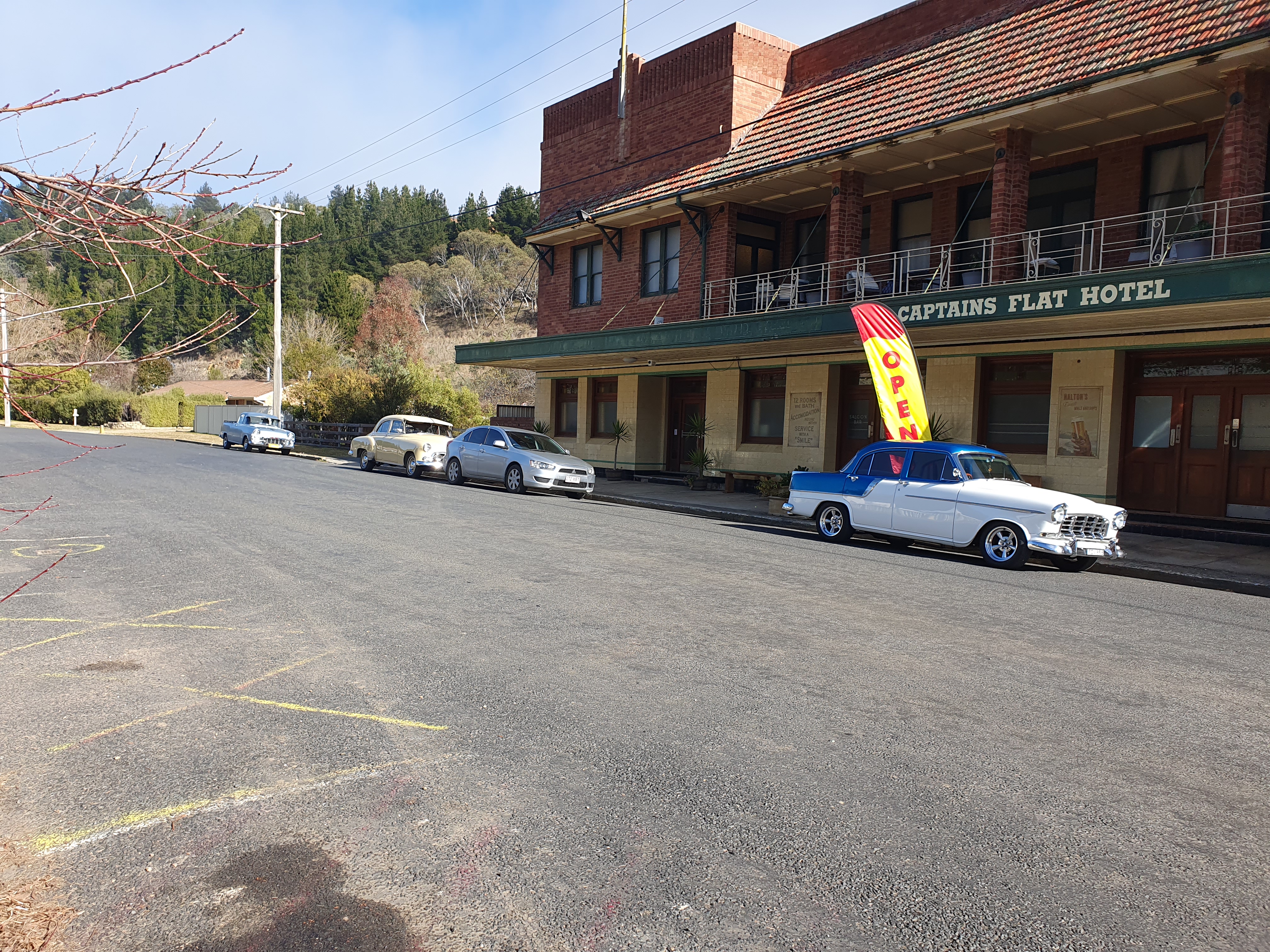

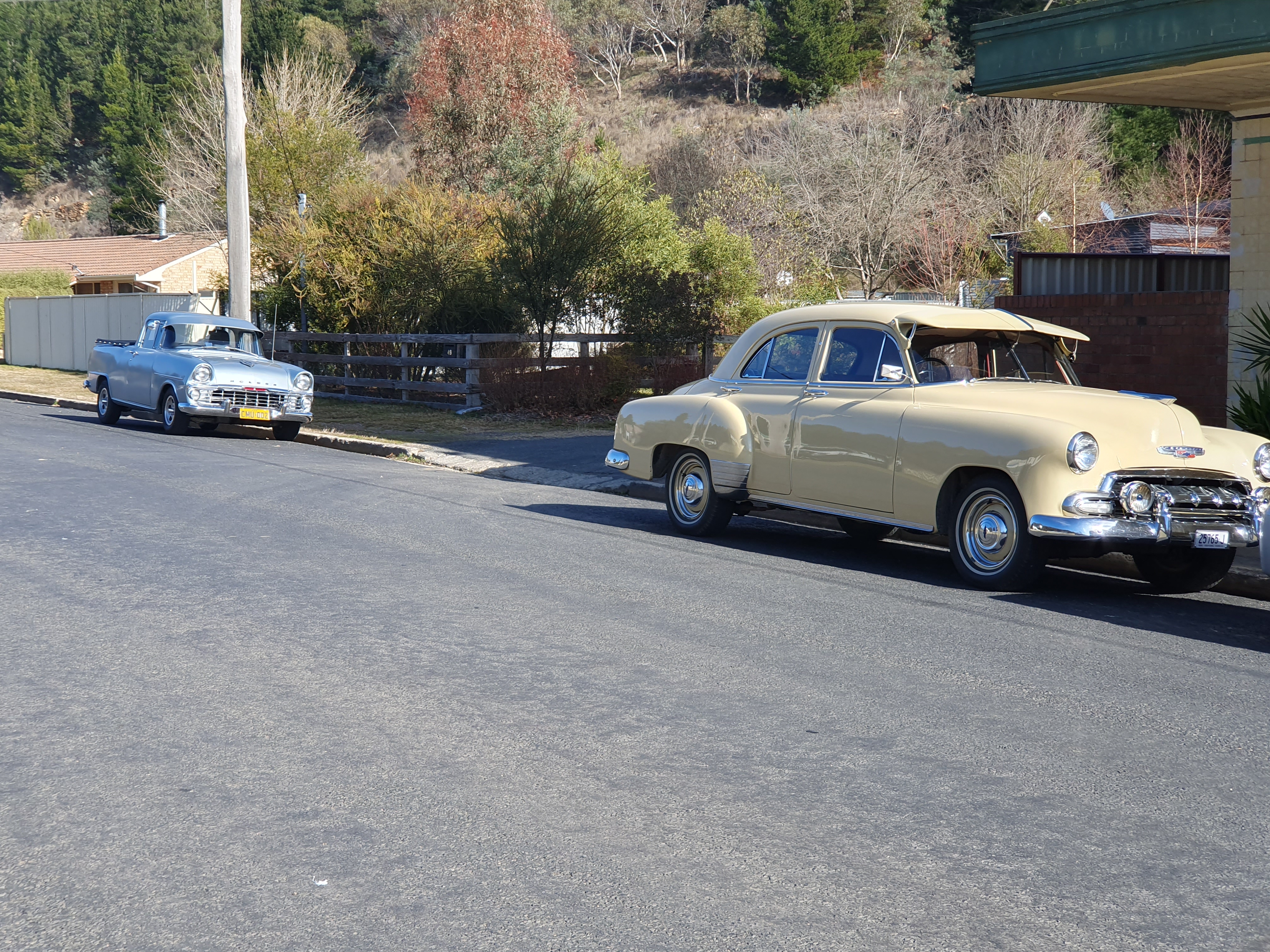

Out and about with my neigbours today. A mini GM run to Captains Flat and back. Ute went well. Poor photos - sorry.
- 20240714_104042.jpg (5.51 MiB) Viewed 7248 times
- 20240714_104228.jpg (2.58 MiB) Viewed 7248 times
- 20240714_104124.jpg (4.32 MiB) Viewed 7248 times
