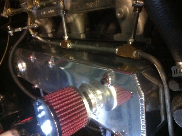

Been slowly plugging away at the old girl
Had to change the rocker cover to clear rockers:( (from bocam 5342 9861 not ebay)
And bought her some new red socks today

What size su carbs are they and did they fit without modification to the firewall?
I'm using su carbs in the chopped wagon.
Sent from my D5303 using Tapatalk
Re: My EK project
Posted: Thu Jun 23, 2016 6:55 pm
by Mick Jagger
1 3/4"
,no mods to wall ,engine quite close to radiator ,no fan,redline manifold
ill race ya :D
only problem standard fuel pump puts out a bit too much pressure for the old pommy carbs
mine piss out fuel at start up from overflow(only run once a month)dry/stuffed needles?
i think they run at 3 psi and standard holden pump at 7-9?
maybe need a pressure regulator?
or new seats/needles :thumbsup:
or new seats/needles Image
your wagons nearly as cool as my car lol
Hahaha nearly.
I've heard a feel reg is a must.
Re: My EK project
Posted: Thu Jun 23, 2016 9:01 pm
by Devilrod
Fuel reg is the way to go. A lot of old carbs don't like more than 3psi. Whatever you do don't get the round dial type. They fail a lot! Holley do a low and high pressure reg and they are rebuildable. I've got a low pressure one for my roadster and it's been really good so far. As opposed to the three dial types I've had on it.....

SUs are happy to run on 1½-3½ psi, and overflow around 5 psi. The factory early Holden (grey/red glass bowl) pumps punch out 4½ psi, so can be marginal. One way around the flooding is to use a later Holden (blue motor) steel can type pump. These are rated a bit lower (3.9 psi). Could equally be that the needle tips are a bit manky, or that the Viton is chewed out.
Anecdotally, Stromberg carburettors operate on approximately 2½-4½ psi of fuel inlet pressure from the factory Holden pumps. My bench tests show they begin to pass at 7psi, though if you could miraculously hold them free from vibration, you can get 15psi out of the needle and seat. Holley carburettors are slightly less susceptible, and run happily at 5-7psi.

I have had to muck around a lot with my SU's - was having the same problem - changed the fuel pump to a later one like Harv mentioned above but still had to put a fuel pressure regulator on it to make them happy

cheers will look into a reg,would hate for the old girl to burst into flames now
