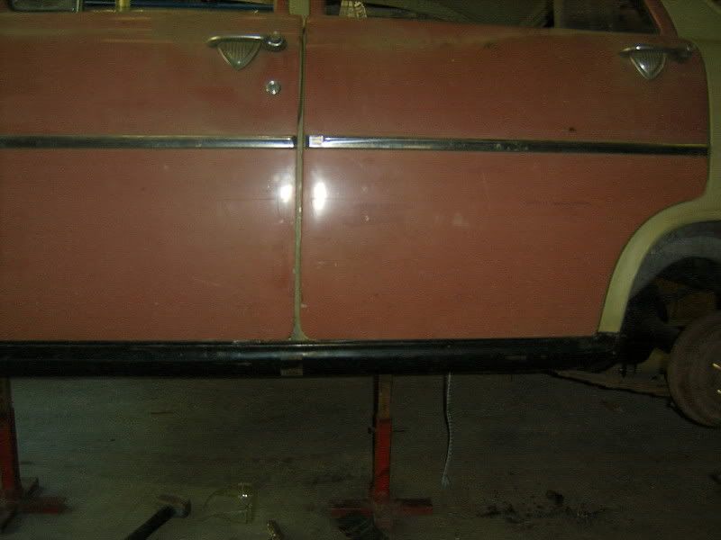

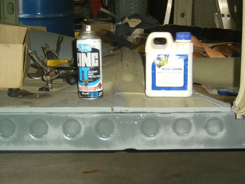

Cleaned the inner sill in prep for painting
I used POR 15 metal ready to start with cause it kills any rust and leaves the metal with a slight bluish tinge of zink sulphate, just the thing when spraying zinc cold gal. The electrical industry uses the cold gal for painting earth rods and lasts in the open forever.
Put all the panels back on lined everything up (took me all day) and the sill is ready for its final welding. Hopefully during the week
And yes its been a long time since I drove the old girl in anger. I am really chompin at the bit but still I have a long way to go!! :cry: :cry: :cry:

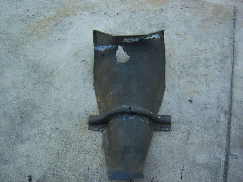

Back again guys,
Mal door gaps will be the usual extend unless I can think of something else.

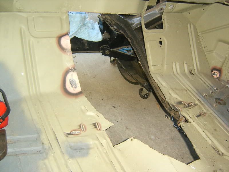

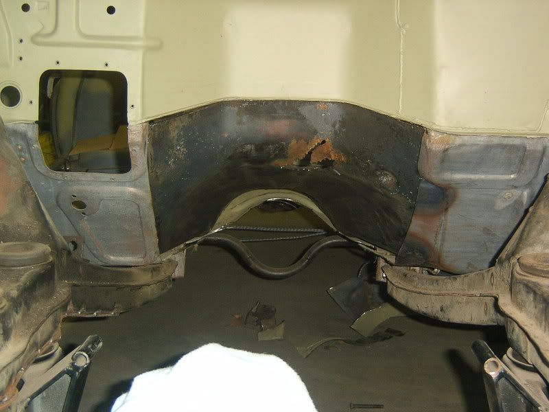

Sill is now complete so I've moved on to the tunnel.

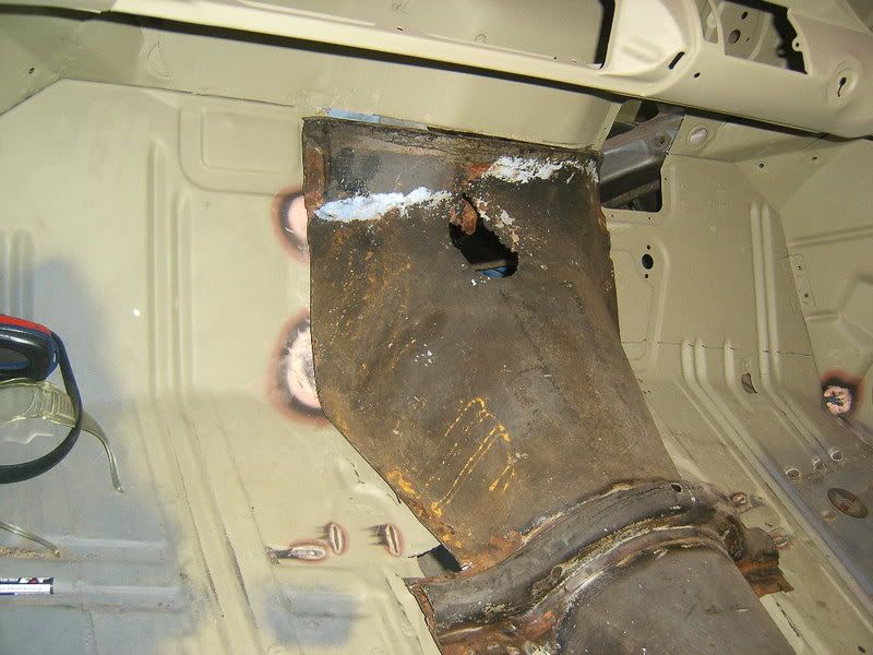

Originally I was going to use a Hadfield tunnel but dont like the look of the front piece. The auto tunnel is much wider although a little more dificult to put in.
Donor tunnel
Hole cut roughly
Trial fit

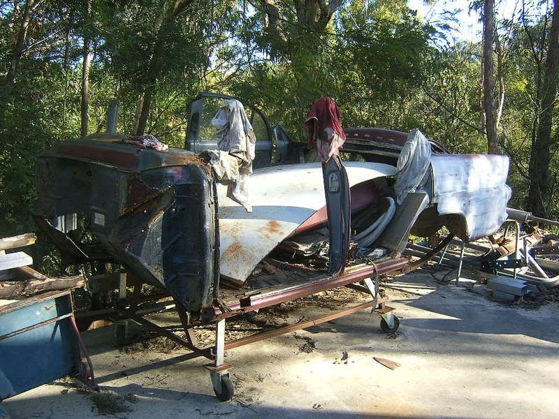

Whats left of the donor car.
Anyway progress is slow but steady, will do more over the weekend.
keep on going with it Greg. Lookin good. Don't think too far ahead of what you have to do...think of what you've done...that's what I do anyway...and I'm still a long way off as well...
Hey that sedan in the last pic might be a restorer for someone? :lol: convertible maybe?...thanks again for the petrol tank surround and other steel bits... :)
