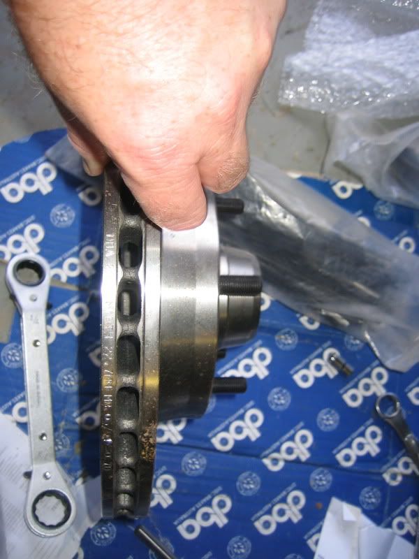

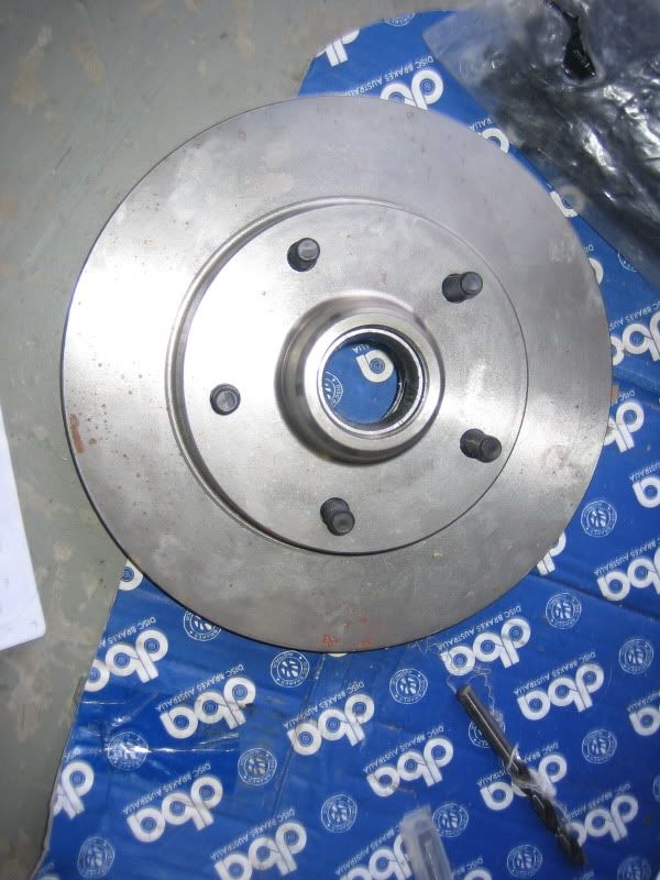

The P76 rotors you can buy new from Hoppers Stoppers in the HQ stud pattern, they are ventilated as seen in below photos. you can also get them in slotted.

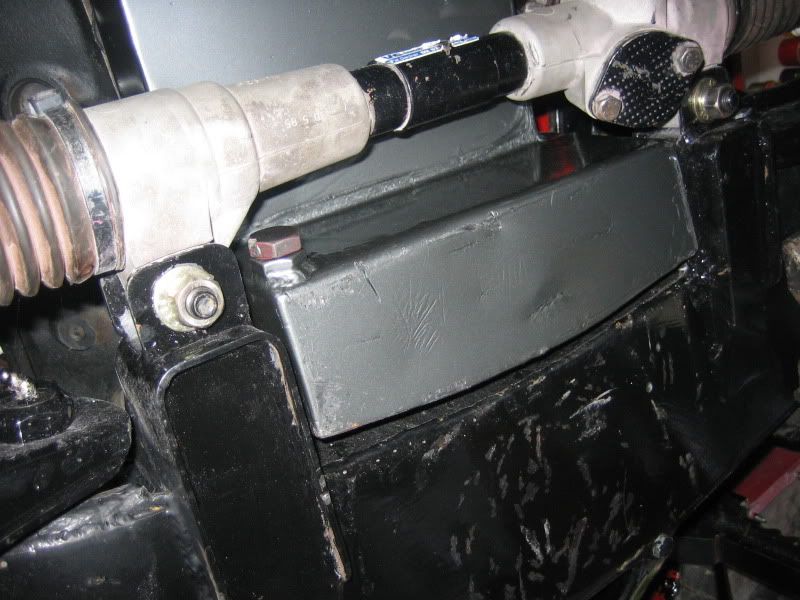

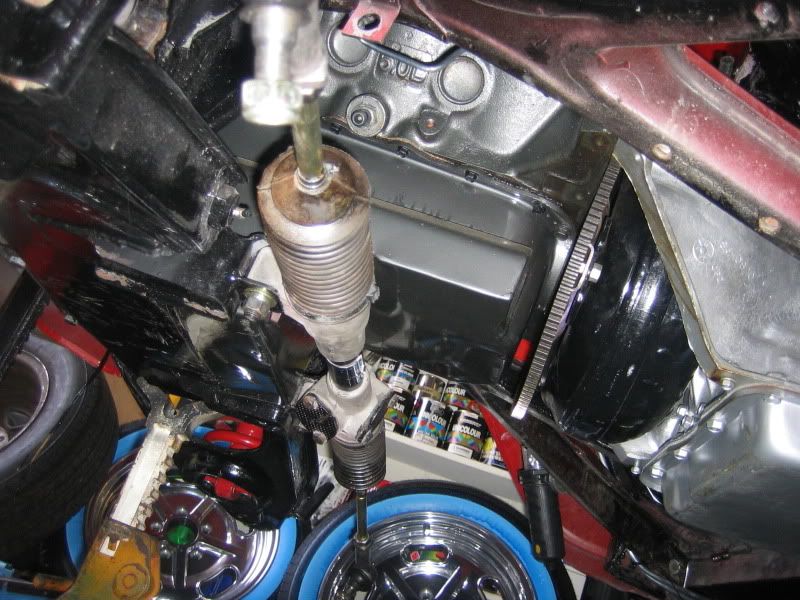

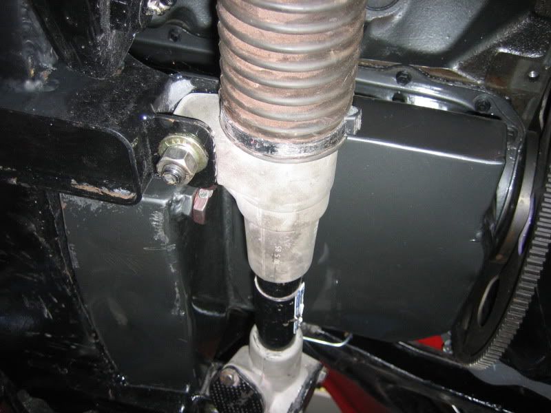

Below are the photos of the sump as promised.

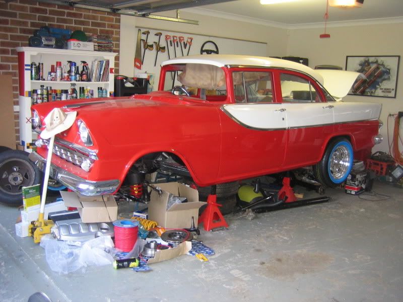

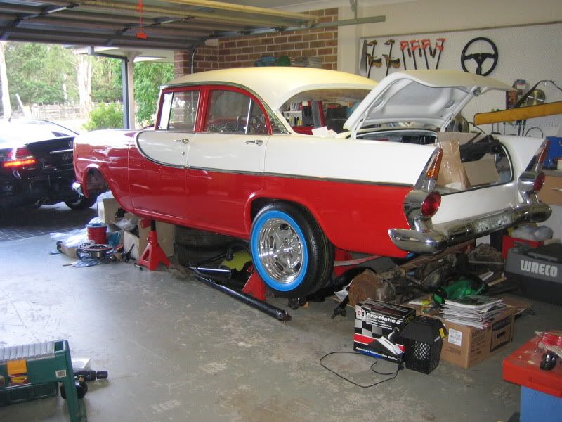

What's with the 'blue walls', Scoobb??
Is it some kind of protective layer over the white? I've never bought white walled tyres before ..so don't think I'm thick! :oops: :lol:
Scotty.
PS...nice job on the sump! :wink: 8)

Re: Helenor
The sump looks to be a snug fit (is it just the pic's?)
Scotty, your rite the white walls come with a protective coating.
SC00BB2

Yep sump is a snug fit but engineer has already looked at it and doesn't have a problem with it. :D
Scotty that is the protective coating on the tyres, they just wash off when you are ready to run them, should look good once the blue is off... :wink:

Yes the motor was a bitch to get in, had to lower the subframe so the motor could drop into it without the rack on and then raise everything back up and put the rack on. :roll:
