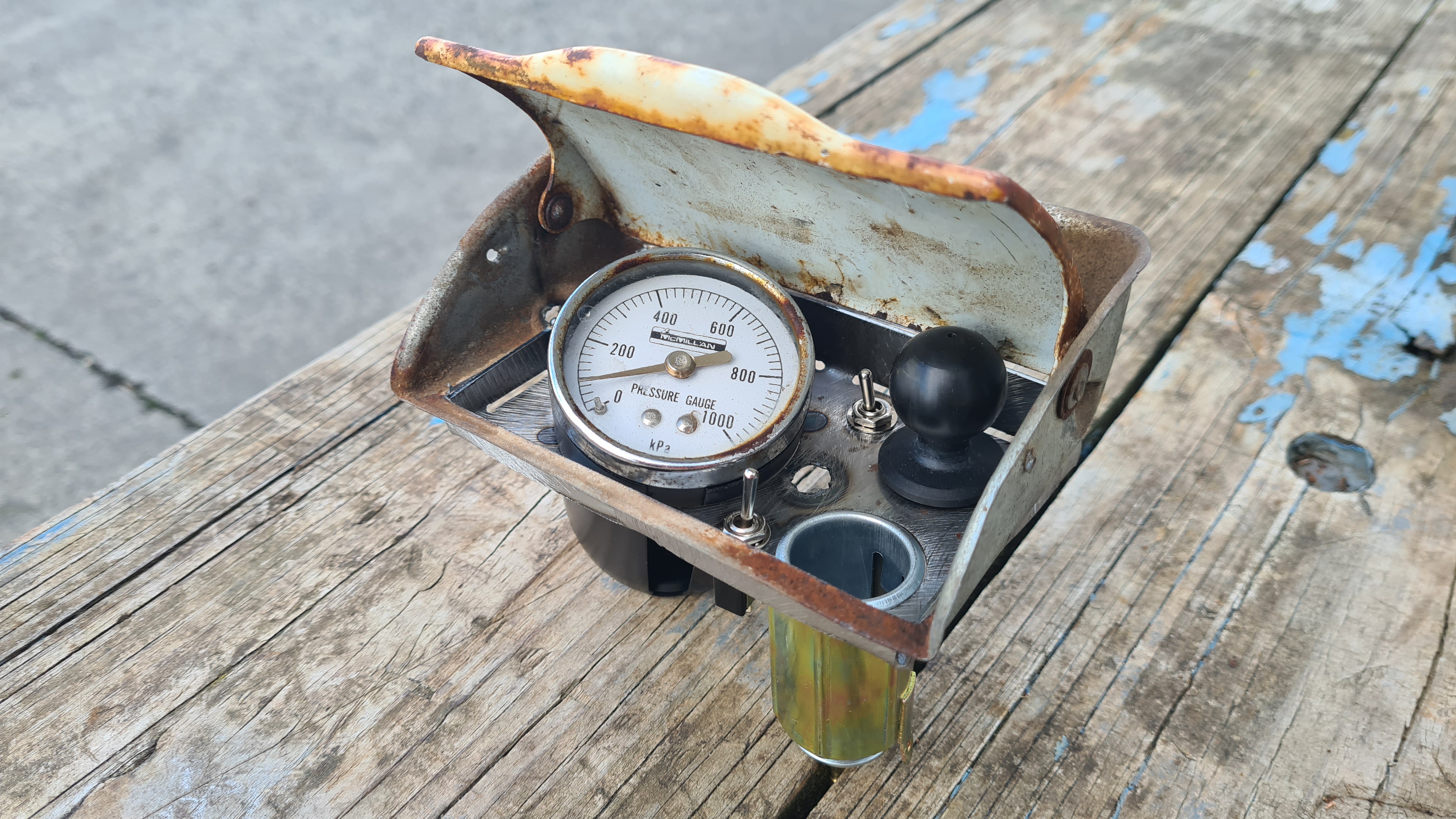

Brett027 wrote: Thu Jul 06, 2023 8:26 am New world problem I know, but any recomendations for a phone holder for EK dashboards? Need one for Barney.
Gidday Brett, I have mocked up a prototype ash tray. Somehow found room for a Gauge, USB outlet and a Quadlock ball mount. I had to cut the guts out of it and lower the base to get it all to fit and the lid to close. If you just wanted the ball mount for the phone holder I reckon you could mount that into the ashtray bucket and not have to modify the ashtray body. I also found a flush mounted USB ciggy outlet that ends up flush with the top of the ciggy socket so you can leave it in all the time and still shut the lid. Once you have the ball mount in you can get a ball mount extension arm with Quadlock phone holder on the end. The extension arm just pops off if you want shut the lid and obviously you will need a Quadlock case for your phone.

Thanks for the pics and idea Mick. My ashtray has 2 x usb ports and a 12 volt socket fitted which fills it up already, but good lateral thinking. I remember having trouble just getting those 2 fittings of mine sorted so as to be able to fit the ashtray module back in the dash hole: All the stuff you have going on in yours must have made it tricky.
I must admit I am also looking at a few modest sized touchscreens as an option, but will try non-permanent mobile mount first.
