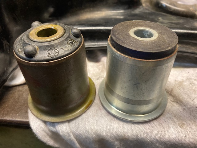

Next thing, I was hoping to use rubber bushes in the lower control arms now that i am ridding the offset bushes, yeah right !
I don't normally bag companies but Mackay rubber bushes don't fit, the shells into the control arms are as loose as a Kings Cross local Sunday lunch time !!!!!!
Back to the whiteline, the comparison in the shells is amazing, they fit nice and tight like there supposed to. You can probably sence the excitement I have in relation to product control right now.
Pressing bushes.jpg (91.03 KiB) Viewed 1502 times
Really bugs me how this world is going, not just from the frustation but the waste as well, those Mackay bushes are usless and will just go into the bin. Id'e throw them at the pimply sales guy, but its not his fault its the overseas manufacturing and the lack of quarrrrrity control ( did i say that right ) !!

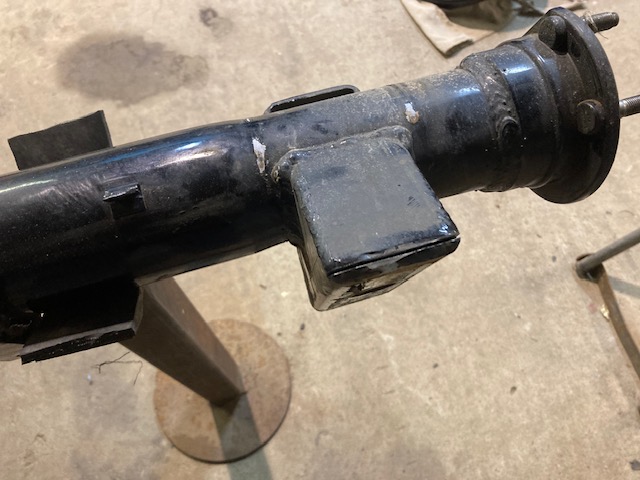

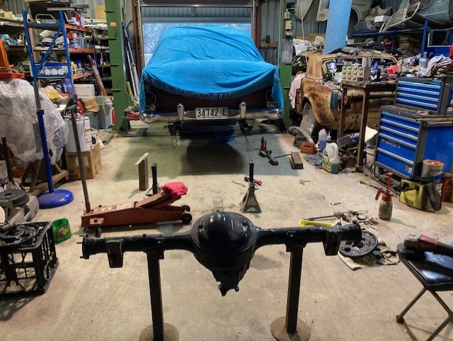

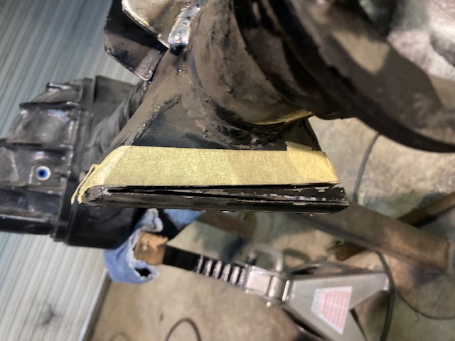

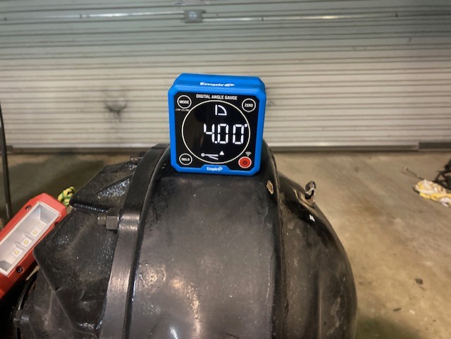

So in my last post I mentioned that the car has developed the dreaded driveline vibration. Although not bad, enough to warrant some investigation.
Underneath I discovered that the pinion angle was a whopping 6 degrees out from the gearbox !! I didn't feel a thing when i had the 2.73 gears in but the 3.55 ratio has sped the tailshaft up to about 2000 rpm and thats been enough to give me the helicopter drone.
Now you would think I would have checked but no i did not, left it to the diff builder and his measurements were fine but not for an EK.
Why did this change ? When i initially started i had flipped eye springs but the engineer said to low so i went back to the normal eye on top.
Because i rushed the finish for the car 3 years ago I never got around to measuring the angle and i had no issue with the tall diff ! (very surprising with the final measurements).
Ok no choice so out it come !
Now the springs i have in the car are standard height but not reset, it rides great but the springs are nearly flat. This flatness brings the spring perch area to 7.7 degrees, my diff was set up for 0 degreees, being normal height for most cars and the diff was pointing down 3.7 degrees. The math is normal spring perch of 0 degrees would have had the pinion at 4 degrees up, close to the transmission and tailshaft degree, tops but not with my situation, being sagged lowered springs (Which i like).
I can't believe how dirty the underneath is, but i built it to drive and drive i have been, pouring rain for nearly 2 weeks over the nationals period and 2000kms through all sorts of roads up north.

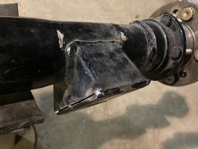

Anyway More math and my solution is to chop out a 15mm high wedge from the saddles, and tilt the diff back to get the correct 4 degree rise in the pinion, basically 6 degrees movement.

I also took the oportunity to move the bump stop brackets lower for just that little extra movement.
Welding back together tomorrow, clean and paint where i need to then back in. I have decided no more last minute work before the nationals, hopefully I can cruise around all year before Victor Harbor and be relaxed !!!
