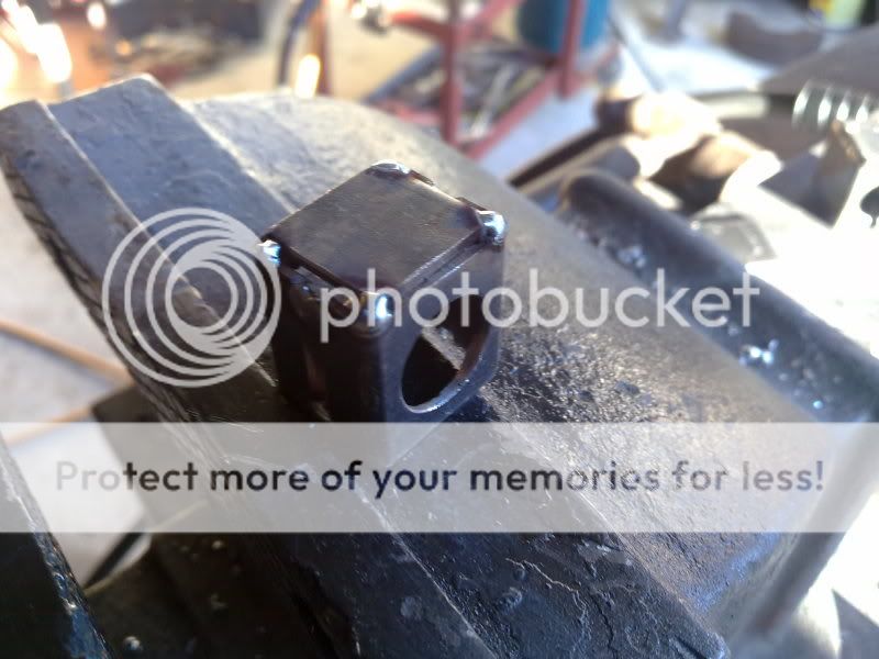

Knocked up some brackets for the handbrake cable, once these are plug welded to the floor the handbrakes finished..

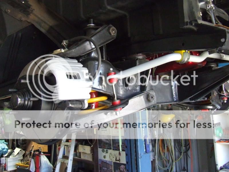

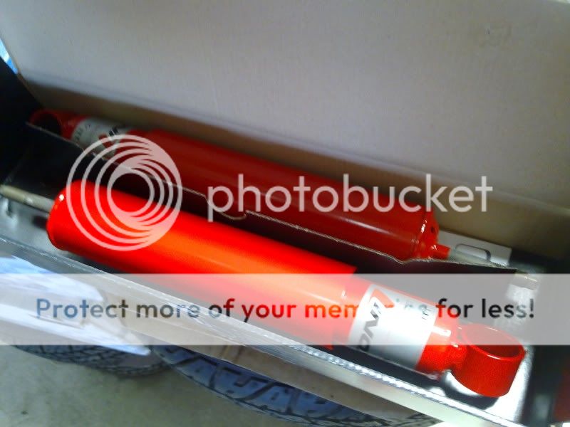

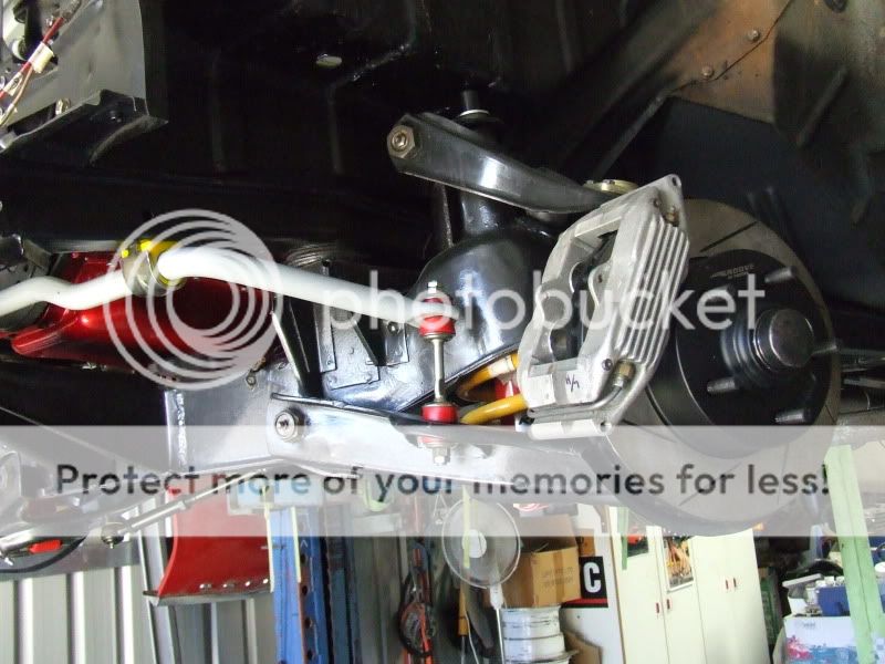

Bought some Koni adjustables and a heavy duty sway bar :)

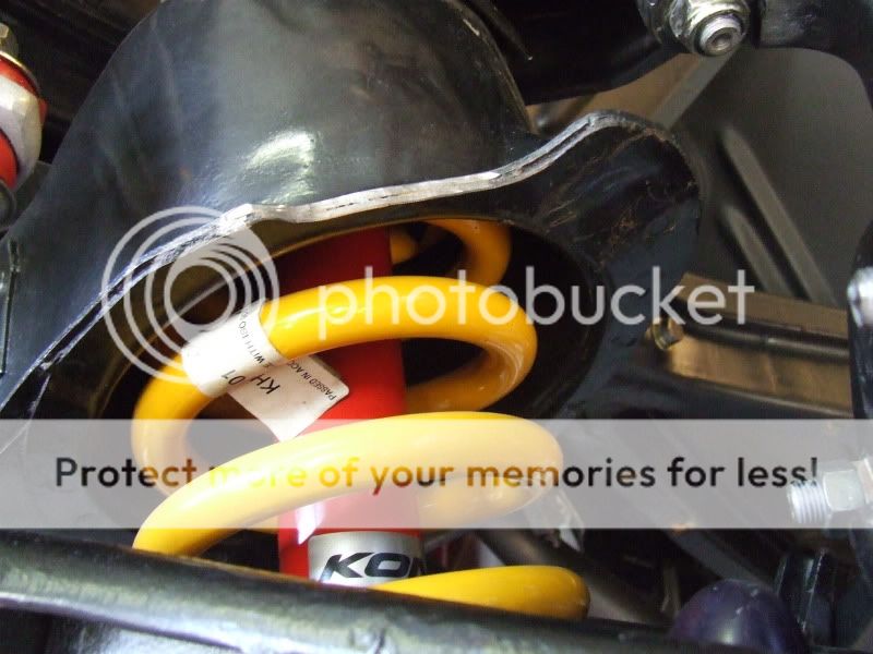

I doubt that it would ever hit but when the front suspension is close to full drop and your on lock the caliper fouls on the towers of the crossmember so i die ground out the lip a bit further and seam welded it just for a bit more clearance..
My dad hung the exhaust for me a while ago.. Im going to re make up a section of pipe at the back so the exhaust exits the car just under the bumper instead of hanging down a few inches and also have two 2.5" droopies hanging out side by side.
Cleaned up the wiper motor and bolted that back in
Dad also helped me put the new bottom ball joints in
Koni's are in and adjusted right up to 10 :shock: :twisted: 2" lowered kings and the big sway bar
Dads got a set of 4 piston JFZ race calipers to suit HQ stubs that he was goin to use on his FJ but thats changed and hes got no use for them anymore so once the EK's gone through rego ill pull the WB ones off and put them on :D

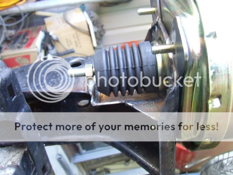

Bought a 7 inch dual diaphram booster and a 1 inch bore master cylinder
I had to modify the pedal box to mount the booster onto the firewall, i welded some plate to the sides of it so the booster was pulling on the pedal box and not just the firewall, then i tacked a washer in there so i had a pilot for the holesaw then cut that out to size
Then i reccessed a piece of old exhaust tube into it
And now she fits :)
Pedal box ready to go back in
I also welded a 6mm plate the the front of the firewall to get and even pull when you tighten the booster instead of it just pulling on the raised rib sections but i forgot to get pics.

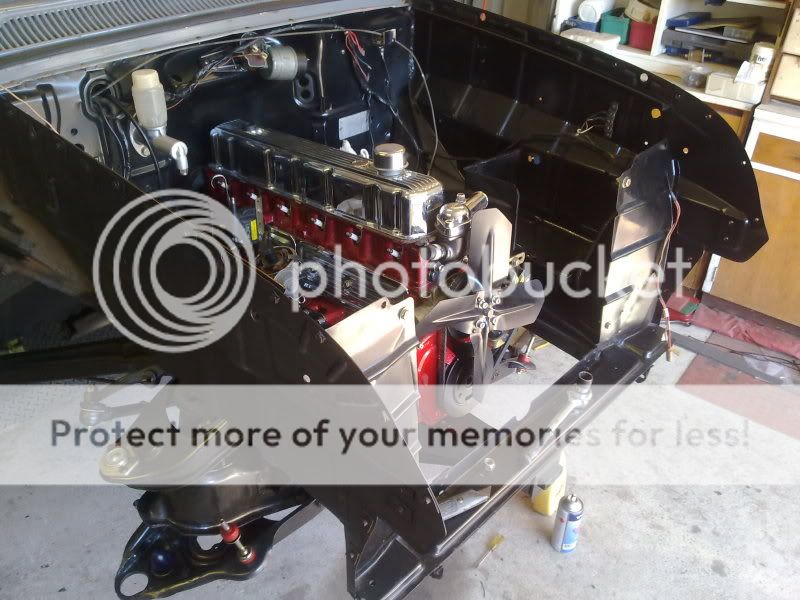

And a few pics of how it should roughly sit, please excuse the gay 17" wheels :oops: Image
