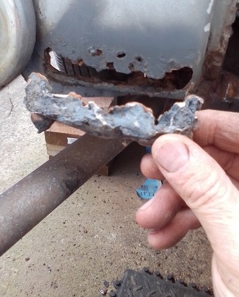

You found another standard rust spot for utes and vans Patrick. Ah, the memories. That was the only place on my ute that had bog and it still took me two plus years to fix the rust.

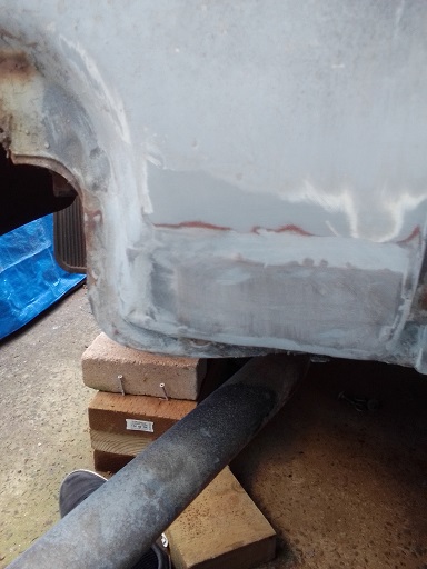

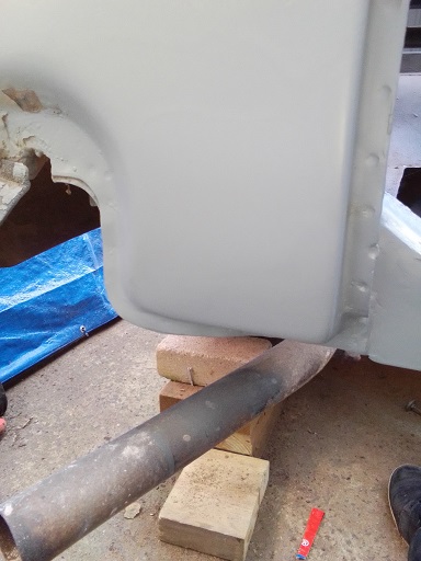

Errol62 wrote: Thu May 14, 2020 11:45 pm You found another standard rust spot for utes and vans Patrick. Ah, the memories. That was the only place on my ute that had bog and it still took me two plus years to fix the rust.
yeah, could do with a drain hole ... both sides were rusty and both inner and outer needed patches welded in - anyway, that's another couple of bits sealed up before winter

Posts: 11647
Re: Gimme 5 years
There was a drain hole in the design but may not have progressed on the factory floor. A lot of unskilled labour back then and drain holes often got spot welded shut.

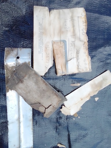

FJWALLY wrote: Mon May 04, 2020 8:17 pm what are the screws holding or are they just filling holes?
just a piece of stiff material to block off the hole
had a bit more of a look at the 'patch' today, the two screws were holding:
a strip of aluminium,
a piece of sandpaper, and
a folded envelope

Posts: 14249
Re: Gimme 5 years
yep, thats how you do it .......... :roll: :roll:
Posts: 11647
Re: Gimme 5 years
That is nearly as curious as how the hole got there in the first place.
FJWALLY
Posts: 1833
Location: Forest Hill
Gimme 5 years
Post by FJWALLY »
Thats gold - at least he took the time to make a gasket - love finding those old bits of paper though - often tell a story all their own
