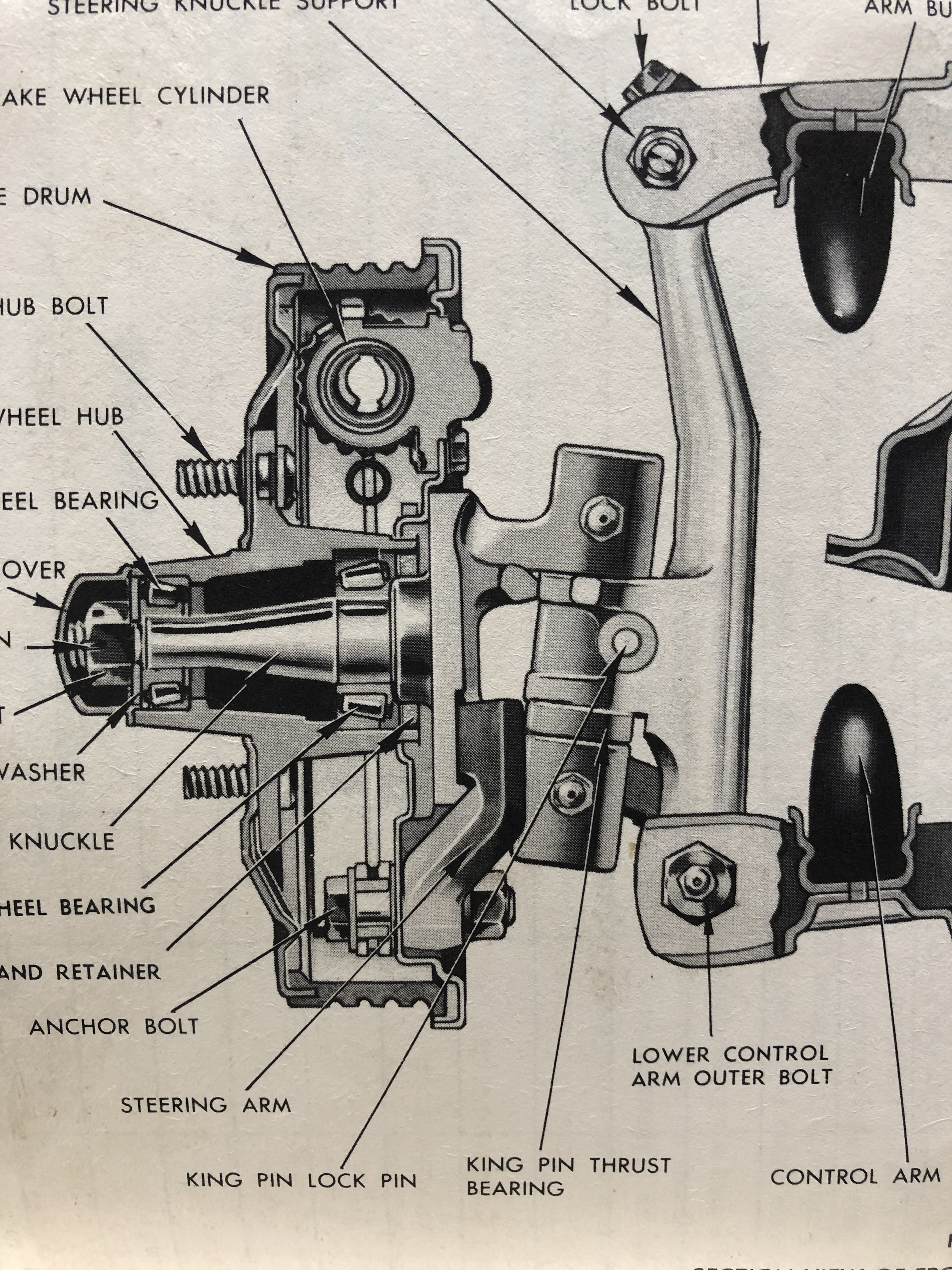

Put the disk on, and checked for clearance.

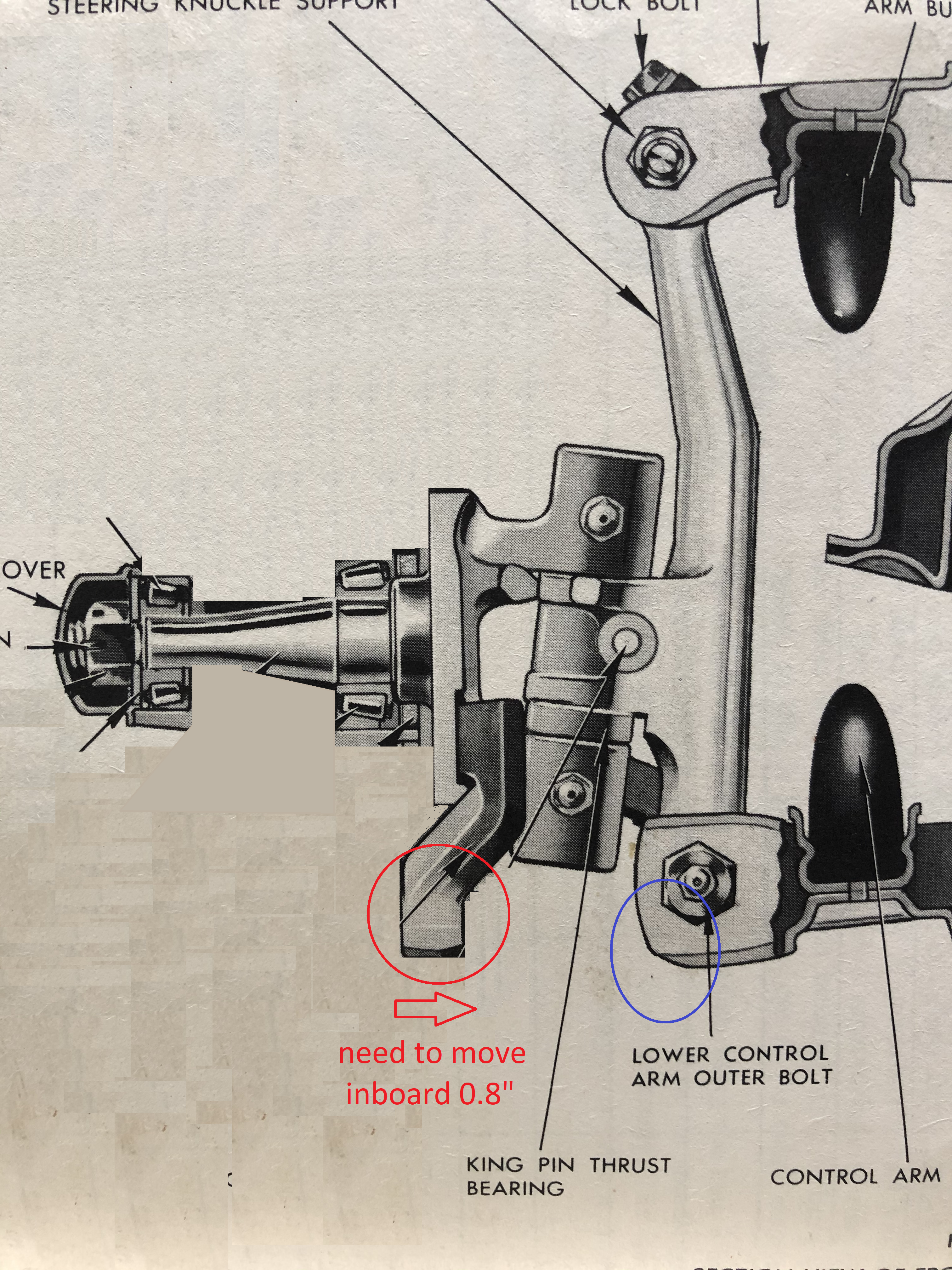

Houston, we have a problem.
The disk sits neatly on the spindle, but as it slides on it hits the steering arm. The obnoxious bit is the bottom of the steering arm, where the brake shoe pivot bolt goes. The FB arms bend outboard at this point, and hence clash with the disk. I need to move the bottom of the FB arms inboard by about 0.8", as per the red circle above. Trouble is, even at 0.4" spacing, the steering arms clash with the lower control arm (blue circle) at part lock.
Now I need an early Holden steering arm guru.
What steering arms will bolt up to FB/EK, but do not have the outboard "bend" for the brake shoe pivot bolt?

You need to find a pair of EJ-early HD steering arms.
Re: Harv's meth monster project
Posted: Sun Jan 17, 2021 9:33 pm
by ardiesse
I hope. Looking at the HD shop manual, it's not easy to tell. Holden didn't completely update the Figures in the manual when parts were revised. The Checking Dimensions chart for front suspension components suggests that in the HD steering arm, just the hole for the brake anchor bolt was deleted, and the same forging dies were used as for the earlier models. But Figure 3-10 in the HD shop manual shows a much gentler profile for the steering arm.
You'd have to get a pair of EJ-HD steering arms and compare. But Murphy is telling me that the later steering arms will only be a partial cure.

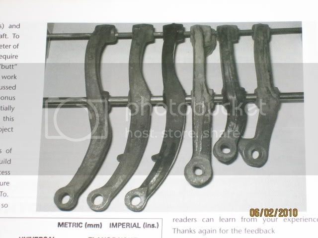

What I need is someone who has a work of art like the below, but for earlier Holdens.
Holden steering arms L to R HR HK HT-HG HQ-WB LC LH.jpg (38.71 KiB) Viewed 1094 times
