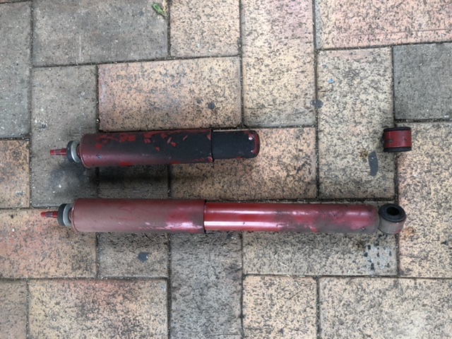

Had to replace one of the rear shocks on the FB that the engineer spotted during the recent inspection. I’m blaming the four test-pilots who learnt to drive in it 8)
I guess 10 years of towing car and box trailers, speed humps and the odd spirited roundabout may have contributed too.

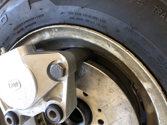

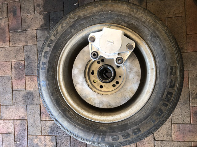

I’m keeping the kingpins, and using the CRS brackets to adapt disks. After some great conversation with Hoppers Stoppers, I’m going to try their 226mm ventilated brake kit. It uses a top hat/hub rotor and HZ calipers. I figure the HR only got 253mm solids, and the HQ was first (?) with ventilated at 276mm, so the 226mm ventilated rotors should be whopper-stoppers on the FB.
A quick check shows that the rotor and caliper (just) fits inside the Sampson Magnum 13x7s and 13x6s.
Very sexy, and could make a bloke paint the calipers red. Brembo and Willwood are jealous.
The fit is good news, as those are the rollers I want to use. No such luck with a standard FB/EK rim though... caliper clashes with the rim at the main hoop (fits inside the wider inner hoop though). Might work with some caliper grinding, but the area that clashes (pad carrier) doesn’t have much meat.
Same problem (bad clash) with the LH Torana rim I checked.
